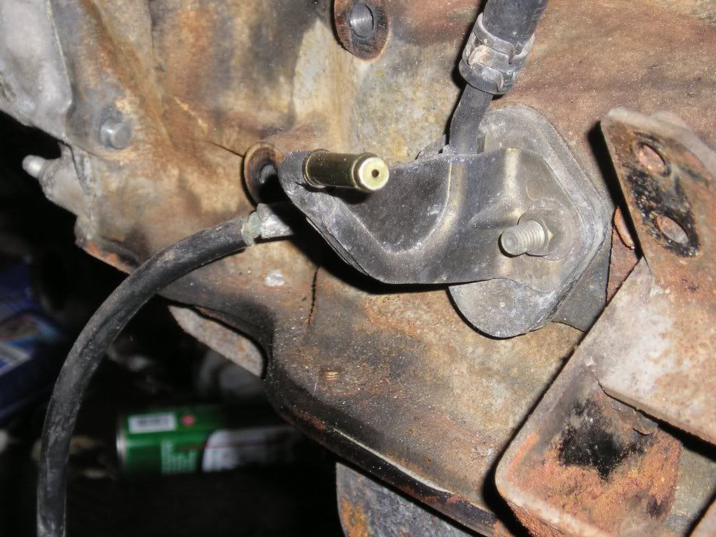

i just got rid of mine completely, as it serves no purpose whatsoever with an upgraded fuel system. :) you can do either. ;) here's a pic:
drill out that little hole, or bypass it all-together. :)

you'd build too much fuel pressure because it would restrict return flow to the tank... a wally/ any upgraded pump flows too much to force through that little hole. the FPR WILL be bleeding off alot of fuel to the return line.
