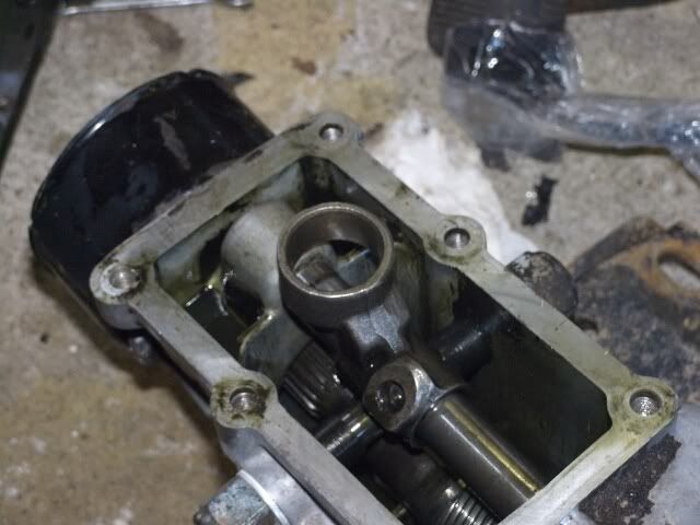

i recently pulled my box apart because shifter was starting to feel a bit loose and found a bush/bear at the very bottom of the shifter was tottaly fucked, need to replace it but don't know what its called. anyone able to help?

should be the same as R154. You need the blue part.
33505-35020 (shifter seat -- green in picture) $10.40
33548-31010 (lower shifter bushing -- blue in picture) $4.40
33555-22050 (lower rubber shift boot) $10.12
33584-22020 (shifter gasket -- red in picture) $0.83
93381-16012 (shifter bolts) $0.16 each (need 4)
