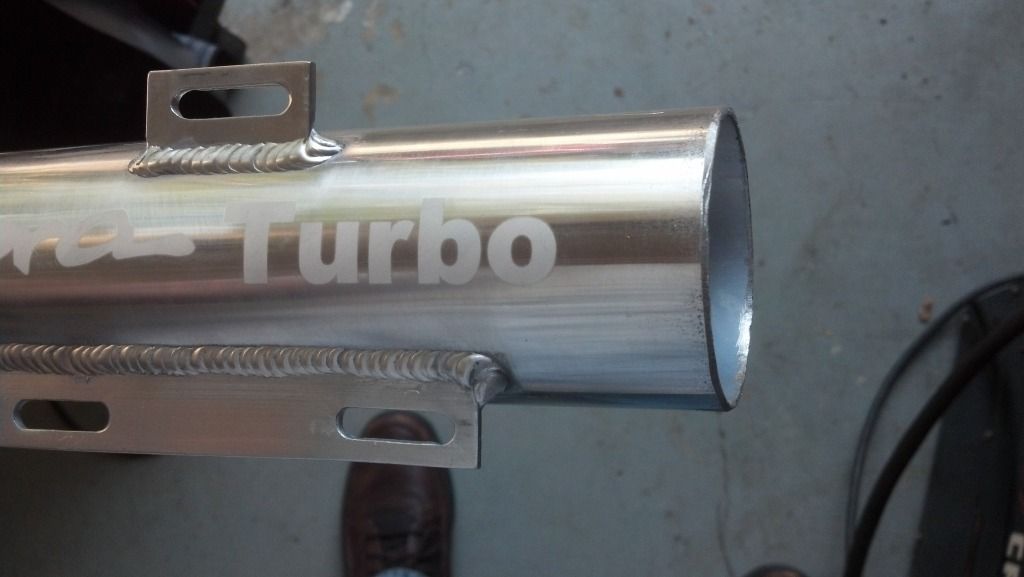

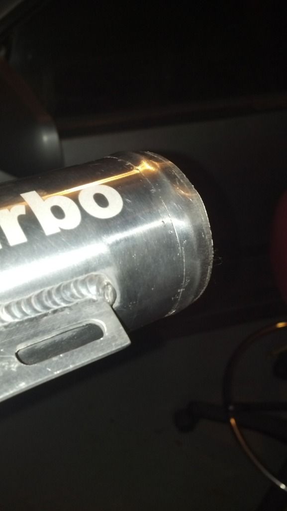

Upper pipe. Its too long, and misaligns the mounts for both crossover tubes. I just cut 1.5 inches off the side that joins the throttle body, and gave it a new bead. Also, i had to extend the lower pipe where it goes up to the compressor outlet. But that wasnt a defect; im on an aftermarket turbo and manifold that changes the location of the turbo somewhat.
supraguy@aol
Well-Known Member
Dec 30, 2005
4,236
Atlanta
Where i made the cut.
Where i made a new bead.
Where i extended. You can see at the top left side, where metal was added.

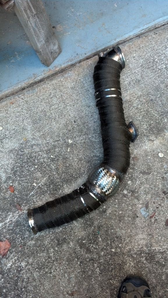

You mean flex section?
I built my dp using Ebay stainless 3.5 inch J-tube, ebay flex section, ebay Vband and ebay header wrap.
