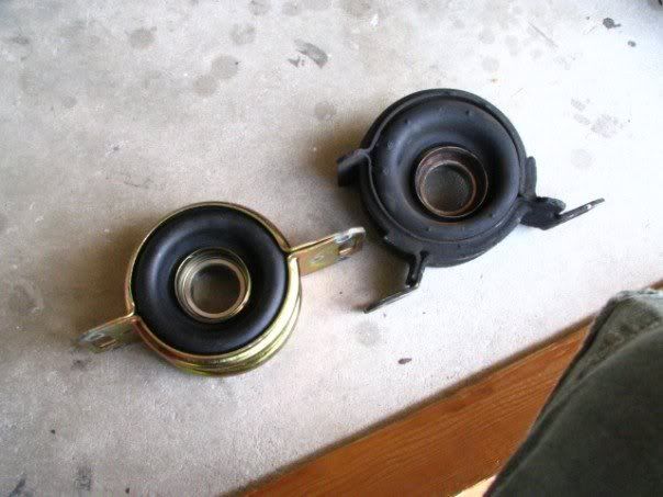

mine did it only between 75-80mph so between like 3.5k-4k RPMs and after tearing my driveshaft apart, this is what my carrier bearing looked like (new on left, old on right):
But it could be engine mounts, could be engine internals (crank unbalanced or something), could be driveshaft. Just so happens that the driveshaft is easy to check. But 5k RPM, haha you must be ridding it pretty hard :naughty:
