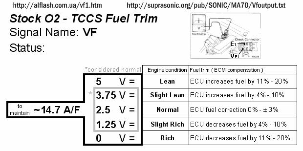

4.7v (equivalent to 5v) is not normal for operating temp idle. See:

Check it from the diagnostic port like in the pic to see if the safc is showing it correctly.
