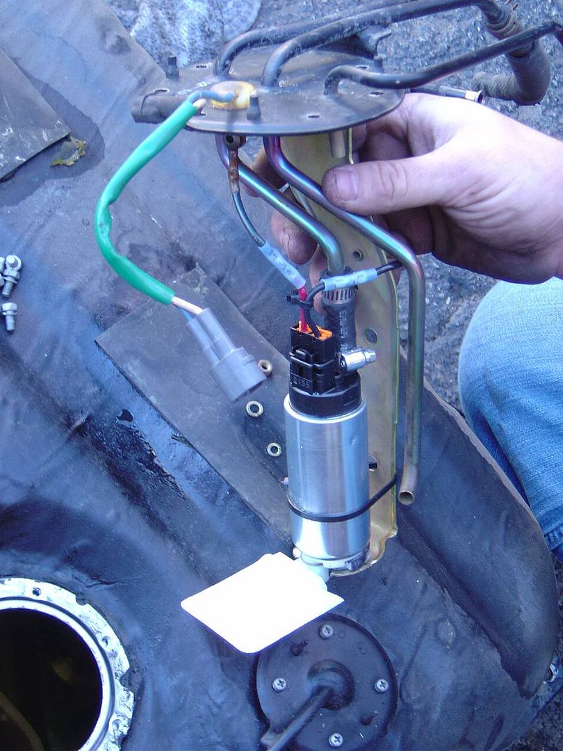

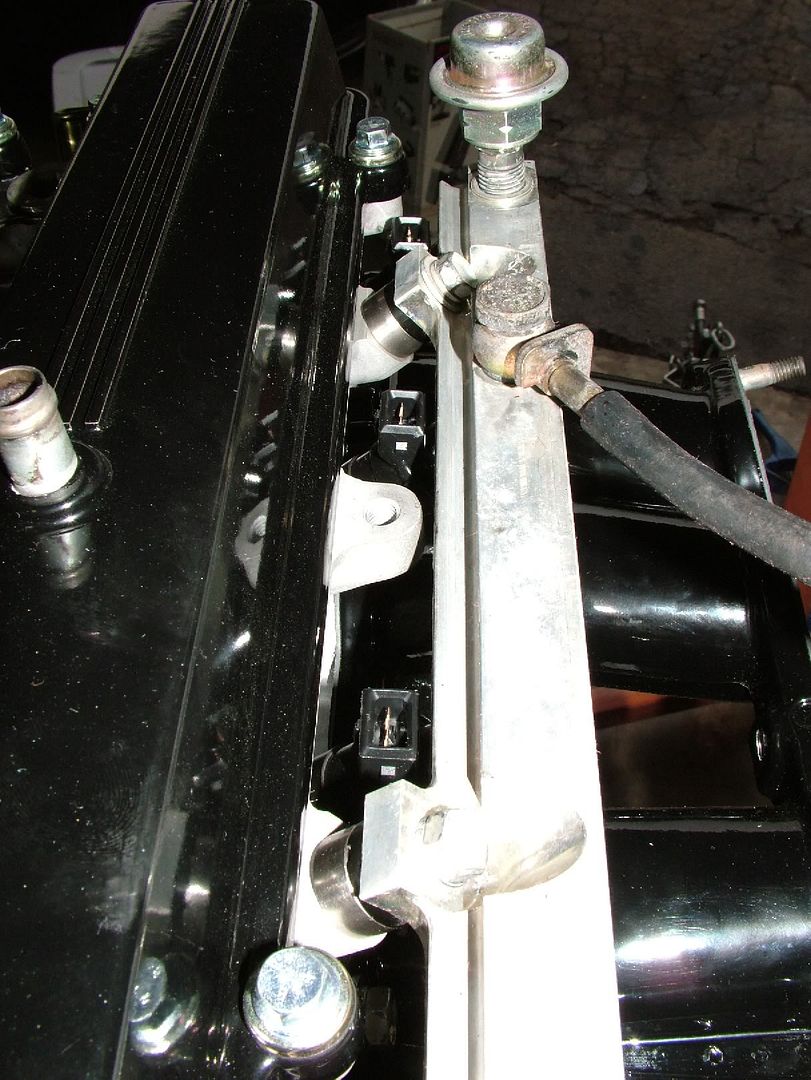

Yeah, we installed a walbro fuel pump, but the stock fpr is ok for the boost we will be running.
One thing I noticed is that the connectors can't be unplugged from the PTE injectors without loosening the fuel rail.
