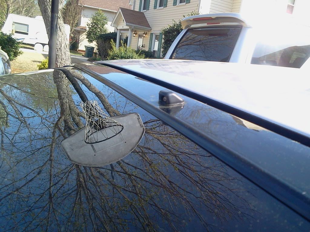

Well, today I finally got around to repacing the clips. Chip was right about the clips on the outside being the same as the inner ones. I ended up only replacing four of the clips because I didn't get the passanger side outer clip off of the moulding and didn't want to hurt the moulding trying to replace that clip, when it wasn't broke. So the only part number you need is 75039-14020. Here is how it looks now and is supposed to look.
(Sorry the pic isn't super great. My good camera broke, so this will have to do for now)
It looks much better now, and I don't have to worry about it flying off on the highway, or leaking anymore.
