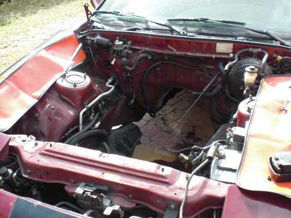

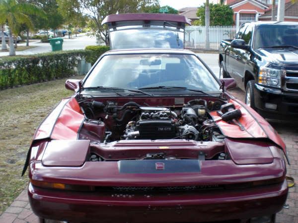

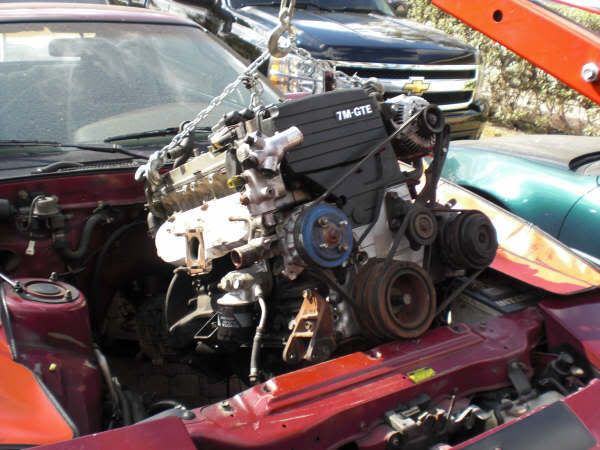

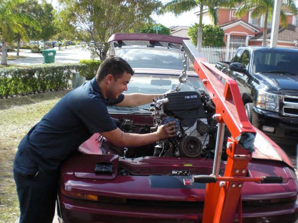

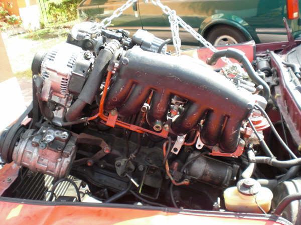

UPDATE!!!

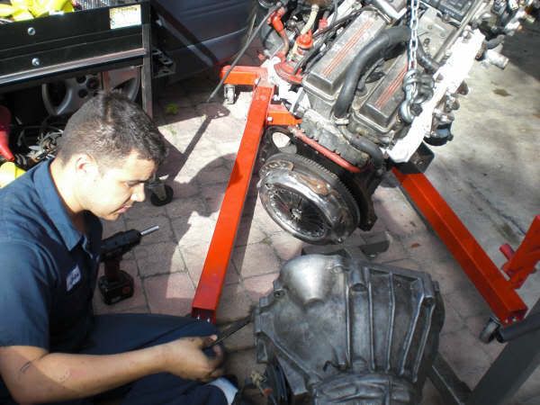

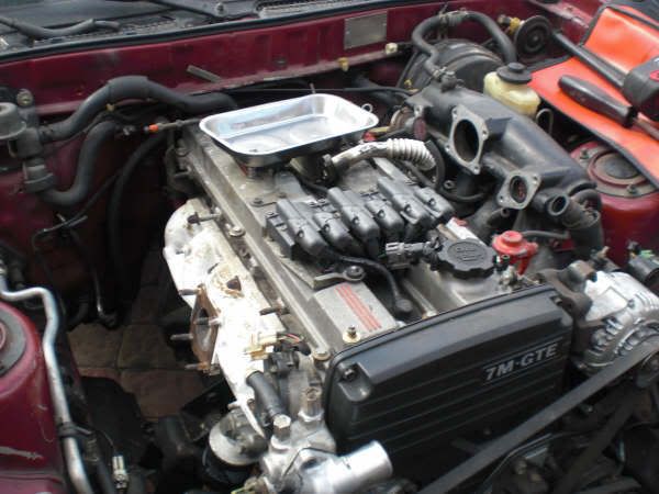

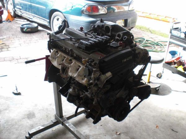

Alright, well I havent been able to take pictures of the parts yet but I will. I do have pictures of me pulling the motor and transmission out. Here you go enjoy.
And of course the victory picture. Me and the heart of the beast.
Now... I will be taking it apart and rebuilding it. When I recieve all the parts the rotating assembly will be balanced.

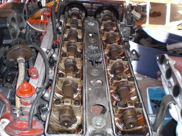

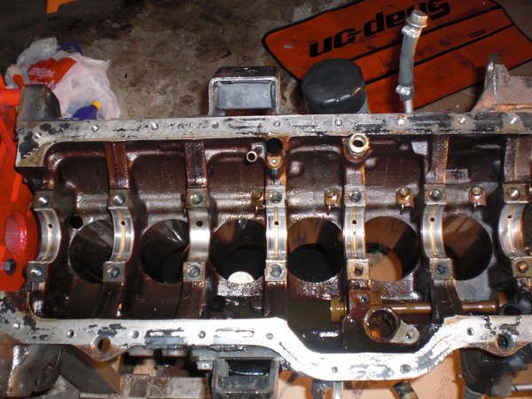

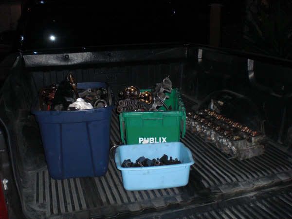

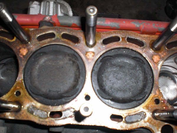

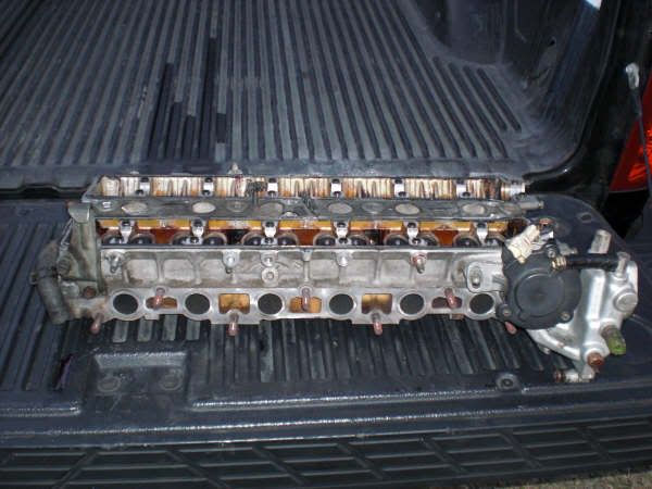

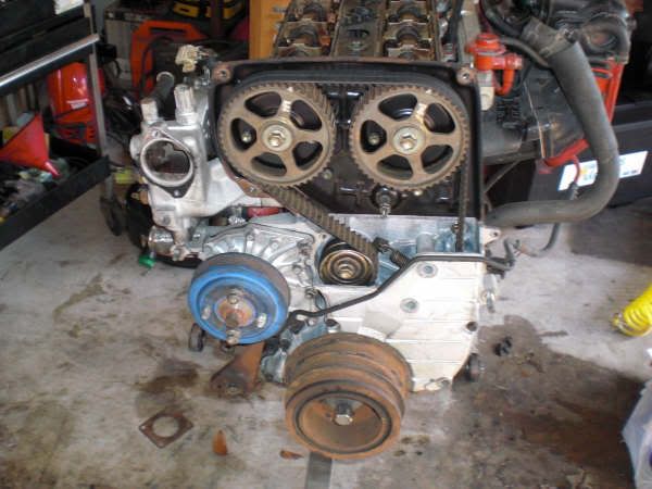

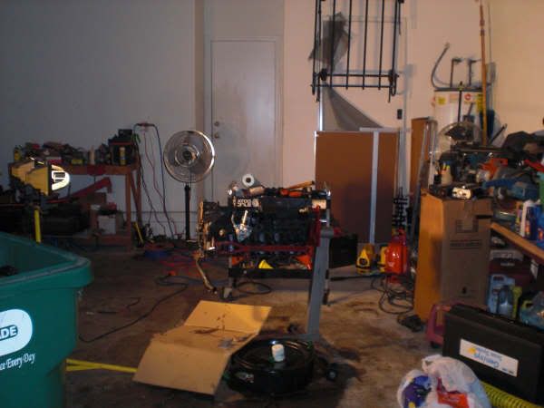

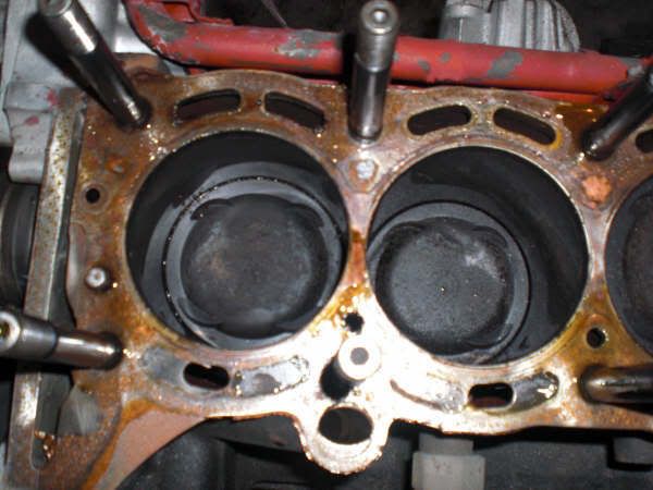

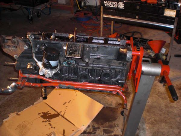

UPDATE!!!

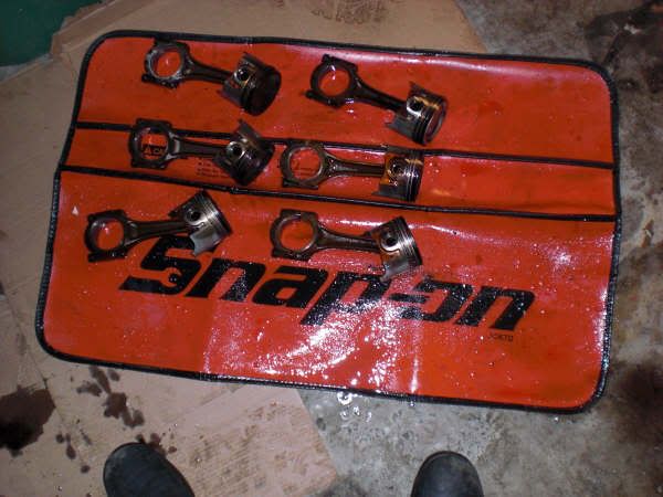

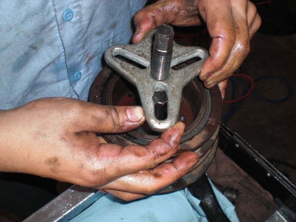

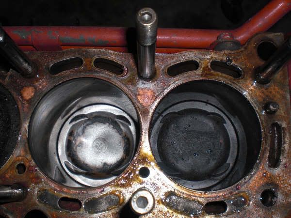

This weekend I started taking my motor apart. I took plenty of pictures. I also learned a bit about my motor. First off it was recently rebuilt. It had new gaskets everywhere. I found ARP studs but with the paper head gasket. The motor also suffered from a Blown Head gasket. I could tell because all the piston heads where carbonated with the exception of one. So I am gonna go ahead and Assume that the the head gasket was leaking coolant into that cylinder. Here are the pics....
I heard nightmares of the crankpulley bolt. Snap-on tools took it right off.

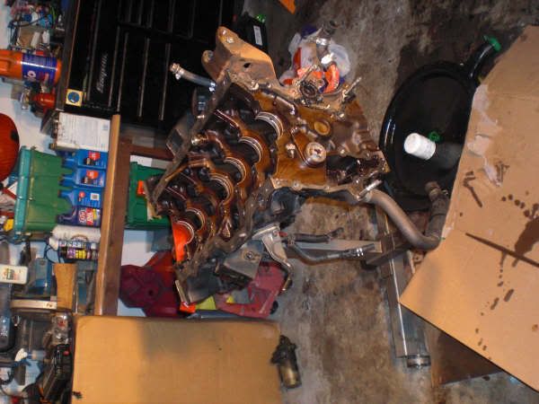

This is all the buckets of parts I had after disassembly.
This is my boys garage... This is where it all went down.
Now that I have everything apart I can sell some parts. And when My pistons and rods finally get here I will send them out with my block to get bored and balanced...
Now I just have to wait.
