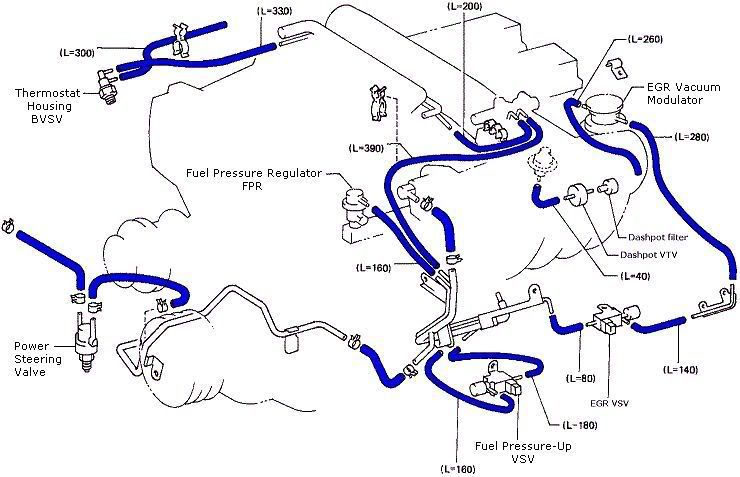

Unsure what this is for in the wiring harness.
dangthanhnguyen
Sep 20, 2012
7
CT
Finally got the 2j in and now going through some wiring. I decided to clean up the harness and re-wrap it in electrical tape and I came across this. Asked my friend what it could be he said it might be for emissions but I want to know for sure. Any help is appreciated thanks!
Suprapowaz!(2)
Apr 10, 2006
2,870
50
San Antonio, Tx.
Yeah there's two of them that sit under the 7m intake manifold. As mentioned earlier, one is for the egr, and the other for the fpr I believe.
