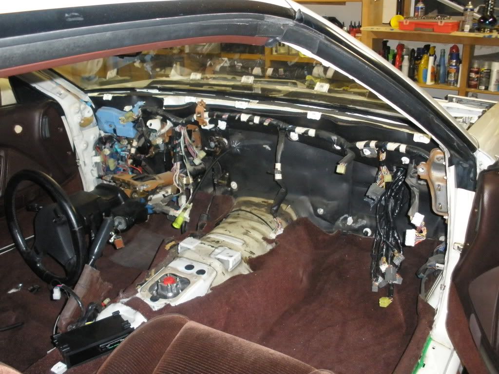

Mine looked like that as well when I removed my dash. As far as putting something in its place I wouldn't bother unless you are really doing something unusual. If your car is just sitting there I don't believe it will matter. I know it adds to the structure rigidity but its main job is to hold the dash and steering column. For mine I just wire wheeled it and painted it. Powder coating maybe over kill since you never see it, but its your dollar. For reference here is a shot of my car with it removed.
