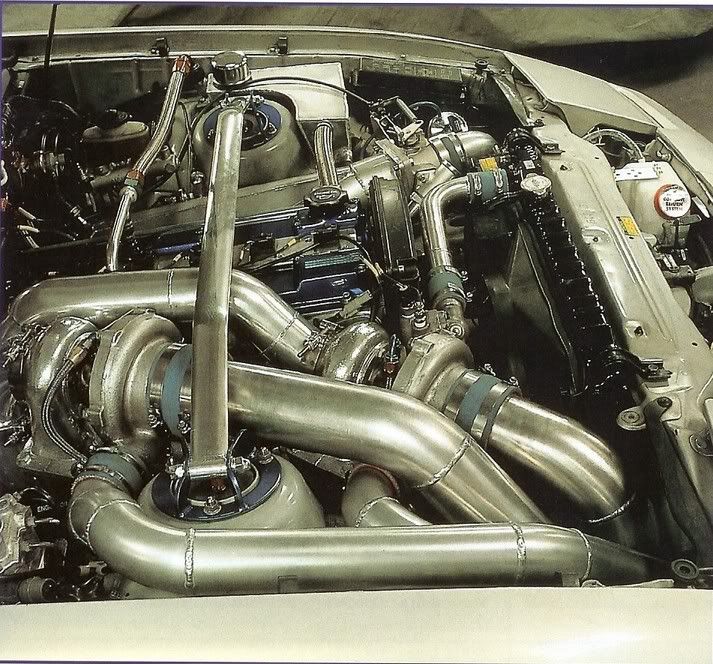

I'm not familiar with this 1ggte so some info could help. No I'm aware that the 7M only came in single turbo. Judging by that mess of metal on that picture I'll stay single. That guy tho is doing a nice job with it. Can't wait to c his car on the road.

In that pic above, is that custom made box by the driver's strut tower a reservoir for oil? It appears to connect to that large nipple on the intake cam cover, and I would think it has another hose (out of view) than seals the loop and connects to the block nipple. I think this is a cool idea if true, you'd fill the reservoir with oil, and that way you'd have more than enough oil in everything. Unless I'm mixed up on this box's purpose.

that box on the driver tower is a catch can.trace all the conectors and it will point its self out to you.
as far as a twin 7m, just go with one big single. you will be happier in the long run!

I see now, so does that hose coming out of the box connect to the intake plenum, to use it as vacuum? Where else would that hose go?

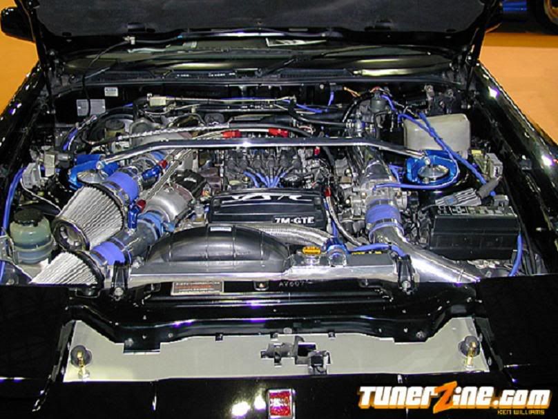

And if the photo of that crazy piped monster scared you there, here's what my engine bay will look like when I'm done, with the exception that my car is actually LHD in contrast to the RHD in this photo:

wow not bad bro. God damn that engine looks sweet. i realy want something that looks like that but i think i'll go single. After i'm done with mine i'll get another supra and make the 7m a twin. Jeeze dude your car is gunna be off the hook bro. i love those MKII's.

NJsupraA70 said:
Thats gotta be one very very hot engine bay judging by the exhaust route... would a few bux for some heat wrap kill there? plus thats just way too much shit in there
