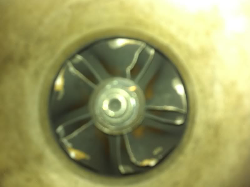

i heard the same exact sound your hearing sounds like a messed up pig, pull your intake off and stick your phone down there and take a picture bet you 10 bucks itll look like this
i sincerely hope that is not the case because this means your turbo is done. But check the shaft play when you get the afm if it has alot it most likely hit a fin or two in the turbo. My turbo looked like that due to lack of oil ruining the seals.
