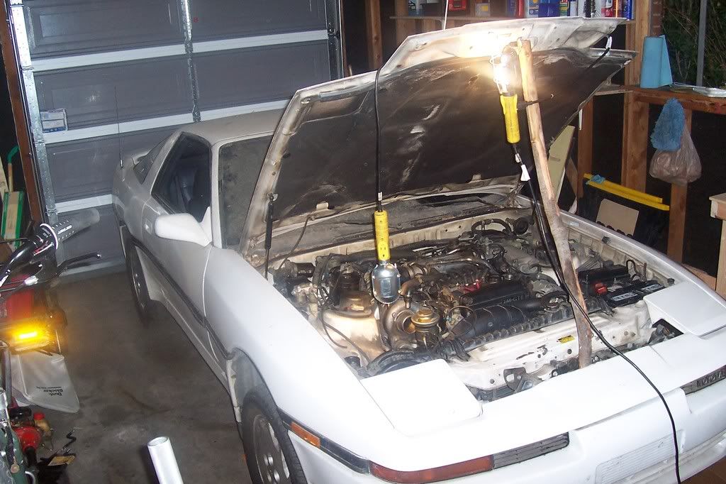

Pics the night we got it home and running:

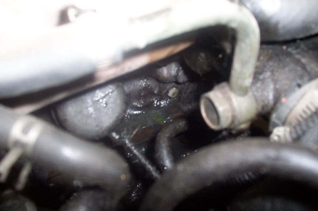

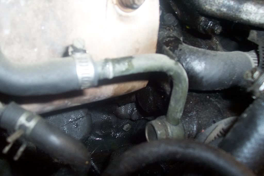

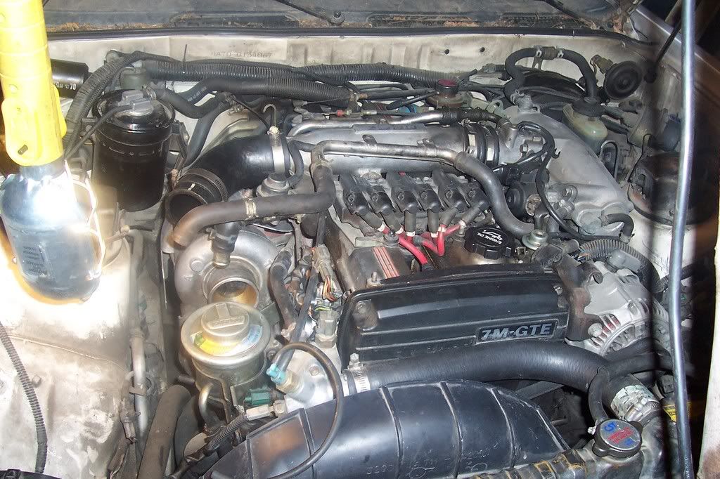

Pics of leak on exhaust side of block. The leak is above the center of the photo, dripping down.
For a grand I think we may have lucked out. :) What do you think?

Are you sure it's not that 90 degree hose that's in the left of the photo?
Could be a freezeplug like mentioned...
You'll probably have to pull the turbo and manifold to find out exactly what is leaking, so do a quick compression test to help rule out the HG...
Do you mean the right of the photo?
I am currently clueless about freeze plugs, but will be using the nifty search feature presently.
After letting it run for about ten minutes last night, the exhaust was still steamy after that ten minutes and it smelled sweet. Pretty sure it has a bhg. I'll use my block test kit tonight to see if that yeilds any definitive results.
