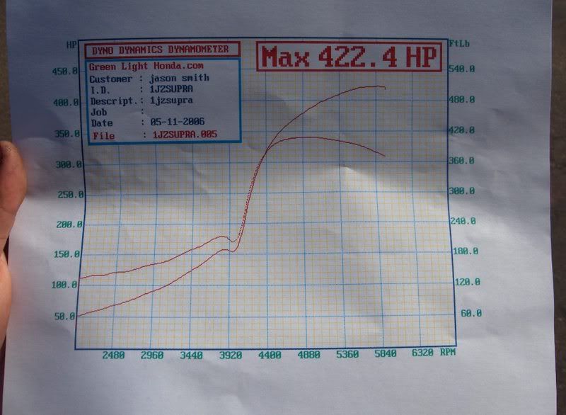

935motorsports
2,569
47
San Diego, CA
This setup has been daily driven every day for over a year. 17 psi every day (mkiv 550s). Could use some tuning in the midrange as you can see.
But unless you are ready to get serious with other mods, fuel, control, etc, stock twins are your best bet.
If they go out in a year, big deal, get another set and replace them. It is not hard at all.
