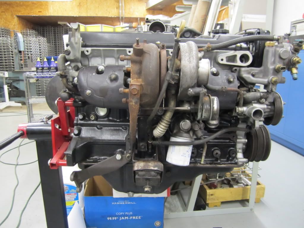

Top one if you follow the dotted line you'll see it goes to the top of the t stat housing. The other one goes to the back of the water outlet housing iirc. Should be on the other side of the water pump.
IndigoMKII
May 9, 2011
2,181
Madison, Virginia
It's connected by a banjo bolt on the backside of the outlet.
This is a picture of my old turbo with the coolant line hooked up, hope it helps.
