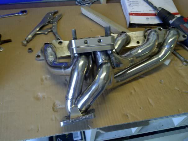

Here's the manifold with an adapter plate small enough to finally let my upper ic pipe clear -

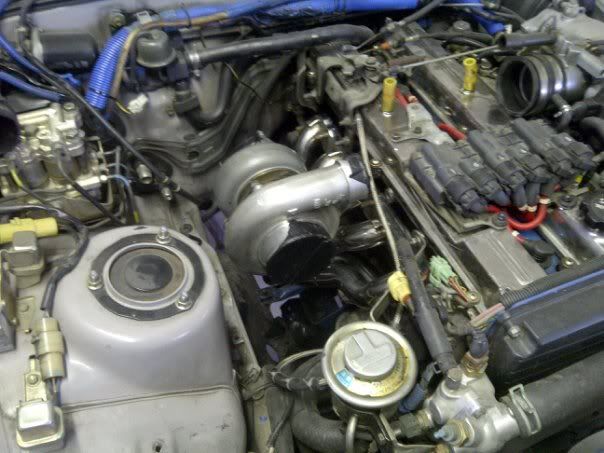

And here's what the turbo looked like mocked up in the car -

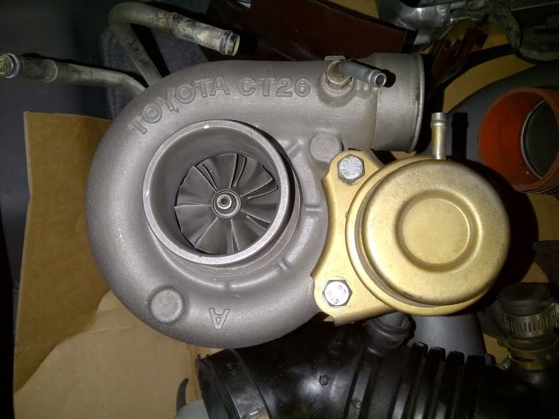

After I got the car to this point, I realized there was absolutely zero chance of the oil lines clearing so in an effort to actually drive the car at some point this year, I opted for a different, more manageable turbo. This was a really big piss off because I was really looking forward to the gt35r but hey! I also had a spare 57 trim ct26 in the shop that needed a rebuild, so I dropped it off at Alamo industries, and two days later I wound up with a brand new, slick as hell looking 60-1 upgrade in the turbo!
Turbo before rebuild -
Turbo after rebuild, side by side to a stock ct26 -

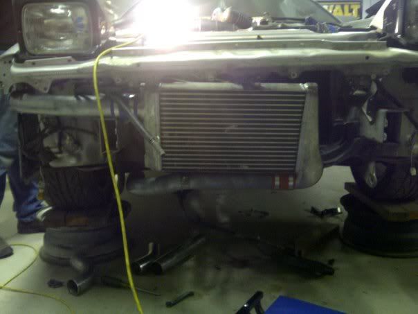

And shortly after I started on the HKS intercooler kit, this should have went nice and smooth but I had no instructions, and was missing all the brackets from the kit. After playing jigsaw puzzle for a good while, and receiving a helpful email from mstgeer on supramania (thanks again!) my dad and I fabbed up some brackets and mounted the intercooler -
I forgot to take a pic after, but the custom brackets also allowed it to sit nice and straight, instead of on a weird angle like most of the HKS kits I've seen.

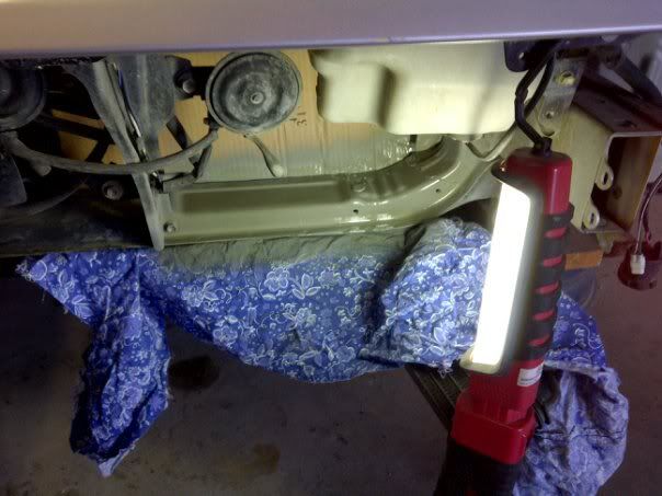

Also prior to installing the IC, I found a TON of rust behind the bumper from an exploded battery. After a good while of grinding and sanding and painting I fixed it up and got it looking fresh again
