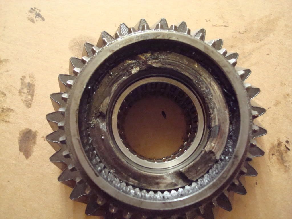

^well that $600 can go up real fast if when they take it apart and it looks something like this. it was $110 for new 1st gear from champion. and i had to get the 1-2 hub $90 from champion. let alone new syncros, snaprings, bearings, seals, ect... all being from toyota is going to run you a pretty penny i can tell you that. in the picture that is the side that goes against the 1-2 hub. they both got chewed to hell. so did that bearing. which then finally crushed the thrust washer. if you ask me the internal wear over time is going to happen no matter what the thrust washer is made of. instead of crushing the thrust washer it will keep tearing into the bearing, gear, and hub. there is no real cure to have it last forever. in my eyes the best you can do is build it to the standards it was built from the get go and it should go well over 100k.

My theory is that because of the helical cut gears (to reduce noise), torque makes the gears walk a bit on the shafts.
Wear happens, and especially the front bearing cover flexes causing play in the assembly. This allows shock loads to the parts and the thrust washers. As the torque and gear reduction is worst for the lower gears that's the thrust washer that fails.
A good example is Duane where his tranny was rebuilt before he pumped tons of power through it and it held up fine.
Quality of the rebuild matters a lot as well, as just changing out the syncros and bearings won't put the parts back into spec, and the play still exists.
Having a tranny with partial straight cut gears (like 1st through 3rd) would fix the problem permanently I'd imagine, and still allow quiet operation on the highway...
