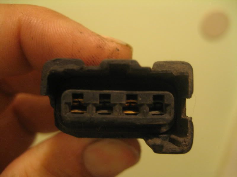

The previous owner of my supra broke the connector to my tps its a 4 wire tps and i have the grey plug engine harness. So the tps connector wires are just hanging there. 2 silvers 2 gold does anybody know the color code so i can hard wire it to the tps, I have looked through the tsrm cant seem to find it :nono:

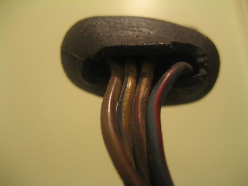

Brown, yellow/blue, yellow/red, blue/red..... wire color/stripe color
I'm holding the connector so the wires are in the same spot.
Hope this helps, btw I don't know what engine or year this is from. This is an extra connector I have laying around in my parts. Another one I have laying around is the same. I checked out mine on my supra and the wires are hard to expose without cutting something.
Good luck.
