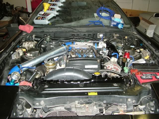

We got the latest 7m running tonight! We just did the initial 15 min run time and changed the oil, has no leaks and sounds great. Break in starts fri.
A few of the cool things on this car:
New Toyota shortblock
New engine harness
ARP rod bolts were installed on the new rods and then they were resized
Fully spin balanced the new shortblock rotating assembly with the flywheel
ARP head studs and HKS metal headgasket
Maft Pro with boost control and speed density
Driftmotion custom intercooler kit with larger Spearco style ic and Type RS bov
Zeitronics ZT-2 wideband
Powdercoated intake and valve covers, everything else aluminum was bead blasted clean
PT 57 trim CT26 upgrade
Oil cooler upgrade with thermostat and filter relocation
Driftmotion Aeromotive AFPR kit
550cc injectors
MK4 TT fuel pump
Wheels and coilovers are on the list of mods, and a nice car wash too :biglaugh:

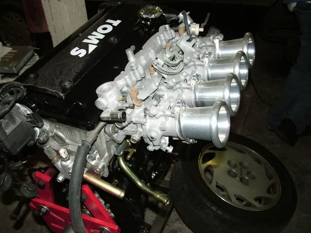

Is that a 20v 4ag I spy? The ITB setup and carbon cover look sick! I want video of that starlet when you get it running!

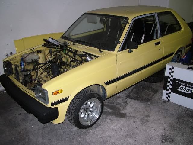

Yes, the 20 valve will make the Starlet into a little rocket! The Tom's cover is possibly the only one in the US btw. I put a 82 Celica rear end in the Starlet already, and it's getting a LSD and a standalone soon.
