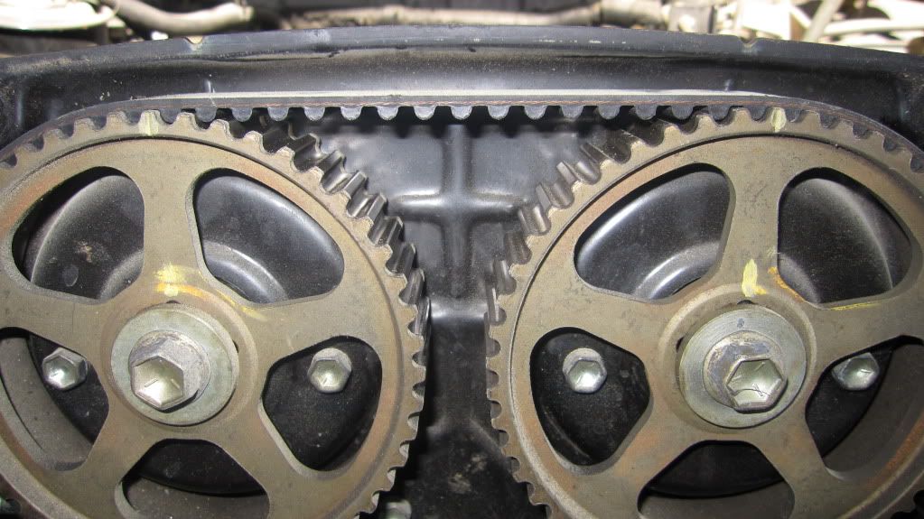

Make sure your cam timing is on, TDC on cyl 1 make sure the timing marks on the cam gears are both pointing straight up. And the timing mark on the crank pulley is at 0 (this will get you TDC on cyl 1) 30 degree's sounds to far advanced... The first cam lobes on cyl 1 should point away from each other at TDC as well.
erags1092
