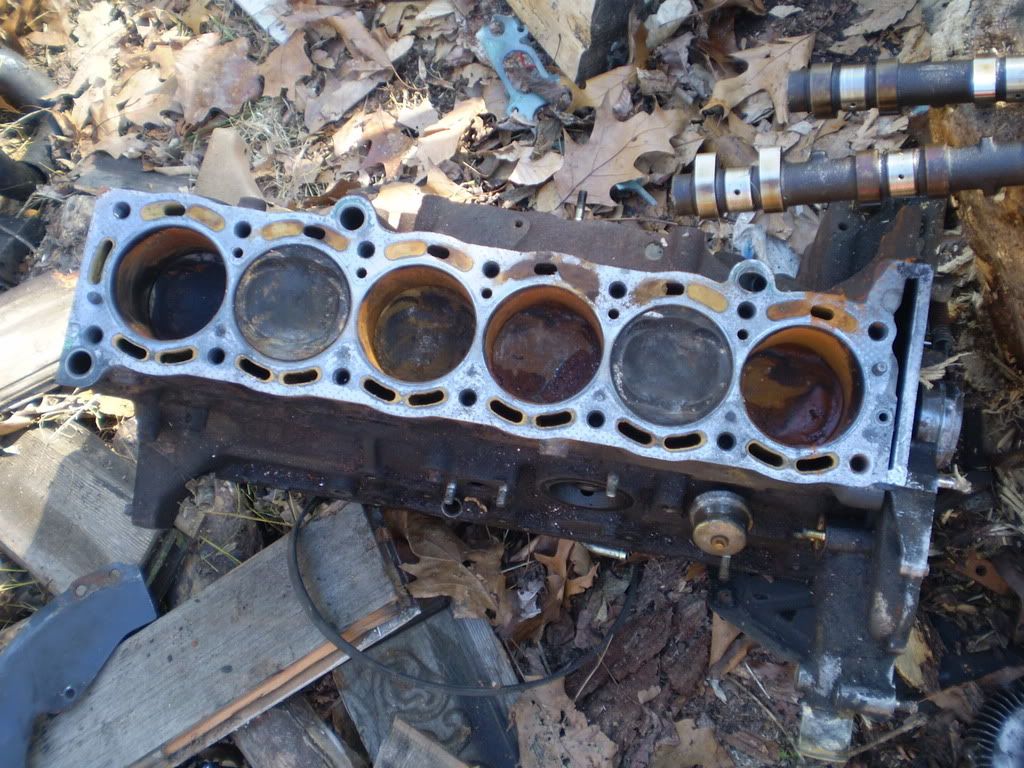

Here we are after a couple hours. Engine was sitting outside in the weather for a few months.... hopefully i can get the cylinders cleaned out good. maybe i will get it honed?!
