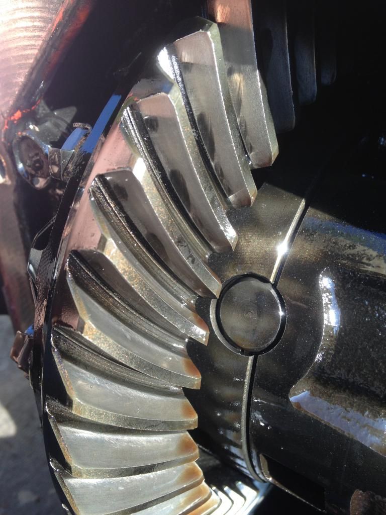

Heres the Yukon gear set that i found in 3.73
http://www.yukongear.com/PartsList...."+V6+Rear&CatID=35&CatName=Ring+&+Pinion+Sets
There on summit for just under 300 for the set.
Heres a pic of the Ring gear.

Good to see more people tearing into these differentials.
Ohh that looks like it got toasty.
Lost a bunch of the face hardening on the drive side tooth.

How can I tell?
1. Heavy noise loaded drive side
2. Wear pattern scattered all over the face of the drive side
3. Darkened heavily loaded/heated areas deep on the face, also scattered all across
4. Your crush sleeve is all but destroyed/no preload on the pinion bearings allowing the pinion to move around way too much
5. The drive side is no longer shiny/looks as though sandpaper was taken to it
6. None of the bearings are under any preload whatsoever.
How much worse does the pinon look?
How much slop can you feel in the ring & pinion backlash
How sloppy is the pinion flange radially?
Edit:
And the video shows unloaded drive noise as well.
Basically everything inside that differential is trashed.
All bearings, ring & pinion.
