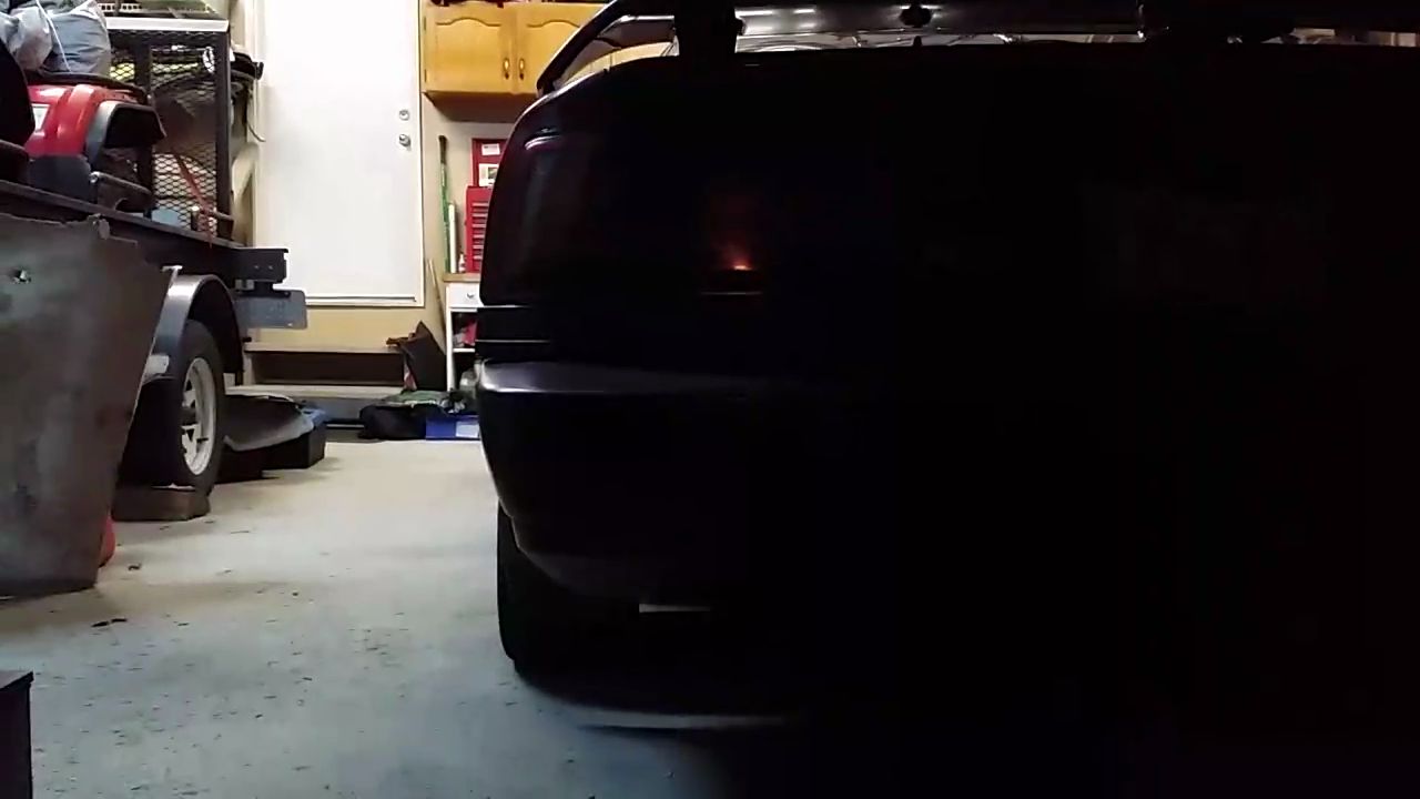

Her putting away with #6 completely gone the same night it fucked off. I was going up against my friends 2011 STi with many bolt ons. Best part was we were neck and neck and I was down a cylinder haha. Previously I'd walk him so when I wasn't, I knew something was up. When I stopped, she wouldn't idle and I limped her right home.
(video^)

FIRST, THE CARNAGE:
2 Broken ringlands.
(video^)
