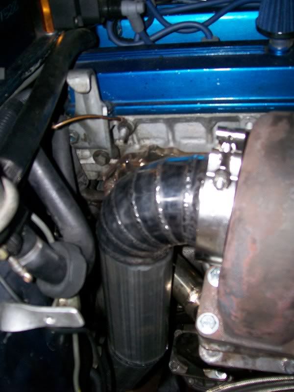

Well I haven't been on the forums much lately but rather been really busy with my racing and haven't had time to work on the supra much. Well it has been about a year since the car ran last and probably the biggest hold up is the wiring:3d_frown: I hate wiring. This is just a teaser but I will update as it comes along!
Looking for setup guidance for the Megasquirt 2 with V3 board settings to get it running smoothly. If someone has a file from a properly tuned supra that I can start off with I would greatly appreciate it!! The actual tuning I can handle just not sure what some of the lag factors and things such as that should be to allow the system to adapt correctly and keep a constant air fuel!

Just shortest route without relocating the battery and I liked the look something different I guess? They will be coated with the gold NASA heat shield on the bottom side to stop the heat soak!

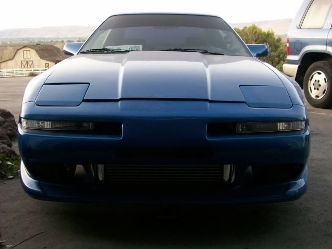

O and if people are wondering what the car looks like here are a couple pics:
The paint job is not the best by any means nor is the body work but it looks decent and I would rather spend the money under the hood and then do the exterior right!

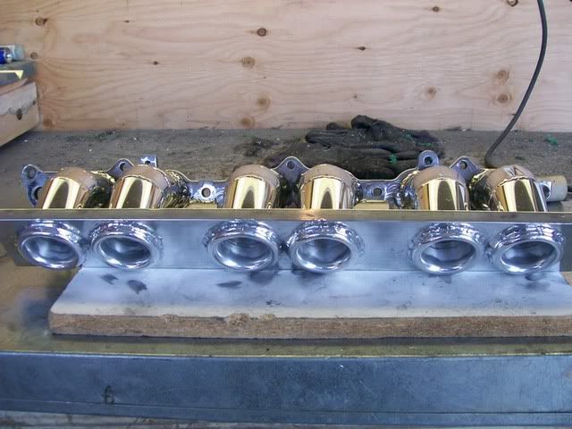

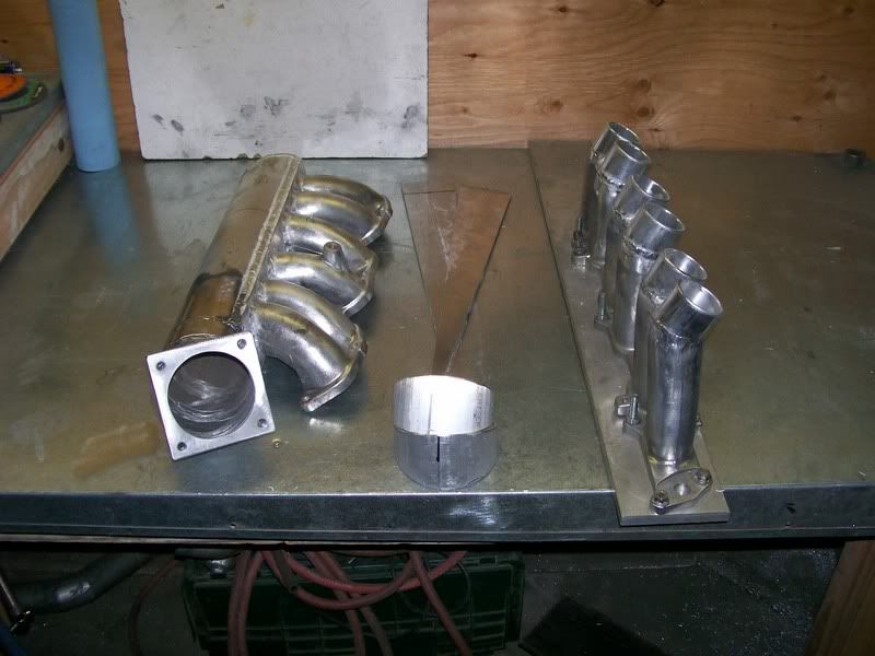

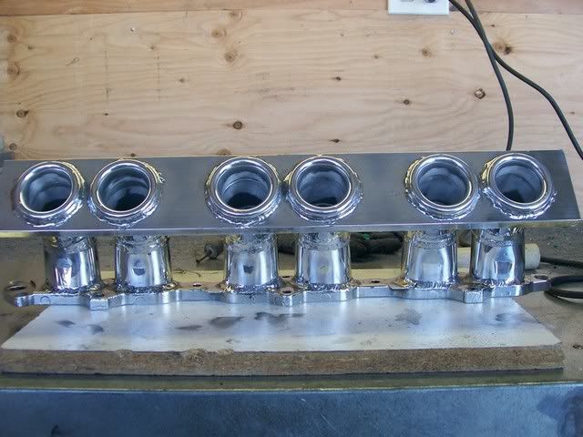

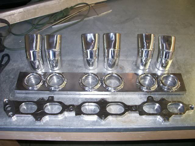

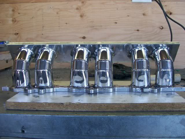

Yes I am running two fans on the radiator and it I will also be getting an aluminum radiator shroud to make sure the air finds its way through the radiator! The FFIM is my fully custom one I have been working on here are a few pics:
Thanks,
Seth

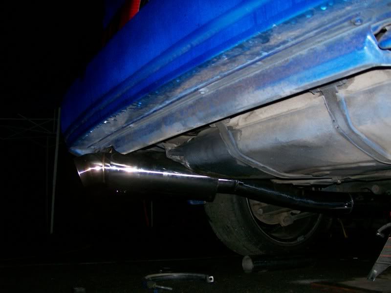

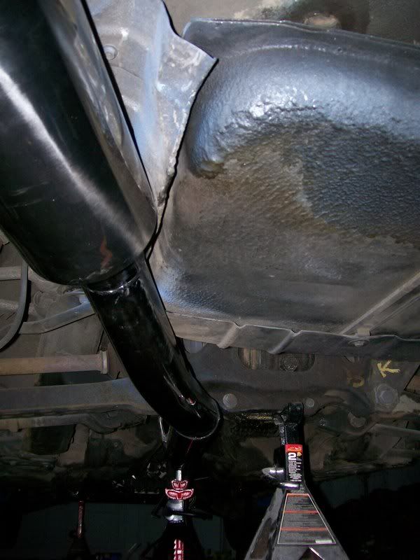

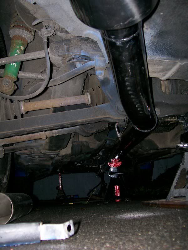

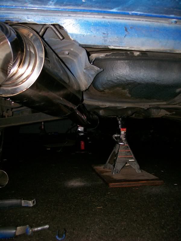

Nearly finished exhaust, sorry for the night pics will get some better in the day light:
DP:
Back half!:

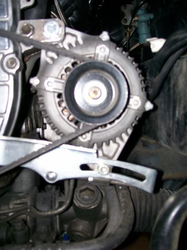

New Alt Bracket, simplicity I guess is the key? We will see if it works but I don't see when it shouldn't!:
And the main projects right now:
Thanks for looking. I promise I will get a vid up once I get it back together for the first drive, I am moving soon and pray I can finish it up enough to drive it before I move!
