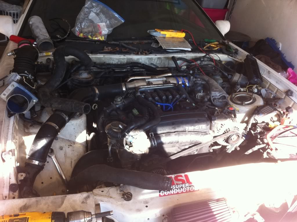

Well the engine and tranny is in. Not too much of a problem. When I first tried to start her she wasn't getting any fuel. Checked the fuel pump and 0 volts. Jumped the fp and b and the fuel pump came on. I took the banjo bolt at the engine to flush any old fuel out. After seeing the jelled fuel I decided the drop the tank and check it out. It had s rusty coating so decided to do the pee gravel cleaning method. When I was finished with that I bolted every thing back up and she fired up but the idle was surging out of control. After doing an hr of research found a thread about the icv could be clogged and not opening. Clean the piss out of it and reinstalled it. The idle is flat but a little high. Here's a few pics:

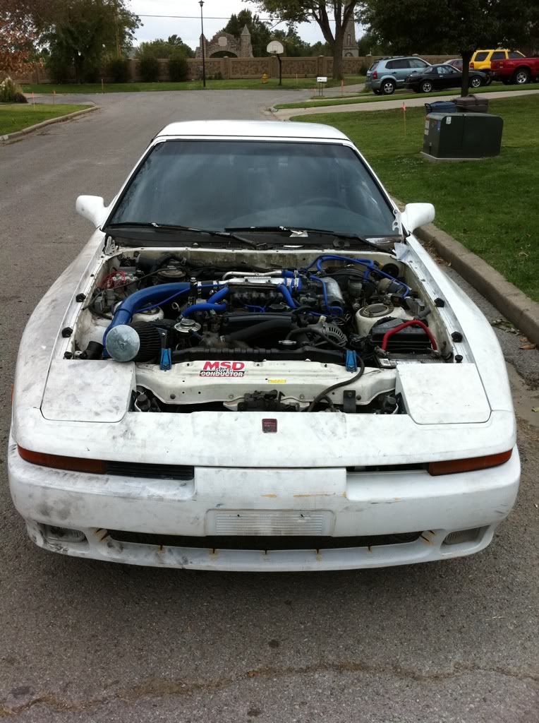

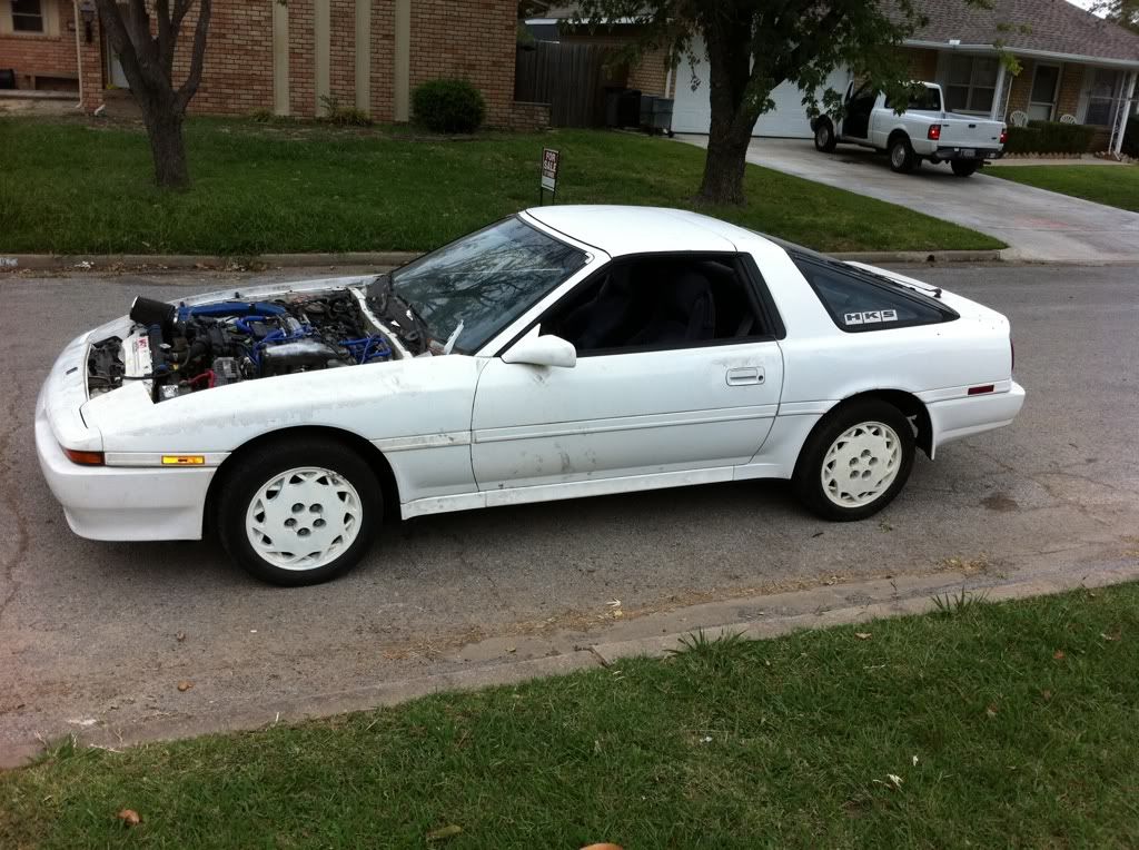

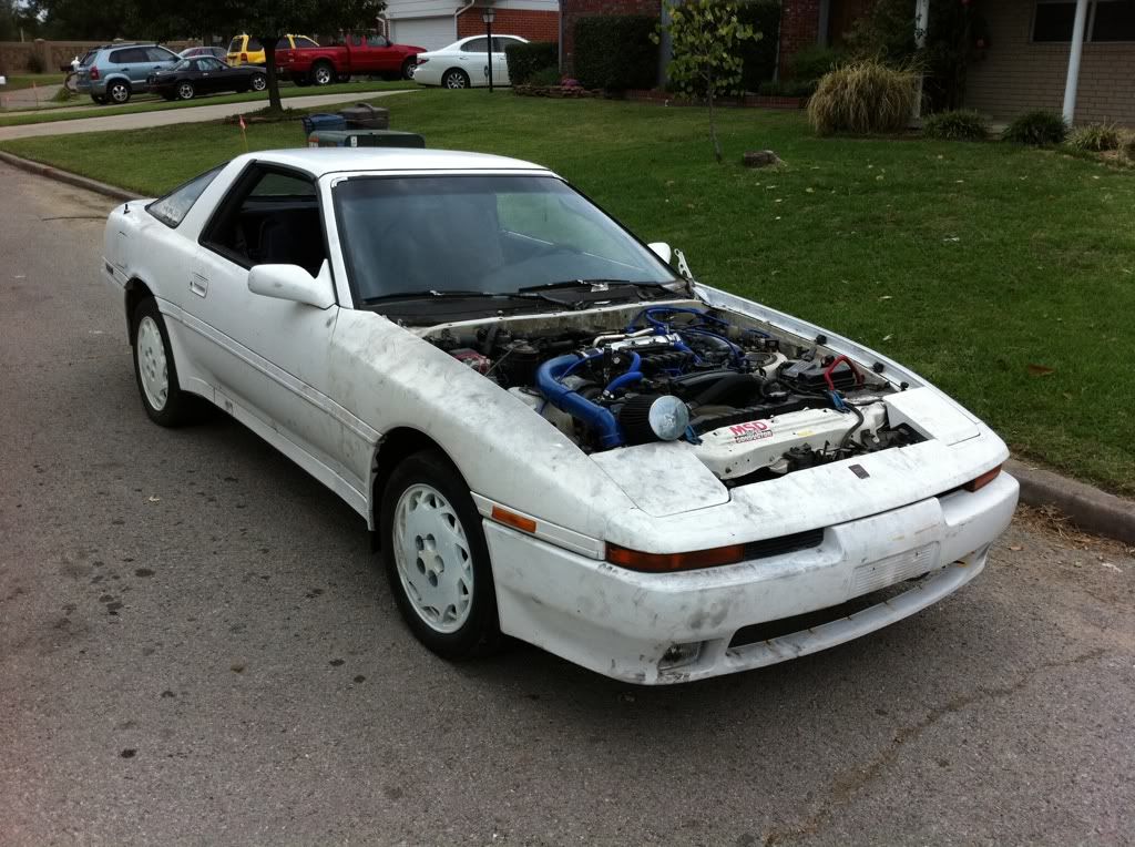

My blue vacuum hose kit came in along with my hks bov. Installed everything and took her for a spin and she runs like shit.
Idles fine and revs great. When I put it into gear it an start to go it wants to miss sputters and bogs. If my tranny ground wire isn't connected will it cause problems? Well here's a few pics
