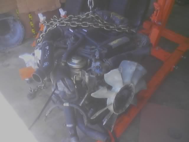

The story begins in a grassy field where I first laid eyes on her. $1200 and a BHG later, she is in my garage getting a new HG. She ran all of 6 weeks till a nother BHG. The machine shop that did the head work bent me over, number six bypass. I don't know of a blender they make that mixes oil and coolant together better that ol' number six. I did it by the book from step one, except.... I went with a composite HG set versus a MHG due to the fact that I was going to purchase another motor to build. This was going to be my unmodded stock runner until then. I torqued to 75lbft, ARP head studs, everything was perfect (except the head apparently).

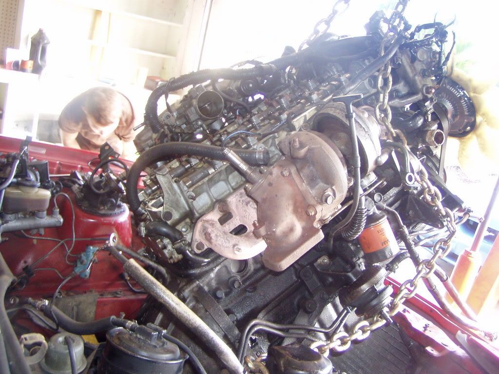

Now... the new beginning (see photos). The motor is out of the car, and it is already turning into one of those "since I am doing this, I might as well do this" situations. I am going to go with a new rotating assemblies including rods, pistons, turning the crank, main bearings, etc etc. I am also going with a new alum radiator, new exhaust manifold/plumbing/intercooler, turbo kit, etc..
I figure I might as well do it all, and make some power. Wish me luck err ahh my wallet luck..
P.S. That 7M is a pain to get out.

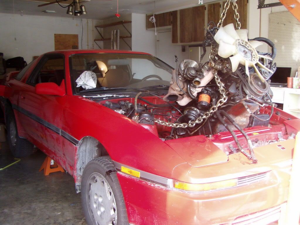

ooh, yikes.. yeah the 7M is only a pain to remove when you do it wrong!
You've got hoist hooks at the rear of the head on the exhaust side and on the alternator bracket. Remove with the transmission and you can have it out like most of us in 2hrs time. It just looks like you did it the hard way...

I did remove it with the tranny. My first time, I just figured from the front due to the fact of how long the tranny was. It was a learning exp, it took about 3 maybe 3 1/2 hours total. I was also worried about lifting from the head, so I chose the PS bracket and the AC comp bracket.

oh yeah, that too. The guy I borrowed the hoist from let me borrow his load leveler for the first time i removed my engine.
After that, I bought my own setup and when they asked if I wanted a load leveler, I definitely bought one. I wouldn't ever pull an engine without one.

Load leveler? Never heard of one except on truck suspension.
I'll look out for one when I put it back in.
One thing about these cars I found out when I took the motor out was the amount of hoses that are bad, pretty much all of them...
