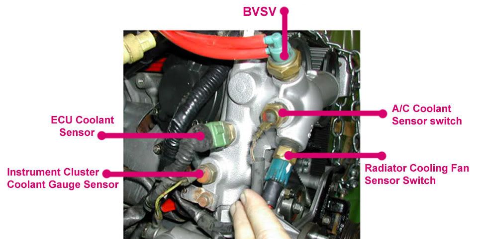

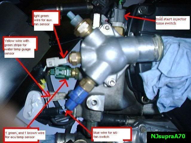

In addition to the connection at the cluster, the other likely culprit is the short pigtail and connector from the harness to the sender in the engine bay. Subject to a lot of heat and vibration over many years can cause it to fail.

ok, so after looking over the thermostat housing a bunch, i noticed a connector below the temp sensor was broken off, so i fixed that and it still doesnt work.... i cleaned up all the connections i could find...... WTF???

problem fixed...... long story short, im an idiot and didnt see a broken connector hiding under the power-steering pump..... re-soldered a new connector on, and plugged it in. WORKS. thanks again you guys....
