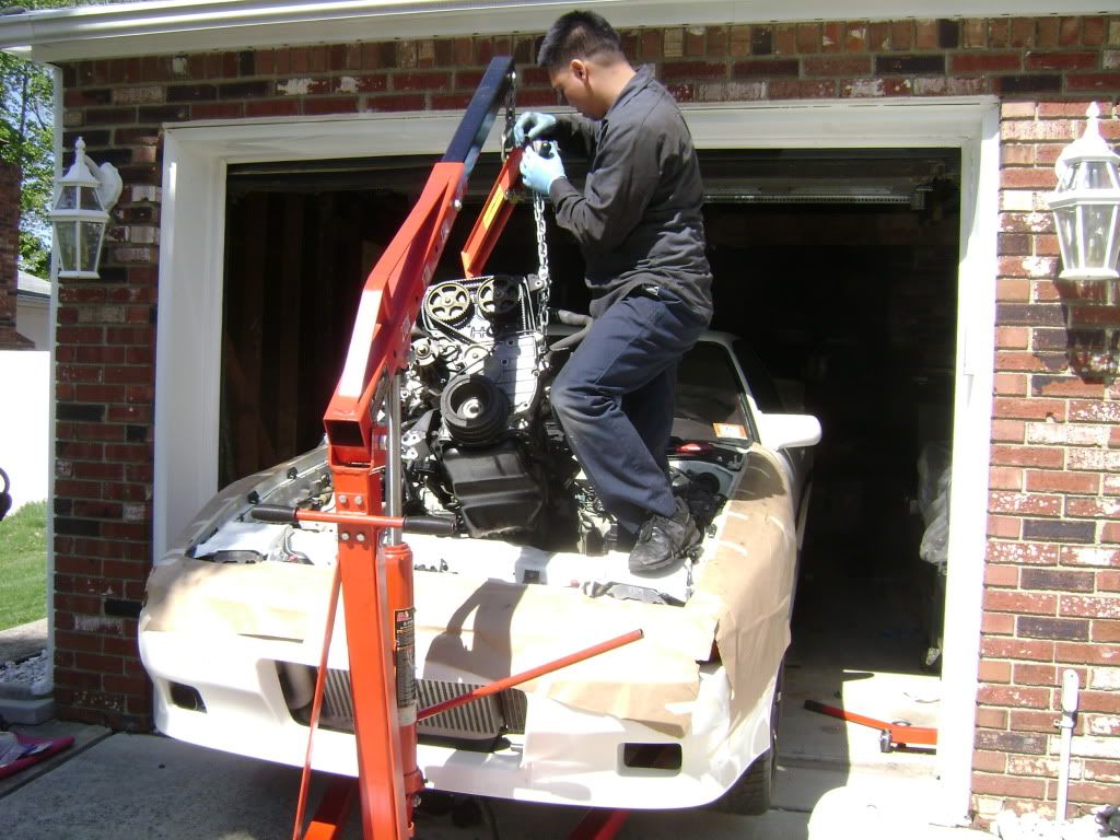

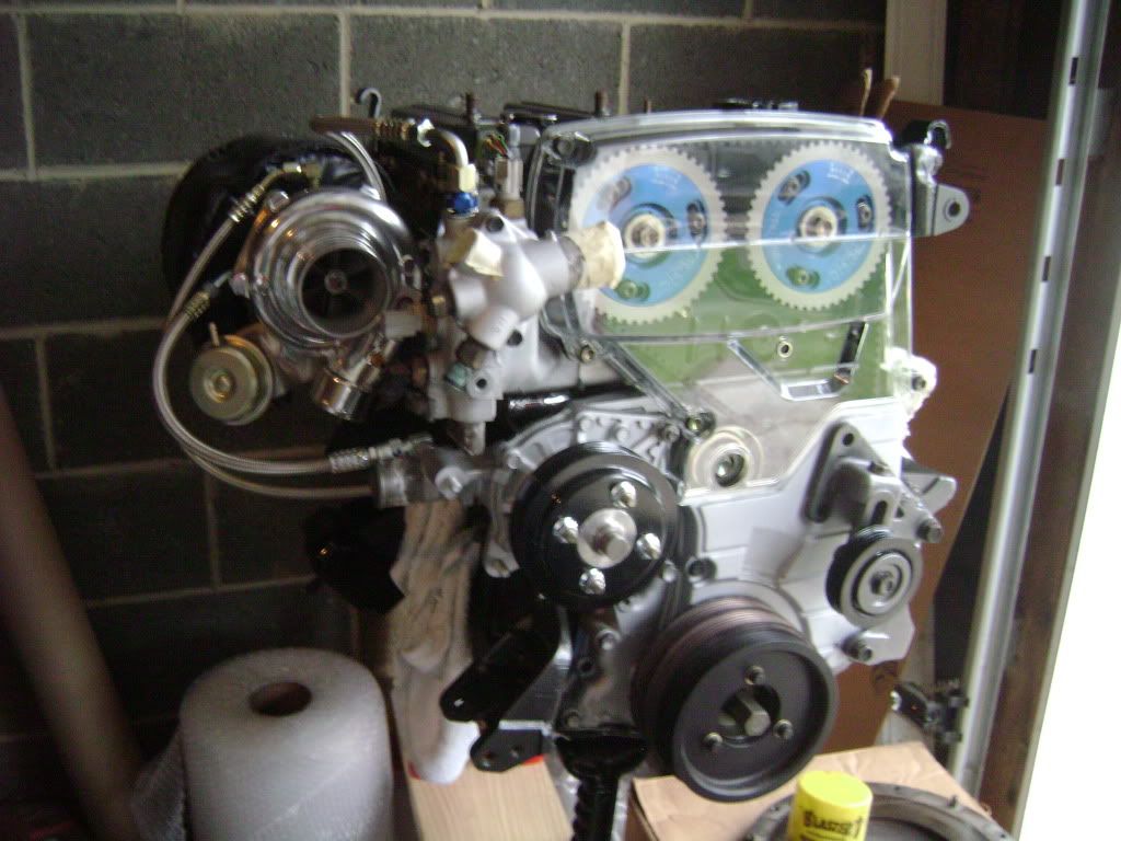

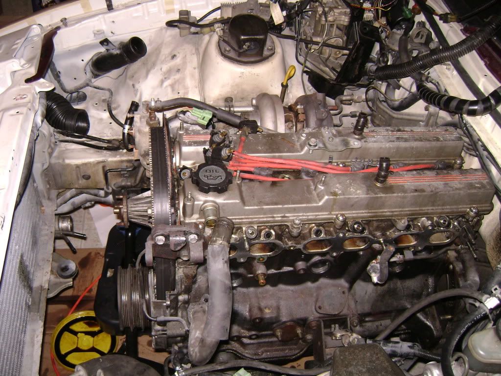

pulled the engine out
had a hard time trying to pull the engine harness from the compartment. So i disconnected the engine harness the hard way.

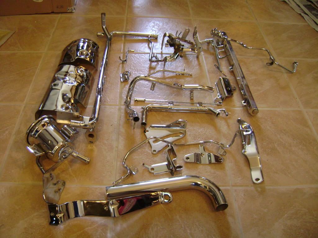

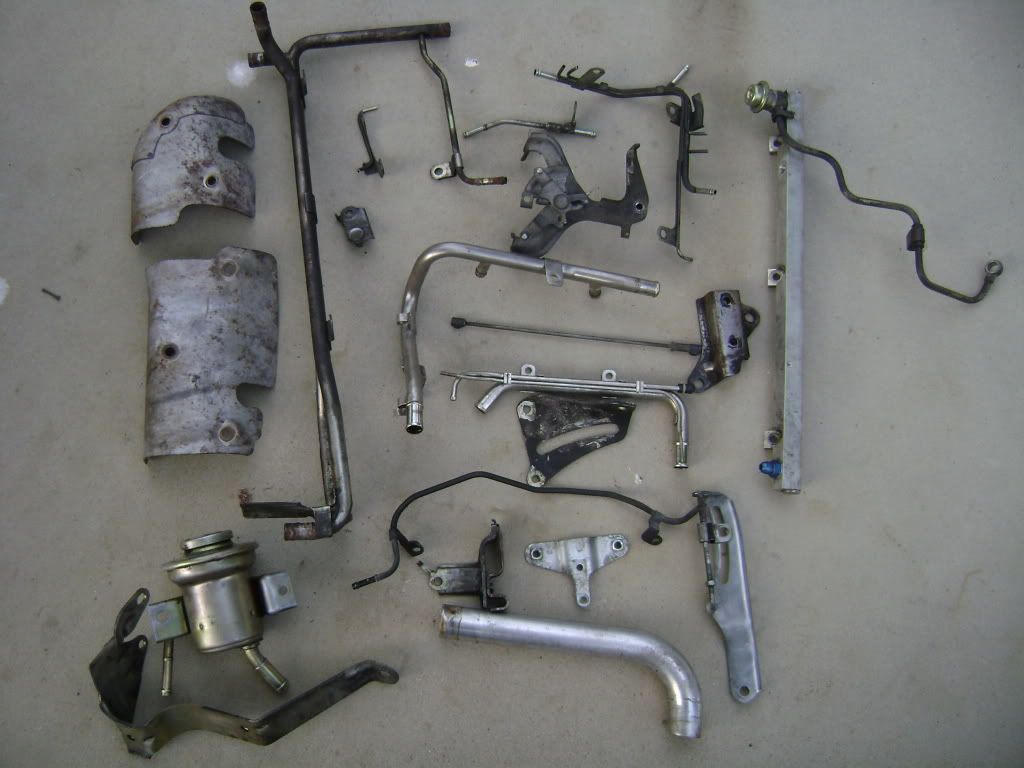

some parts before they were chrome.
picture after chroming
chroming was done by superchrome. I will be getting a few more things chrome in 2 weeks.

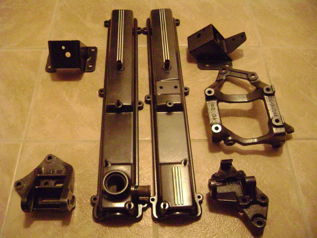

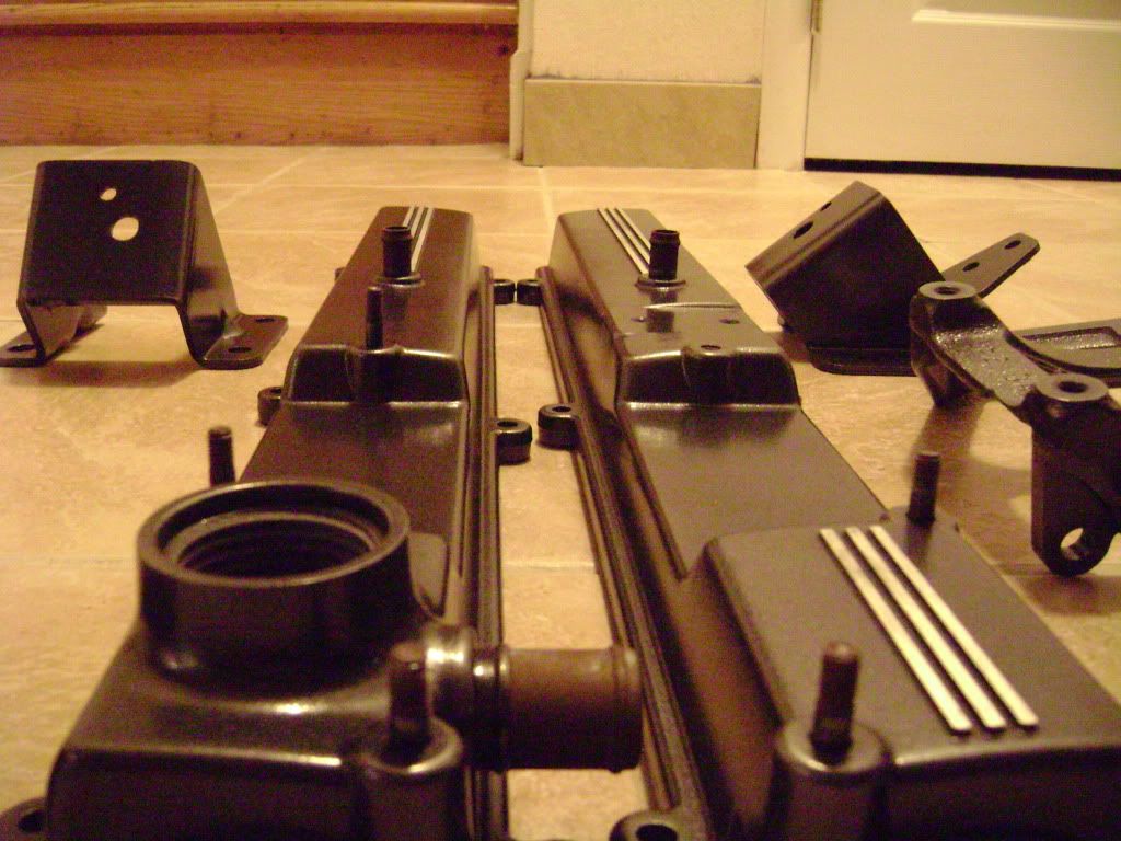

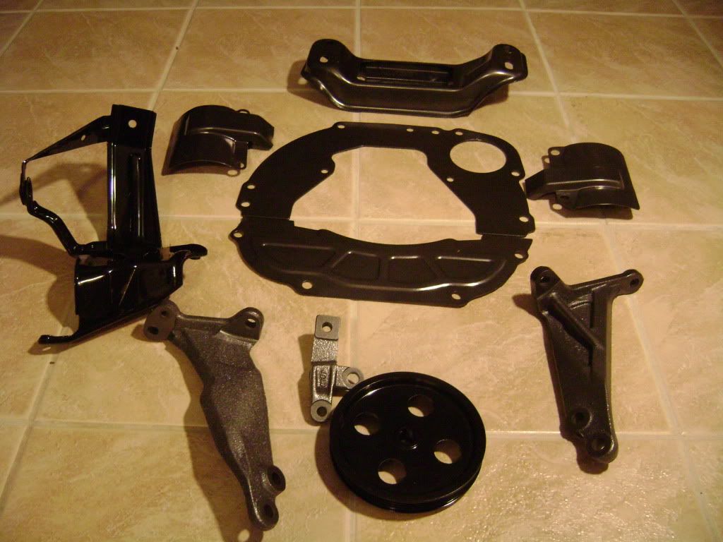

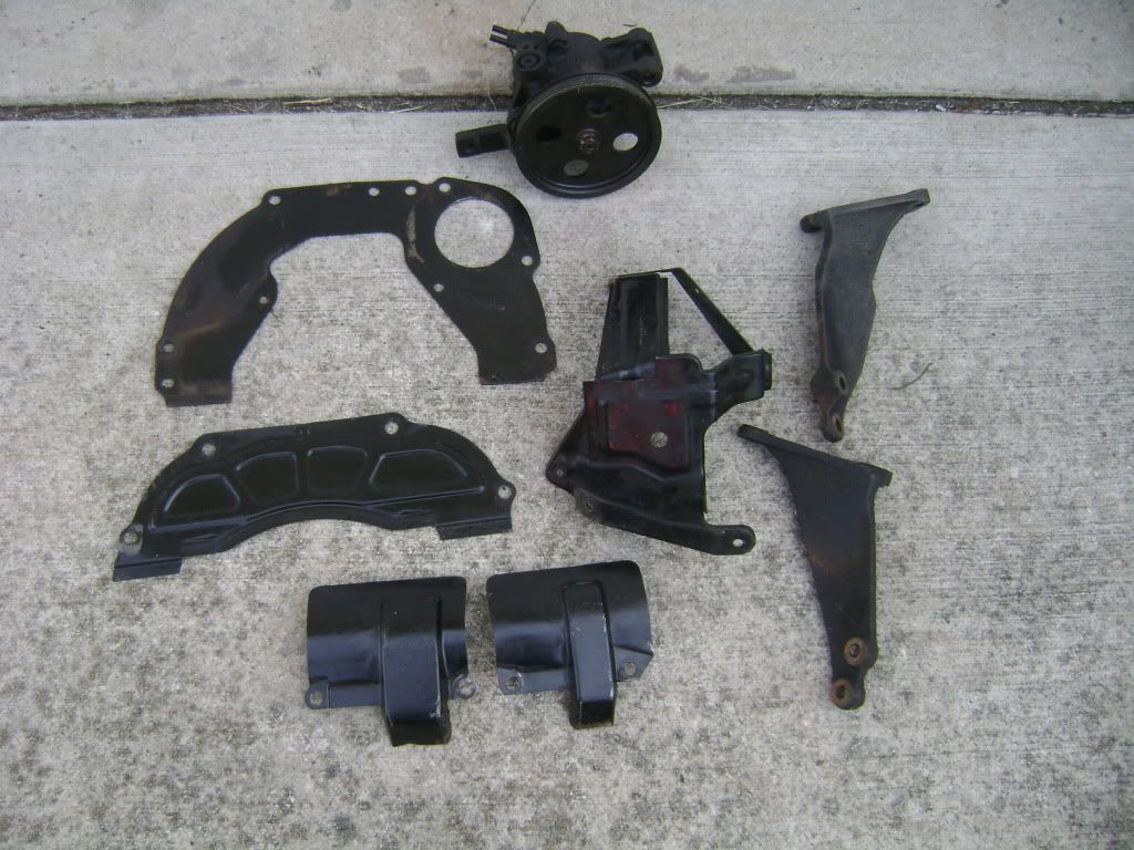

A few peices powder coated by a friend who has a small powder coating business.
there are alot of other pieces i had powdercoated, just haven't had a chance to take pictures.

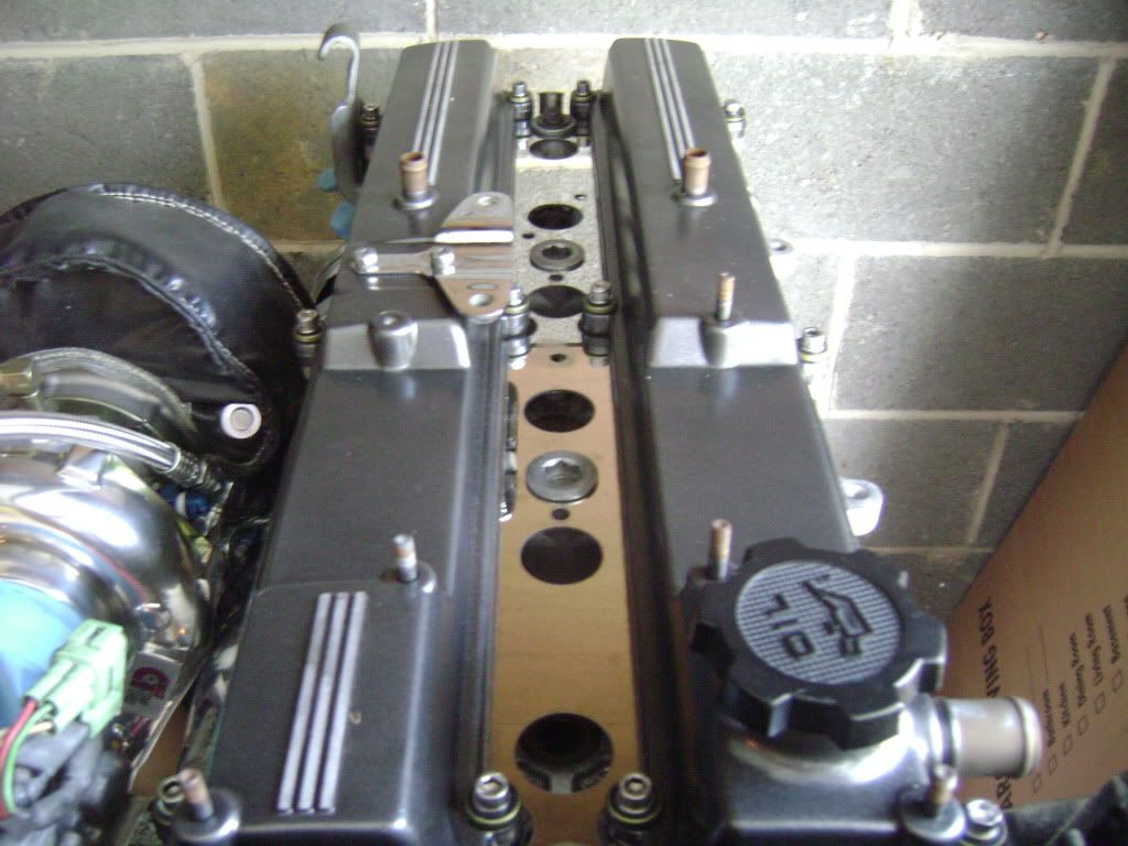

Engine in its current state.
my favorite piece. The lipp spark plug gallery.

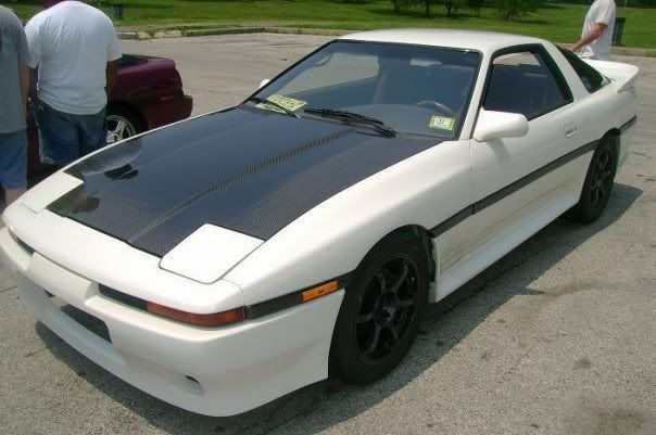

Haha, I was just about to say your car look like Duane's, but didn't think you knew who he was. Any more exterior pics?

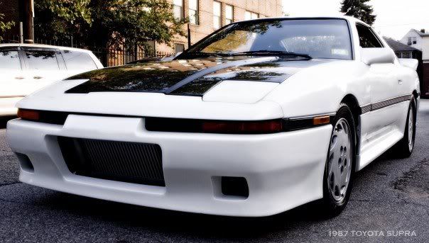

Yea. These pictures were taken awhile ago.

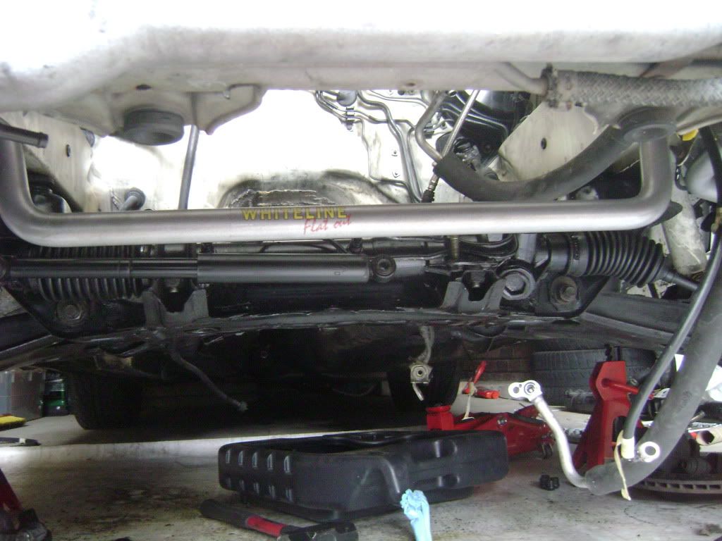

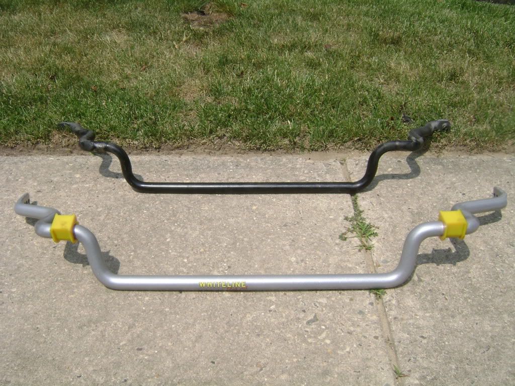

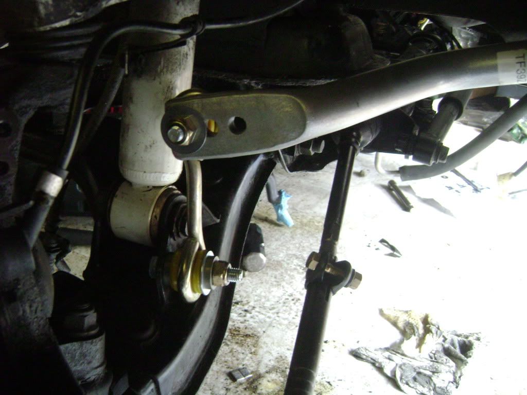

installed my front whiteline sway bar today.

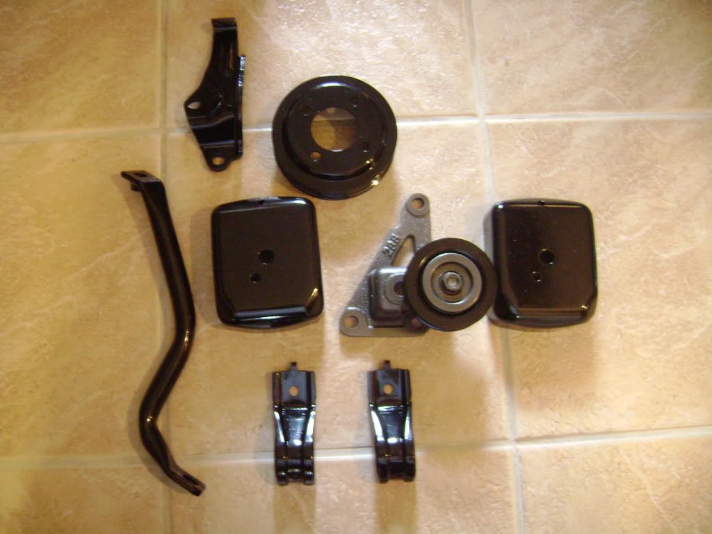

more stuff powdercoated
before
after

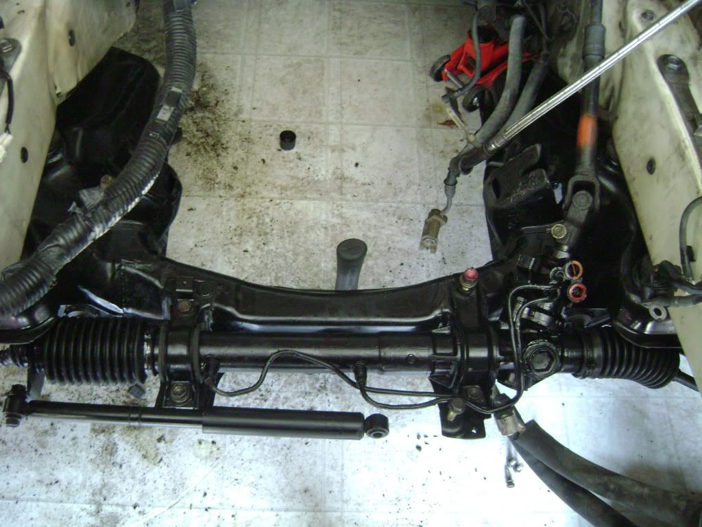

installed my new remanufactured rack and pinion
does anyone have a pic of their rack and pinion with the hoses and lines installed?
I also tried installing my driftmotion brake hoses. They don't seem to fit where the stock clips go. Anyone ever install these hoses on their car?

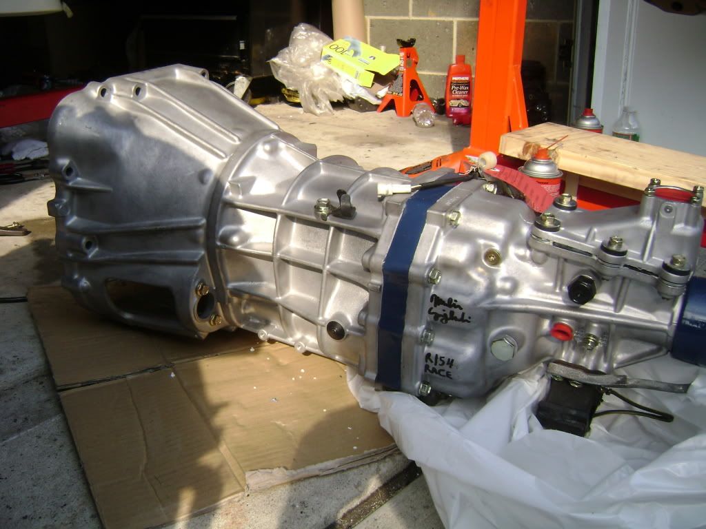

Finally got my transmission back from Marlin Crawler.
Looks like they replaced every single nut and bolt.

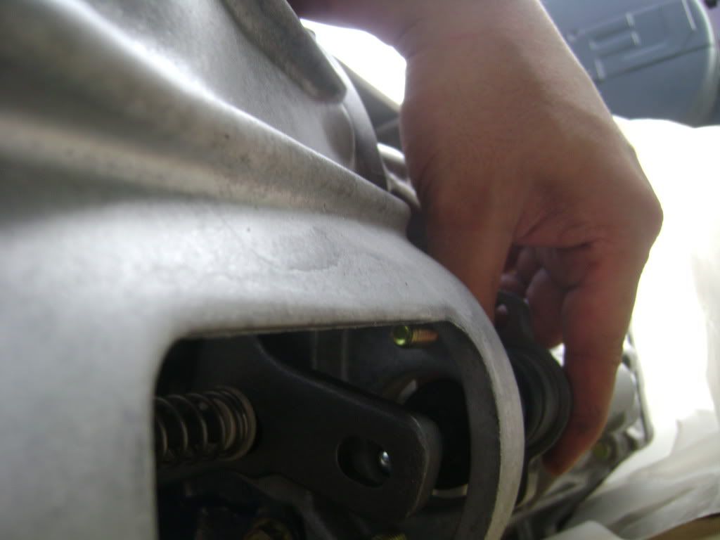

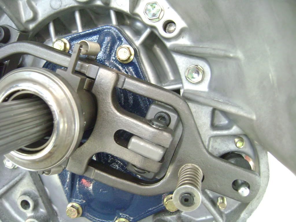

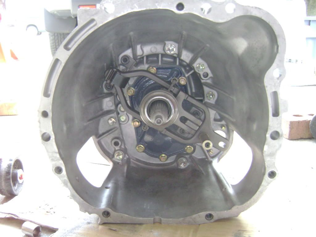

The OS Giken push pull converter is installed.
Thanks for the help Empera! :icon_bigg
One of the ribbs were grinded on the bellhousing to have the kit fit. Maybe the kit was for a 1JZ.
But its says "1JGTE 7MGTE push pull converter" on my receipt from RHDJapan.
Does anyone know how the slave is suppose to be connected to the push pull kit?
How does the slave cylinder look on a 1jz? Is it the same for the 7m?
supra1008
May 2, 2007
1,179
Philadelphia
Yea its the same as the 7m/r154. The w58's are different. I wanted to come down with julio to check your car out and help out if needed but i was volunteered to help some idiot tow a z32/na with a bhg that he just bought.
