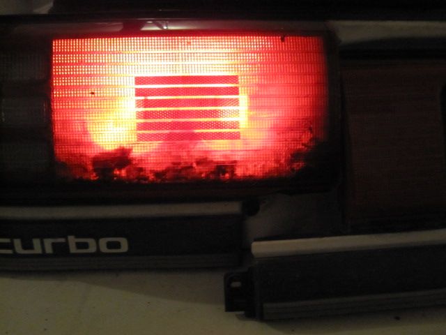

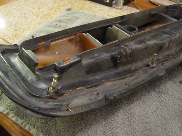

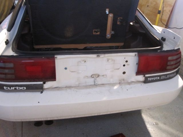

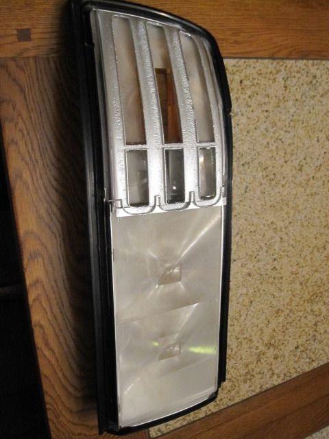

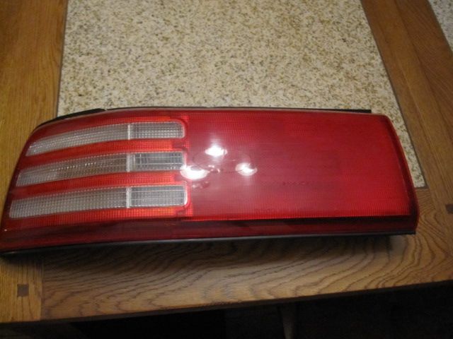

As you can see this is what it looks like before all of this mess. The top of the outer lenses loose their sealing ability, and grow some stuff in between the two sealed pieces. I am not sure what it is, if it is leaves, or mold, or what.

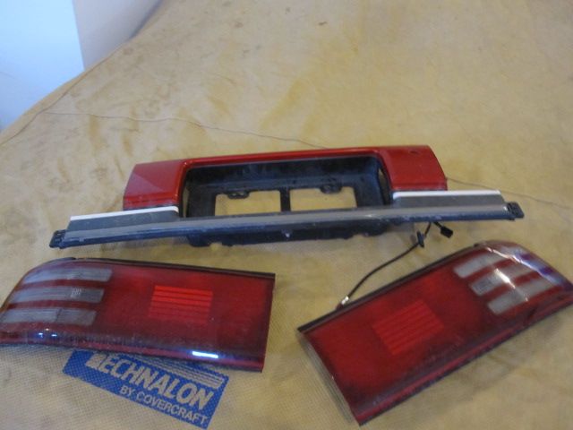

These were the ones off of my parts car, which were actually better than my drivers, but not for long.
My drivers had this except it went up about two inches.

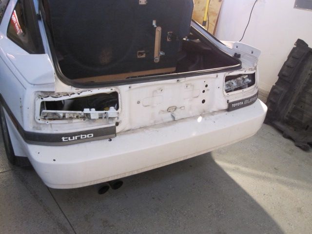

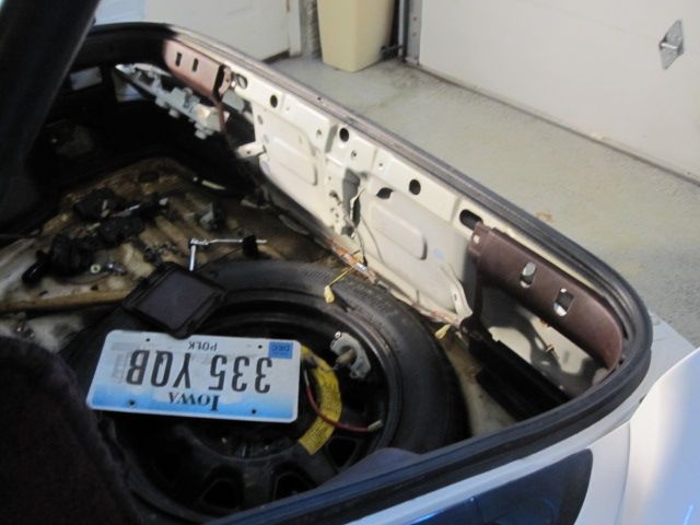

In the process of taking everything off.
This is all you have to take out in order to get to the bolts and nuts. It is a pain, but can be done.
All off!

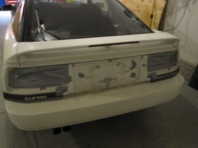

Time to tape it up, so I can leave it outside for the next few days. Daddy needs his truck in the garage. :wtf:

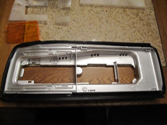

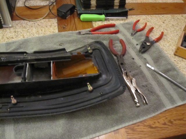

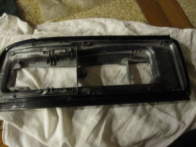

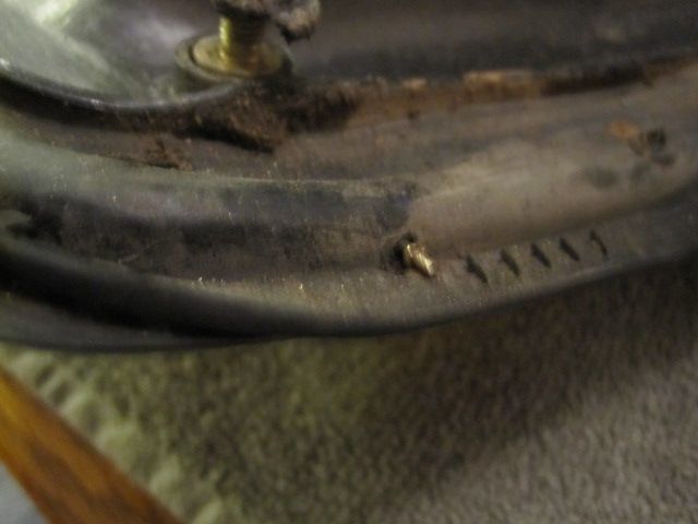

After you get the lights out, This is what you have to do to the housing.

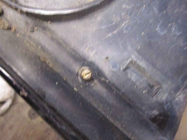

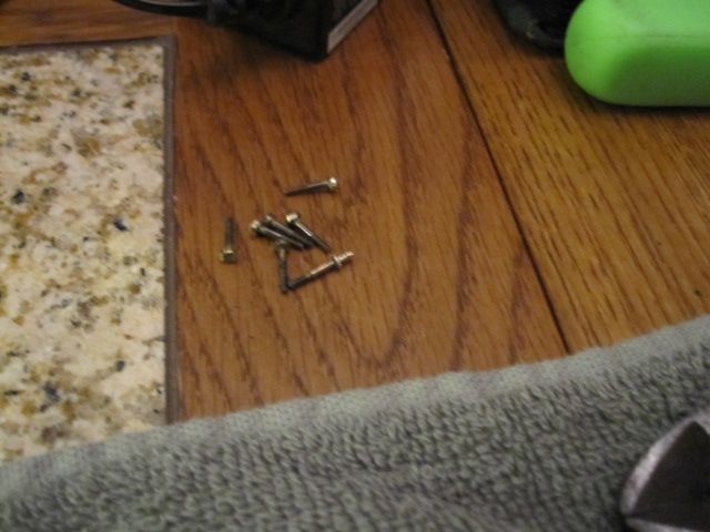

First you may want to get a dremmel with a cutting wheel on it to make a flat head screwdriver slot, or some knives to cut away at these screws. They really don't look like screws, because there is no head on them, and they are flush or under the plastic, but trust me they are. Also there are seven of them. Six are the same the seventh is different, more like a stud.
This is what I am talking about when I say use the cut off wheel to make a flat head on it.
Just be sure not to cut too deep.

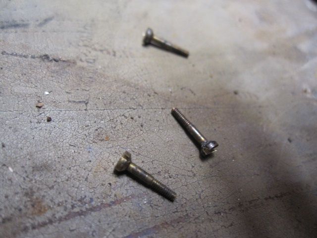

This is the one that looks more like a stud, and will only come out if you use a pair of needle nose pliers on it.
See they really are screws. :furious:
Before I thought of using the dremmel. I was using exacto blades to cut around the plastic, and I was unscrewing the screws with a pair of pliers. It is much more time consuming, and isnt as clean as the other way, but will get you there eventually.

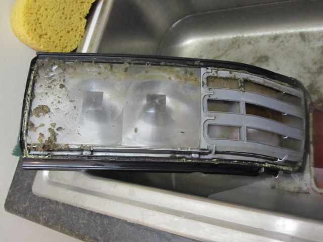

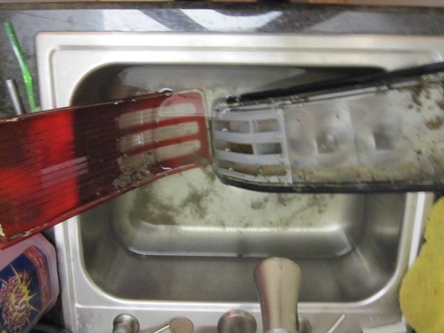

Well now that I got those bad boys out it is time to fill up my deep sink full of water, and drop one in to see how well it will split.
Now we wait a little while for the water and heat to set in.......................
After about ten minuets. Shes apart!!!
You will see that it is already coming apart. All you have to do is just gently pry the outer lens off from the black backing piece.
Gross look at all that! :run:
And shes out. Time to get to cleaning.

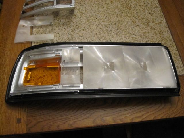

All cleaned up, but still have to get the old glue off of the main lens and the black piece it connects to.

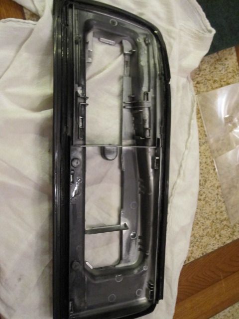

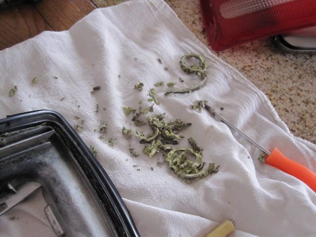

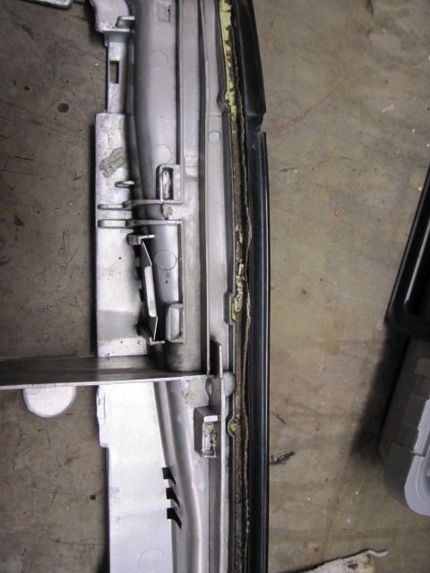

If you want the new silicone to seal well, you will need to try to get as much of this yellow/brown glue out before trying to do anything else.
The brown is where there were leaks in the lens housing.
Glue gunk. Grody!
For removing this I used a couple small tip flat head screw drivers, and a few picks. It did the trick.
For the little extra I used some sand paper to get it out for a good finish, and seal.
Pretty clean in that ridge now.

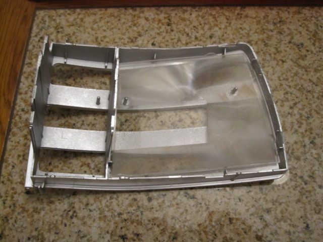

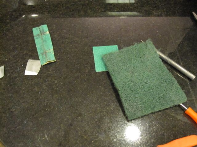

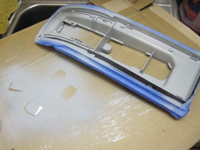

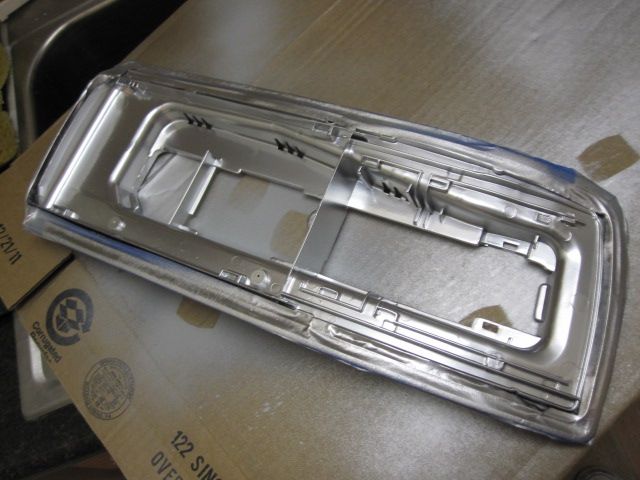

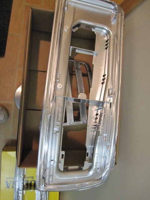

Next you will want to scuff the silver inside of the housing with a scotch brite pad, to prep for paint. It will help it stick better, and the metallic paint will reflect the light better, resulting in a brighter light.
Scotch brite pad, and some sand paper for scuffing and getting the excess glue out of the ridge where it seals.

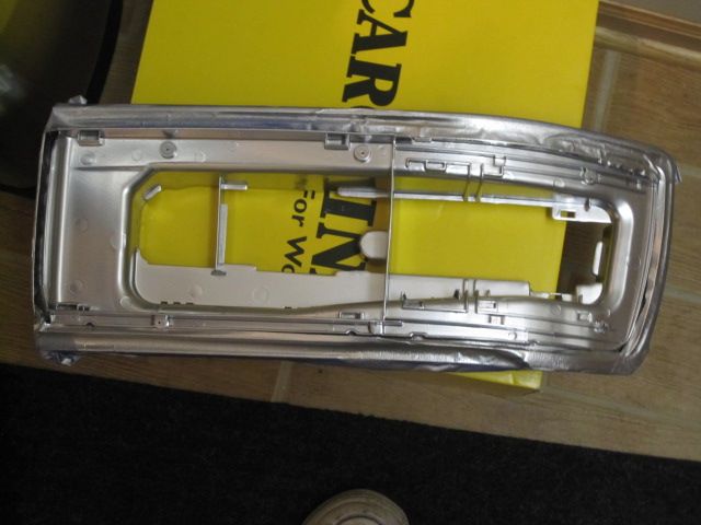

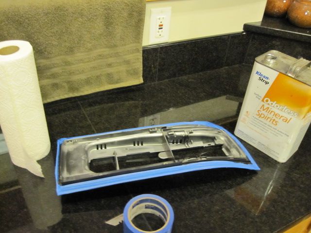

All scuffed up and ready to paint! Just got to tape them up, so you don't get paint on the trim parts.
Taped.
Also don't forget to use some mineral spirits to get the dust and shit off.

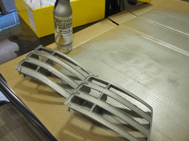

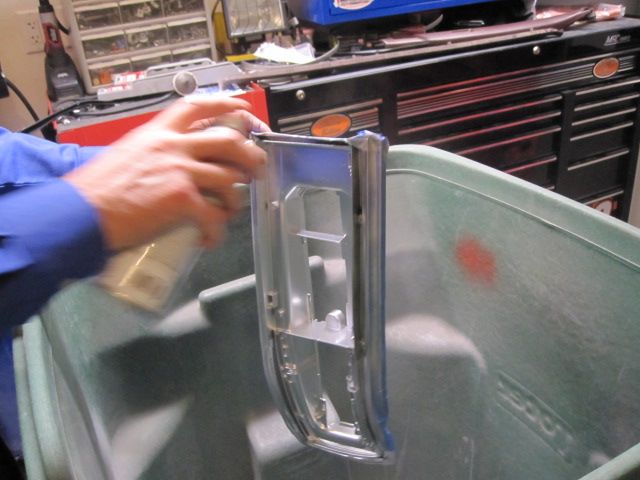

Primer always helps for a nice paint job.

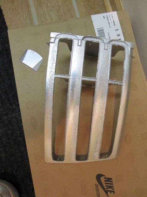

And this metallic paint will help it gleam, and reflect light.
My dad the rattle can paint pro. He wouldn't even let me paint. (I think he just likes the fumes)
And that is some bling bling! A few more coats will do the trick.
Don't forget to give these guys a nice little coat.
After everything had a couple coats of paint on them. So shiny, I cant wait to see how this will reflect. I am excited. (paint fumes talking)

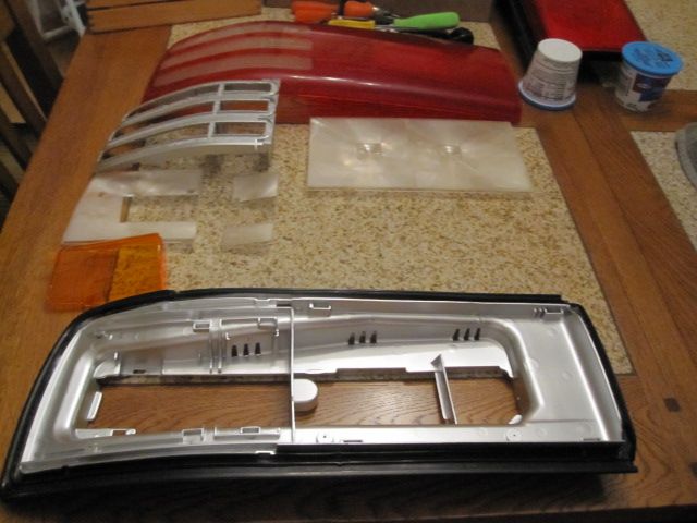

Ok so here it is. This is everything in the order for rebuild.
First put the orange lens in the tabs where it belongs, and put epoxy down in the little holes where the little clear lens and the big clear lens goes. Then you will put them in. Make sure you get the clear lens straight, or else it wont fit around the gray piece. This is how it will look.
Then you will take the gray piece and the medium sized lens and put that lens into the gray piece.
Then you will put the gray piece in.
Next up you will want to put the epoxy or whatever you are using for a sealer into the lip where it seals it. Next put the light lens back on, then put something heavy on the light and let it sit for a long time to dry.

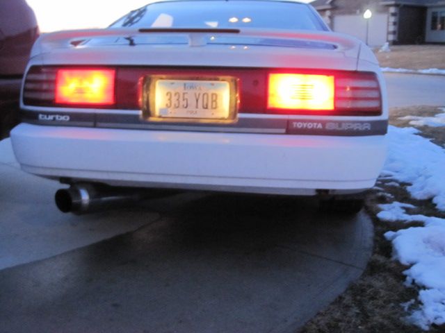

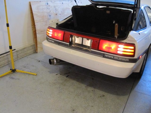

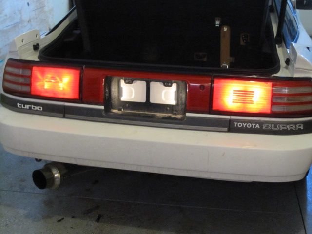

Tail lights back in, looking good. Specially with that sexy RSR exhaust I came by.

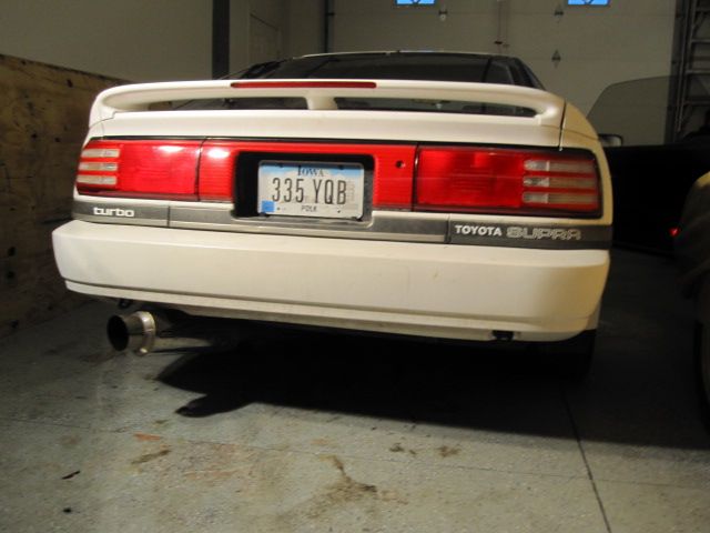

Here is the finished product.
All the lights on.
Tails only.
Darn bright for just the tail lights, no brake lights. I don't have any friends to hold my camera.
It kind of looks like there are circles where the lights are, but in person it looks normal with the whole thing red. The pictures do not do it justice.
