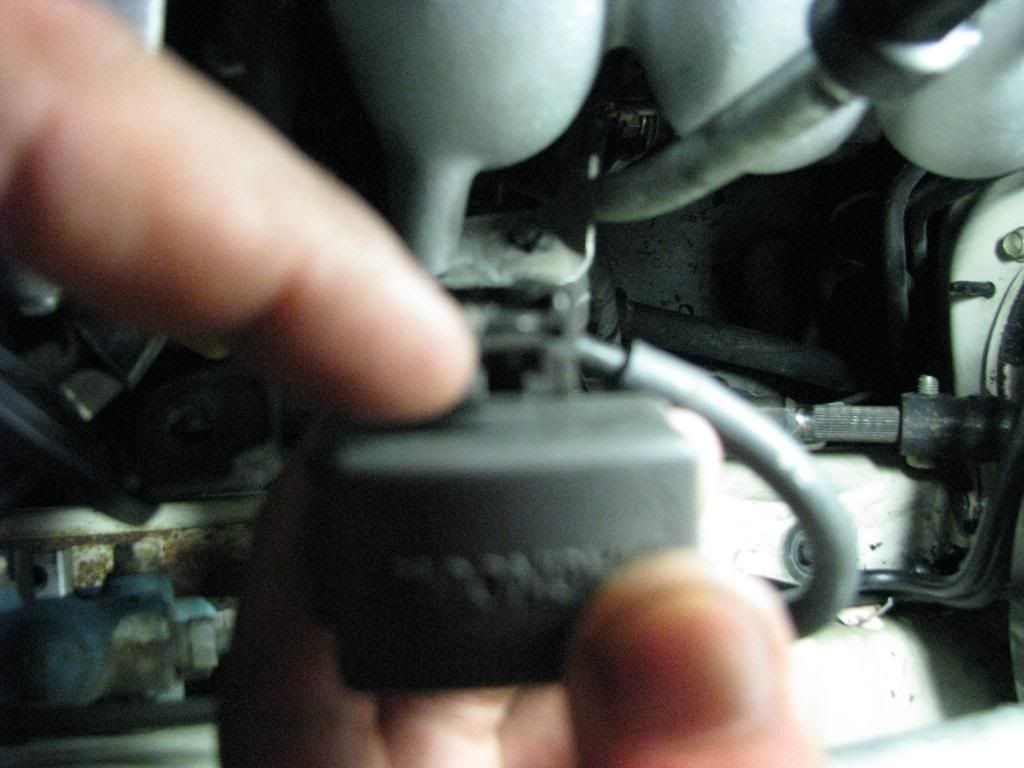

In cases like this, I've run the tach signal from the check connector and it has always worked form me. Open the check connector cover and you will see the tach signal and run the wire from it. IG1 Pin.

Hey...It worked!
IG1 pin from the check box 'gave life' to the tachometer.
Thanks
