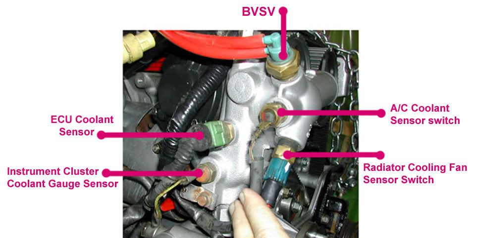

I have the picture of the t-stat housing with all the sensors labeled... is there a picture that has the thread specs of each sensor labeled?

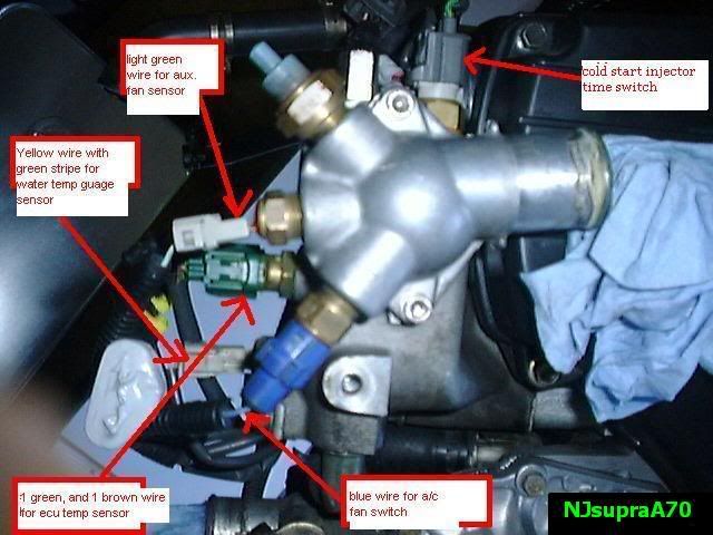

Here are the two diagrams I know of.... Now how can I find the thread patterns for each of the sensors?

Take the sensors out, go to HomeDepot or Lowes and use thier bolt sizer board... I want to say the bigger ones are 14X1.5 or 1.25 and the smaller ones are 12X1.25, but I'd double check that...

And the tapered ones are 3/8 BSP
The port for the CS Timer s/w is 16x1.5mm

Confirmed, the 3 on the kuckle are all the same - 3/8"
And to add, somewhat related - the CT26 coolant outlet on top is 1/4", bottom line is 14 X 1.50 (not on thermo housing).
Question - what is the best material to use for plugging? Thinking brass with aluminum....
Question - where is the best place to buy these? I know Napa and Ace hardware have them but maybe Summit Racing or others have nicer ones?
