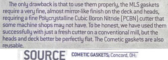

JT87NA said:
Head is more important than the block, I also believe it is a 25 ra for an HKS or similar MHG and 50 ra for the Cometic. Just make sure the block is clean without high or low spots, head should be like a babies ass, like Shaeff likes.
According to this article, both surfaces should be smooth.
Any reason why you would think that the block doesn't need to be as smooth?
I would think that the aluminum head would be more forgiving because it is made of a softer metal. Interesting that you would say the opposite.
