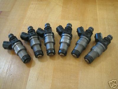

I was wanting to know where to find the part numbers on the injectors that came off my 7mge. and how to tell the difference between the high and low impedence(is there a color difference or something). And how can you tell if the injectors are bad(like the ohm resistance or what and what the factory ohm resistence should be).

For a N/A 7MGE Low Impedance is Yellow, High Impedance is green.
For Turbo 7MGTE they are black and only came low impedance.
Checking the Ohm only tells you if the coil is in spec. You will need to remove them and send them to a cleaning company to be cleaned and flow tested. That is not causing your problem, if it was a bad injector it would have a misfire.

well devin on may way to work last night i was sitting at the stop light and my car stalled out and died and i went to the gas station and while i was there (and at home earlier that day) i popped the hood to make sure all my hose clamps for the new line were still all good and i didnt have any gas leakage i could smell gas coming from under the hood. and when i started back up in the parking lot when it was idling at like 1100 rpm i noticed that it would drop down to 900-1000rpm. like it has a misfire. I posted this on my other thread but never got any replys back. and i kinda thought it made sense because of turning the fuel pressure to 40 and then when you go to give it gas it acted like it was being fuel starved and would die resulting me to turn it back up to 45 and it would run good just rich. i guess what i could do is take the intake mani and fuel rail off with the injectors still contected to and then try cranking it to see the injectors spray???? and if its not a cone than i know something is up. Would that work as far as a flow test?????

No that wont work. How are you going to hold the 6 injectors in the fuel rail without the pressure blowing them out. I doubt its an injector problem lets just say that

not really no. that will show that they spray, if they dont go flying off the rail, its only a o ring and being trapped by the rail that holds them in place. ours arnt attached to the manifold, the injector sits in the head above the manifold.
a flow test is to see if they are indeed flowing the spec cc/min rate. (yellow is 295, the greens are 315 cc/min)
though if you do remove them, buy new injector orings, as there pretty much a one use only.
