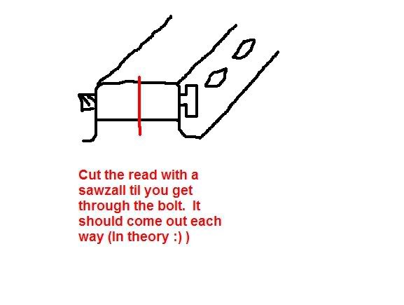

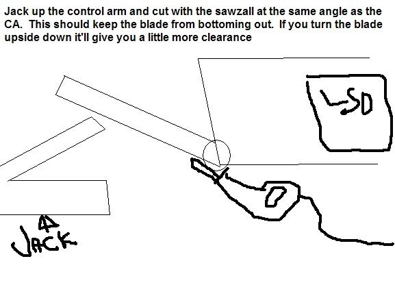

See the two hanging parts?
The bolts are rusted or stuck in the metal sleeves that are in the rubber bushings. Nothing so far that I have will move them...impact wrench, hammer, stuff like that. The rubber takes up a lot of the shock from however I hit it.
Both sides really suck right now.
I'm getting new bolts. The hammering and the start of a cut with the recip has destroyed them. No biggie, but they are not out yet.
The recip wants to wander into the bracket I need, so for now I'm done with that.
If anybody has a trick, I am open to it, otherwise I'm just getting the torch.
thanks
