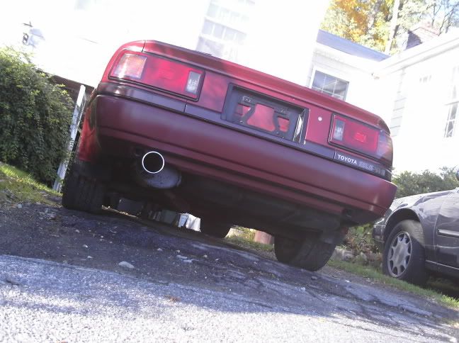

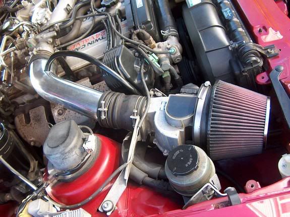

Heres my non-turbo intake/exhaust set up!
Just disregard everything else in that pic. Dirty and rusty! Much better/polished now!

Whats that line running to the polished pipe for your intake?

LOL- that small muffler is the "cat".
Im not sure what you originaly thought was a cat, but that may be the headers...
And that line from my intake is a vacume line.
