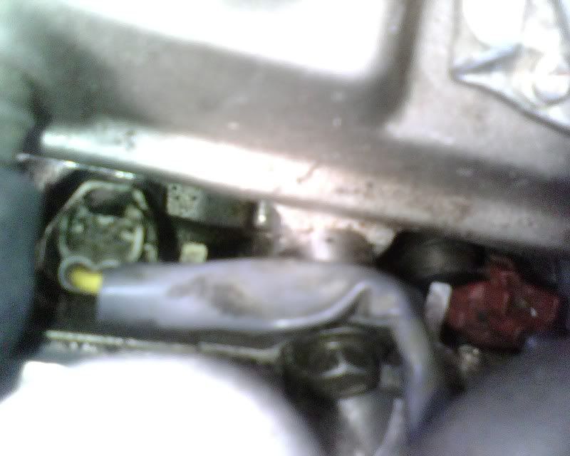

I was wondering what the stock colour of the Injector clips were on the 7MGTE's. I heard it could help me figure out if my injectors have been upgraded or not. Help would be great thanks.
the fuel injectors clips are grey and brown from ND. The bosch EV1 are black.
The Denso fuel injector clips looks very similiar (save color) to the Bosch EV1 injector clips. I would say that if your wiring is WHITE for all the injectors. They have been upgraded. I don't know of anyone that has bought the Bosch EV1 injecotr clips and pins and integrated them to the stock harness.
