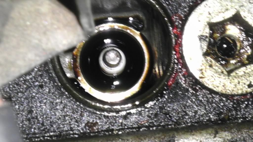

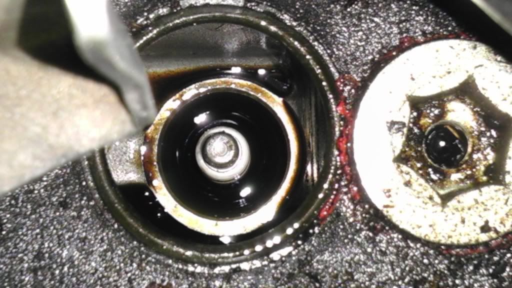

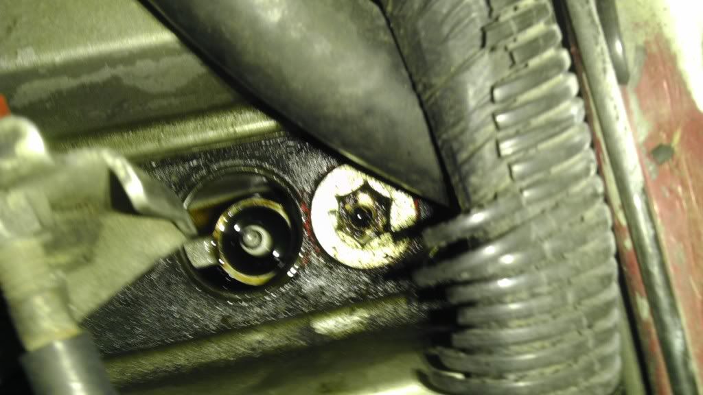

Could this be my problem lol. this is my #6 cylinder with the plug still in it

wow lol
gotta love the 7m valve cover gaskets lol
im suprised it wasnt sputtering real bad and misfiring
deffinetly suck up the oil, change plugs, change wires and replaced valve cover gaskets
allthough i dont think its going to cause the issue you having
im sure somebody in your town with a turbo car has a boost leak tester
but the above pictures is just typical maintenence lol
---------- Post added at 11:15 PM ---------- Previous post was at 11:14 PM ----------
just read you sig info
have you tuned the safc yet?
after finding/fixing boost/vaccum leaks and fixing valve cover gaskets i would try to tune with safc(if it hasnt been tuned yet)

But is it possible the oil could get through the threads and down onto the plug and be burning off the oil.

the odds of oil seeping down past the gasket and past threads is slim to none
think about it
you have 150psi compression
if oil is able to seep down(with no pressure applied) then cylinder compression would surely leak past the gasket and threads as well(causing low compression)
from the sound of your engine you dont have a bent valve
bent valve will cause a misfire/horrible engine performance/smoking bad
when you did the compression test then a cylinder with a bent valve will have no compression(depending on how bad its bent) or will have good pressure but will leak off fast

Even after trying to soak it up first, I don't think you'd get everything and you very well could have just had it on the threads when taking it out from residual leftovers. I'd be more concerned if it came down past the threads and on to the end.
