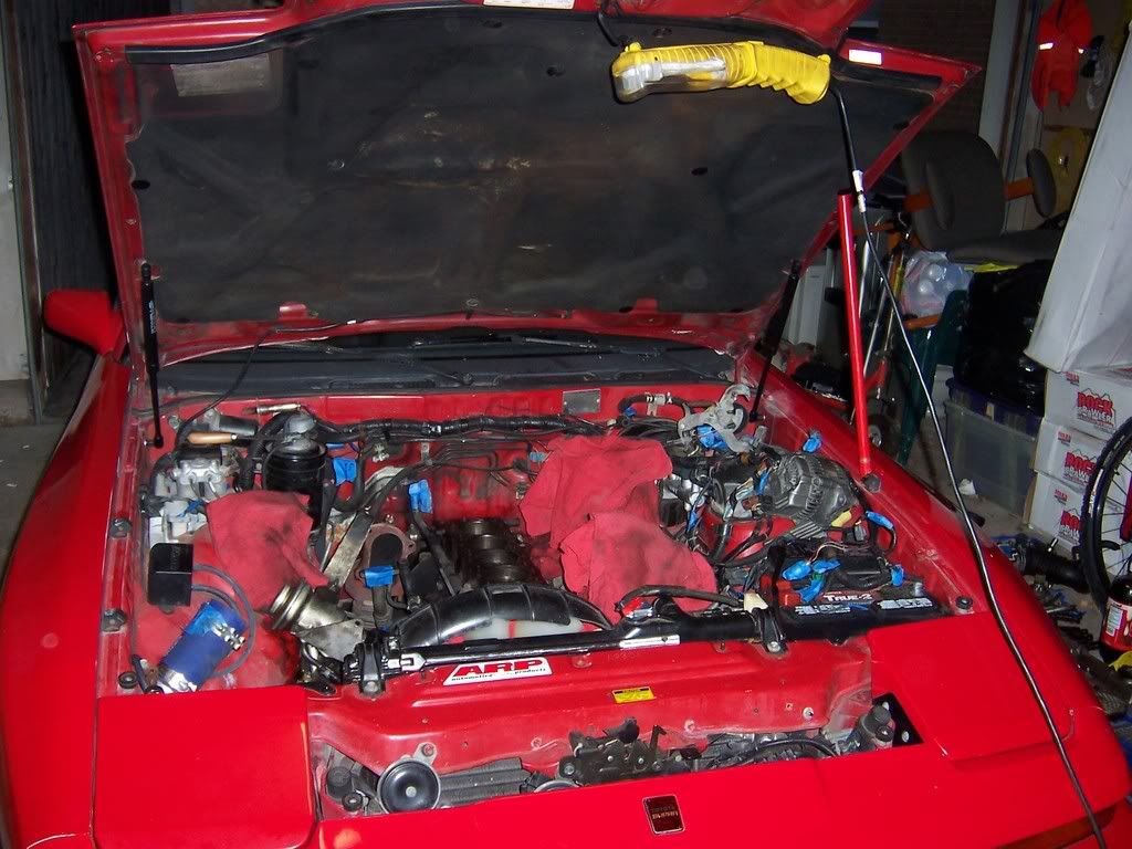

And the engine bay.

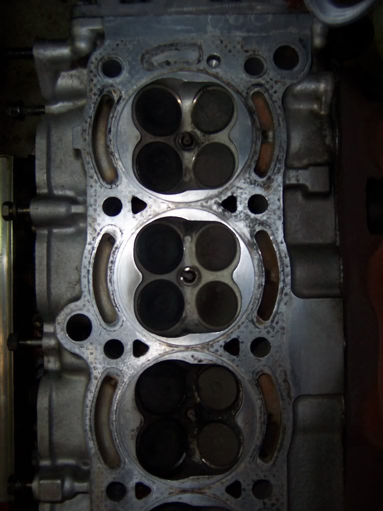

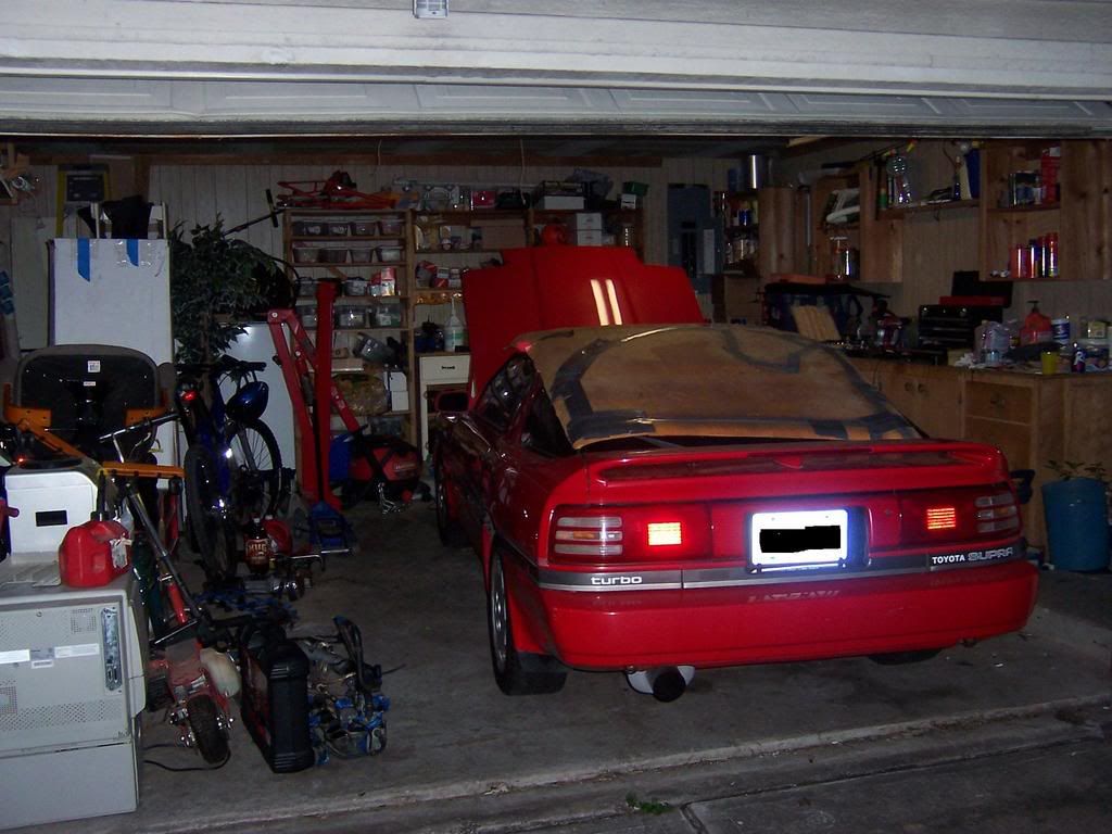

So, after i had the car for 5 days I started having BHG symptoms. I was in BHG denial for the first day, but after a while i tested it in a way that theWeezl told me would sufficiently test it and i was sure i had a BHG.
It sat for a good 2-3 days and i then decided that i would get started on fixing it.

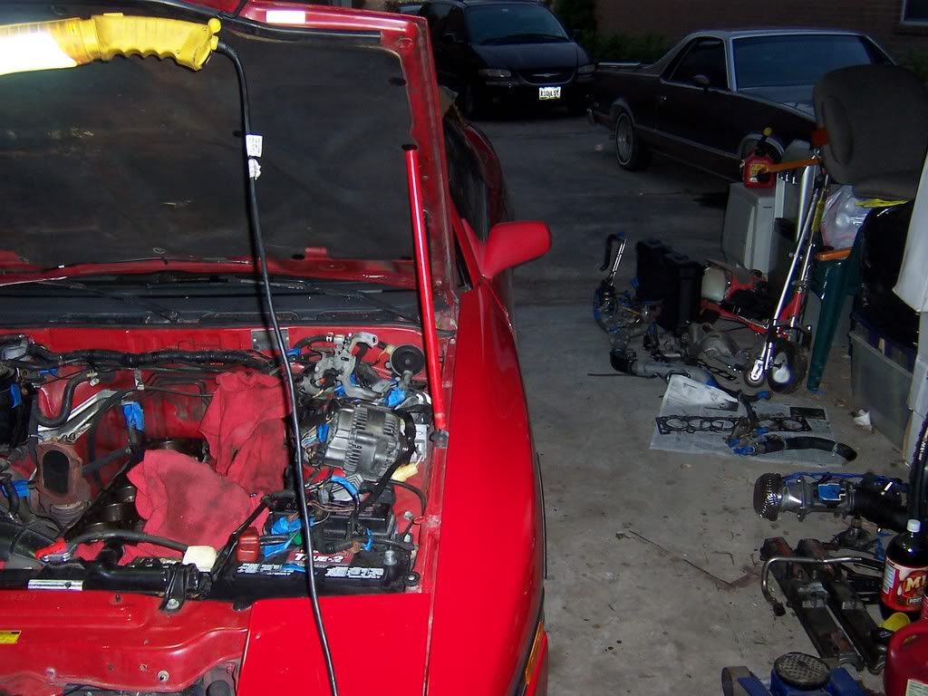

While it was sitting for 2-3 days i figured i would fix my BOV problem as it just didn't work right and it was most likely slowly killing the turbo. When i got the car the BOV didn't have a flange for the vacuum fitting on it. So i got a friend of mine to drill out the hole and get a piece of a brake line to fit it.

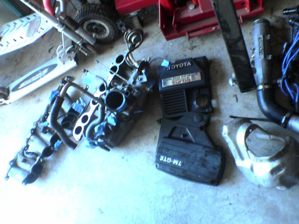

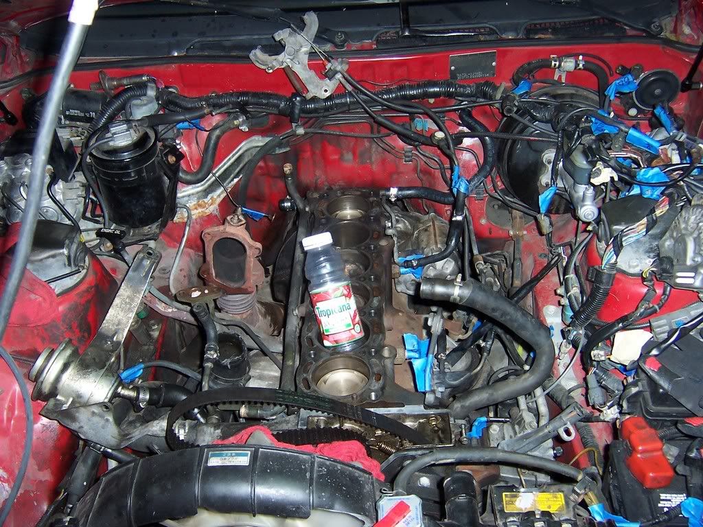

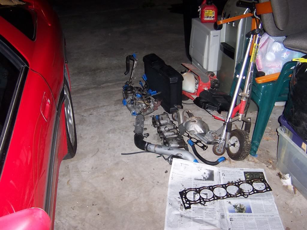

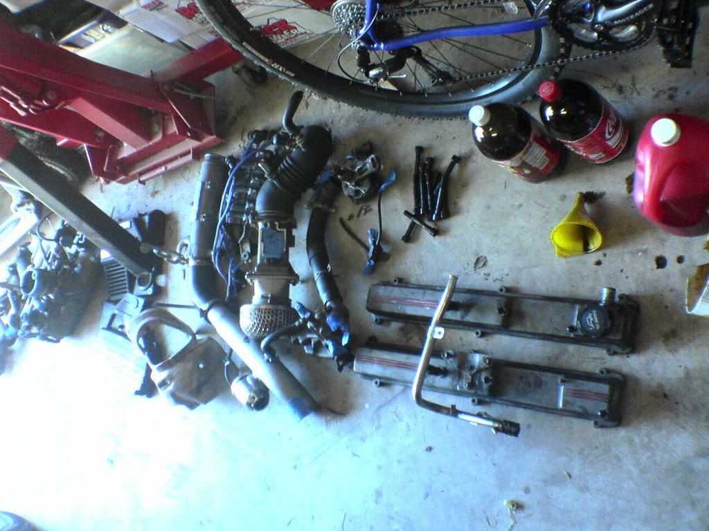

After i had fixed the BOV i decided that id get started on disassembling the engine to get to the head gasket.

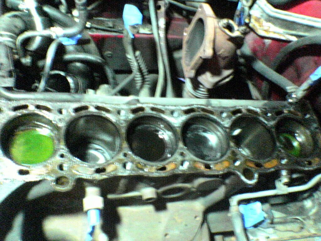

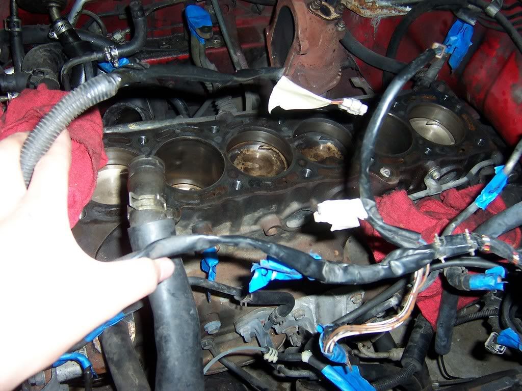

This is where i was at after a day of work. Started at 11am went on until 8:30pm. Drained oil and this is what it looked like.

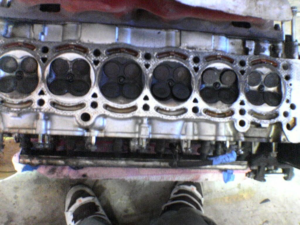

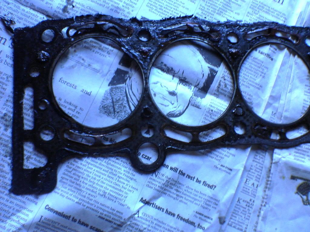

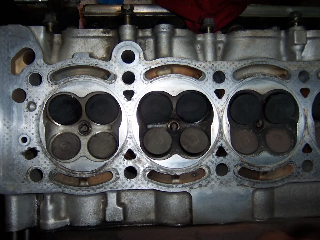

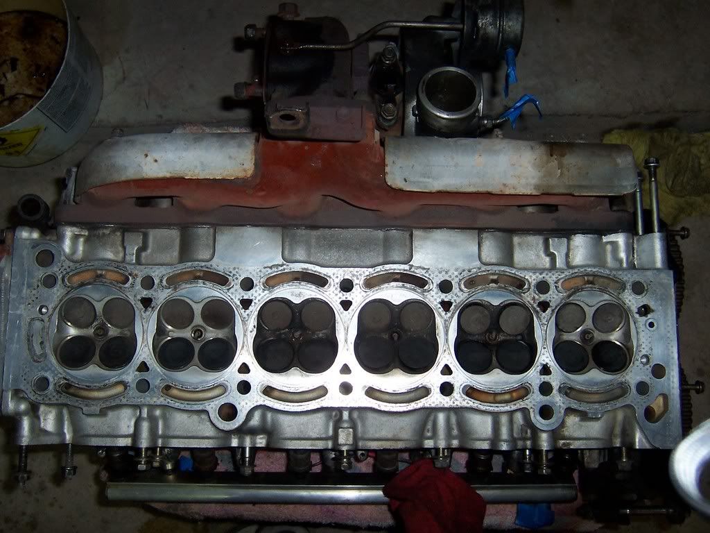

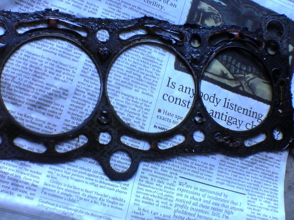

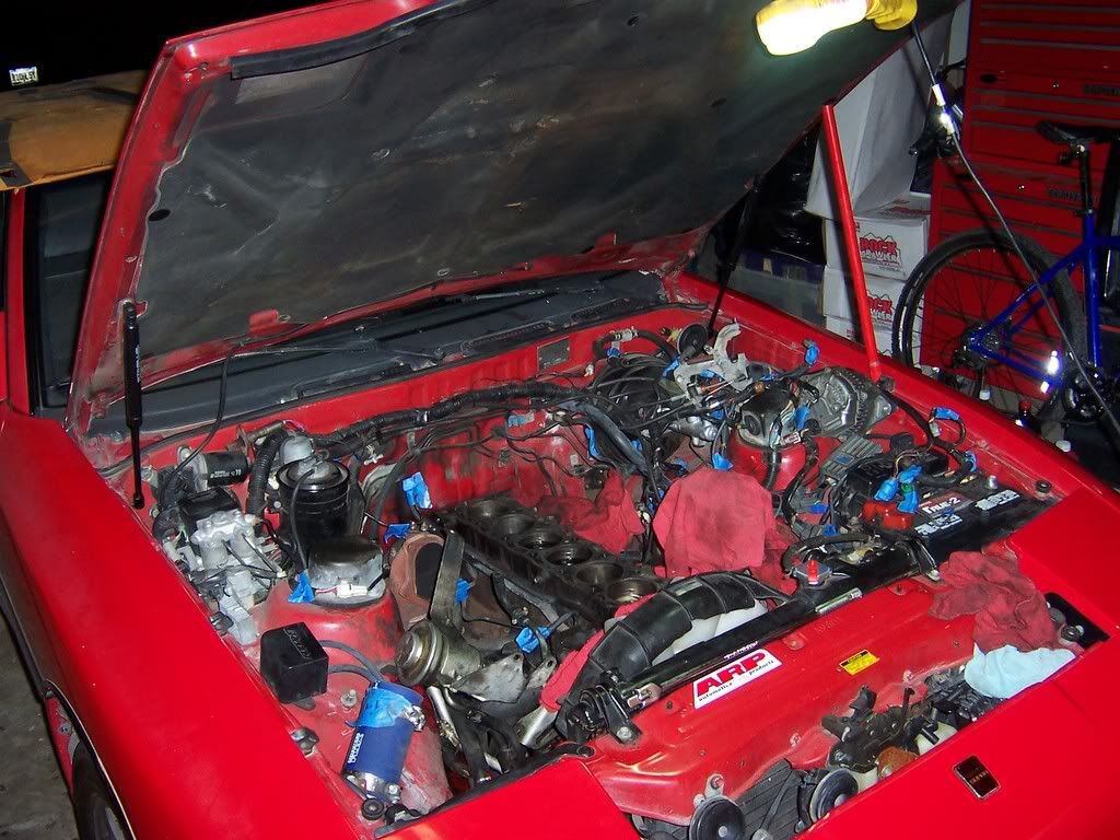

The next morning i kept working and got to this after about an hour or two. Heh, guess which ones blew.

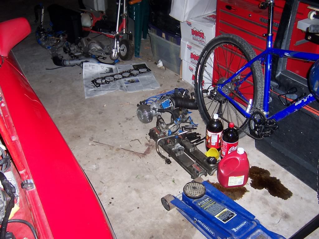

So i set off cleaning parts (head and block) for the headgasket, also kept in touch with my friends. lol dad took this picture

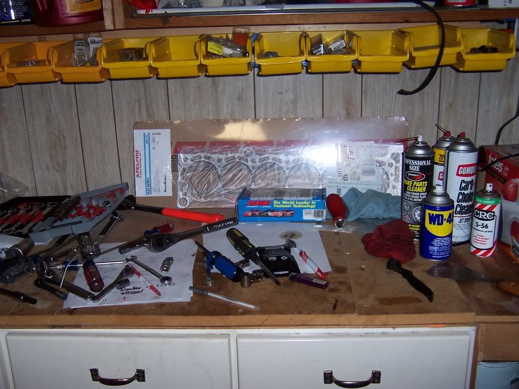

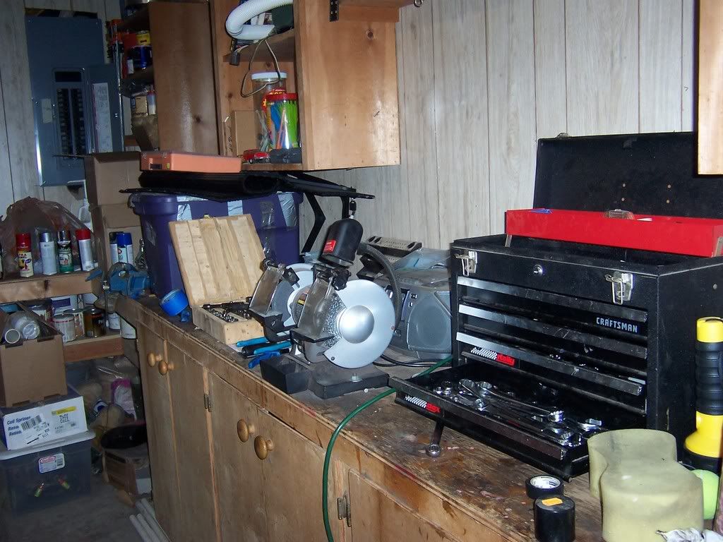

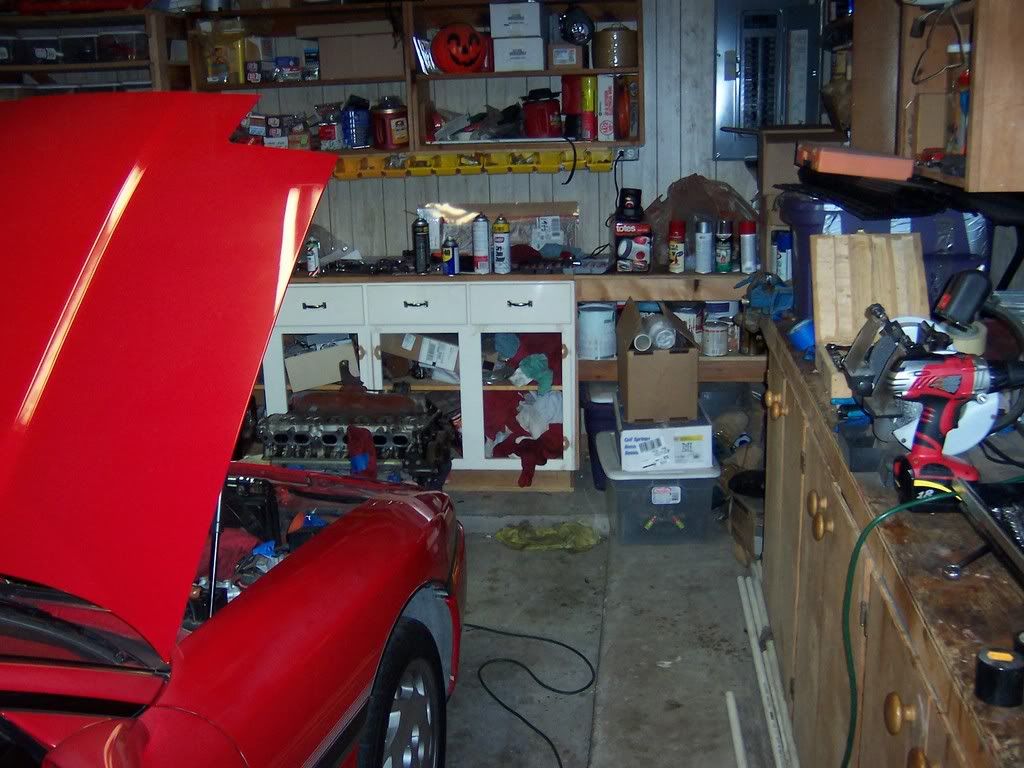

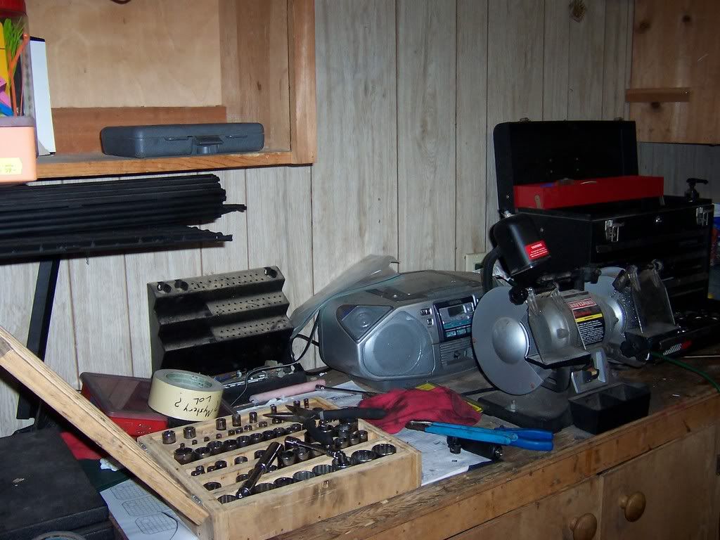

And here is what my workspace looks like.

Heres my progress today!

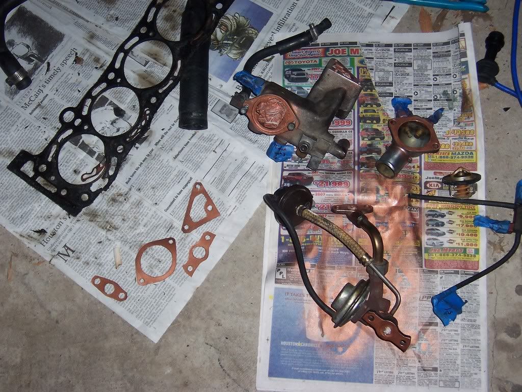

First i got my heat working, i had a JDM coolant rail so the heater core return line was on the wrong side of the engine, but the USDM one was still there just blocked.. So i went to weezls house and got it drilled out and had him show me how to make a few gaskets and scored some gasket material from him as well.
Heat is gonna work now! woot!!
Made my car a 3.45L
This is what i got to today, ARPs are in just need to be torqued down.
Here are some of the gaskets that are ready. I made them out of some gasket material.
