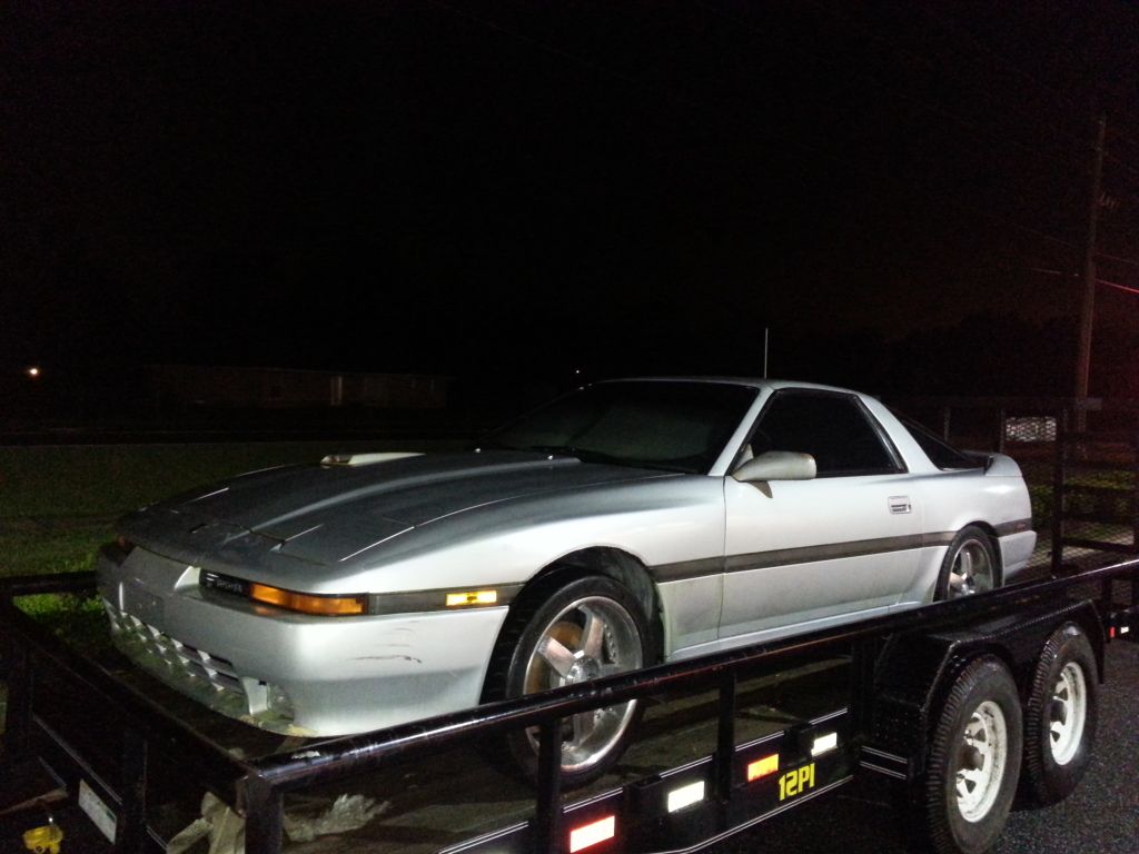

So my daily got in accident a week ago and I decided to pick this beaut up !!!! :)
1990 I believe it is a white package car. Hardtop turbo 5 speed! No31 car for 1990.
It looks cleaner than it is in that pic but slowly I will begin to clean it up to make a nice daily driver!

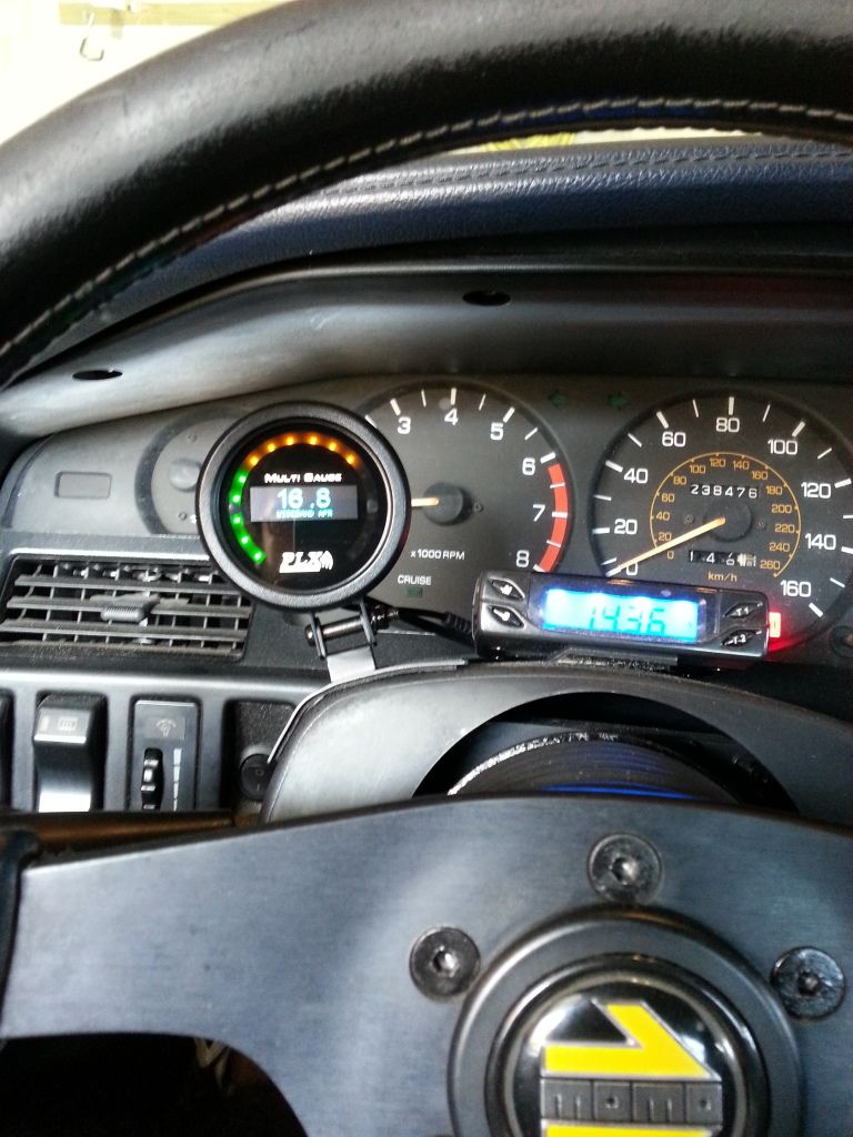

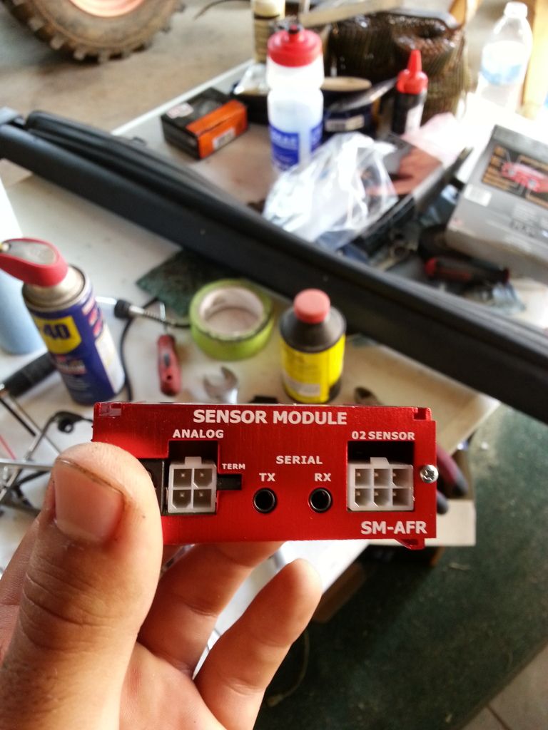

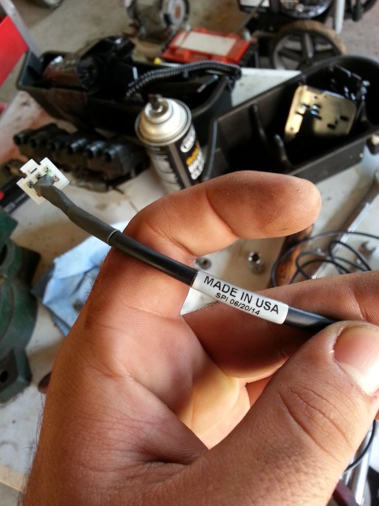

Then I installed the PLX Wideband. I swear I feel like I've done this before.....LOL
Made in the good ol' USA PLX FTW
I know its idling really lean. I did some diagnosing and realized that the AFR's were only bad when the ecu was in open loop. So that pretty much told me it was the o2 sensor. The PLX happens to have a 0 to 1 volt output. So i wired that output into the stock 7mgte computer and it runs quite nicely I must say! idles and cruises right around 15.5 :1

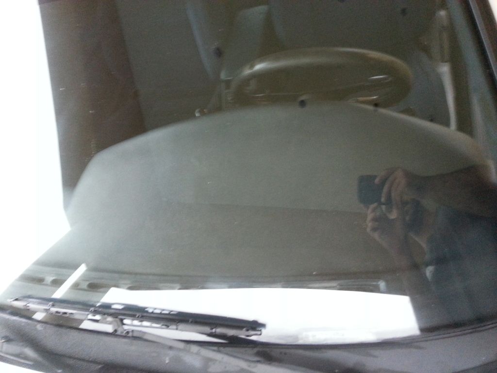

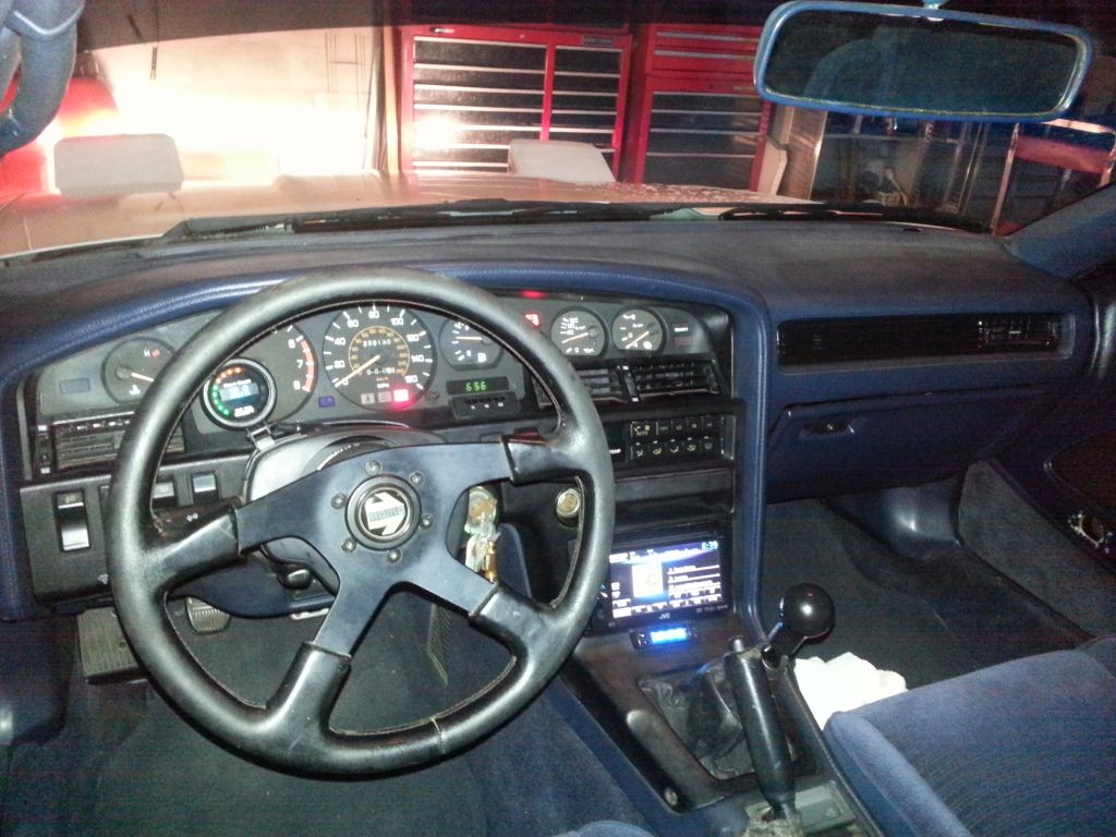

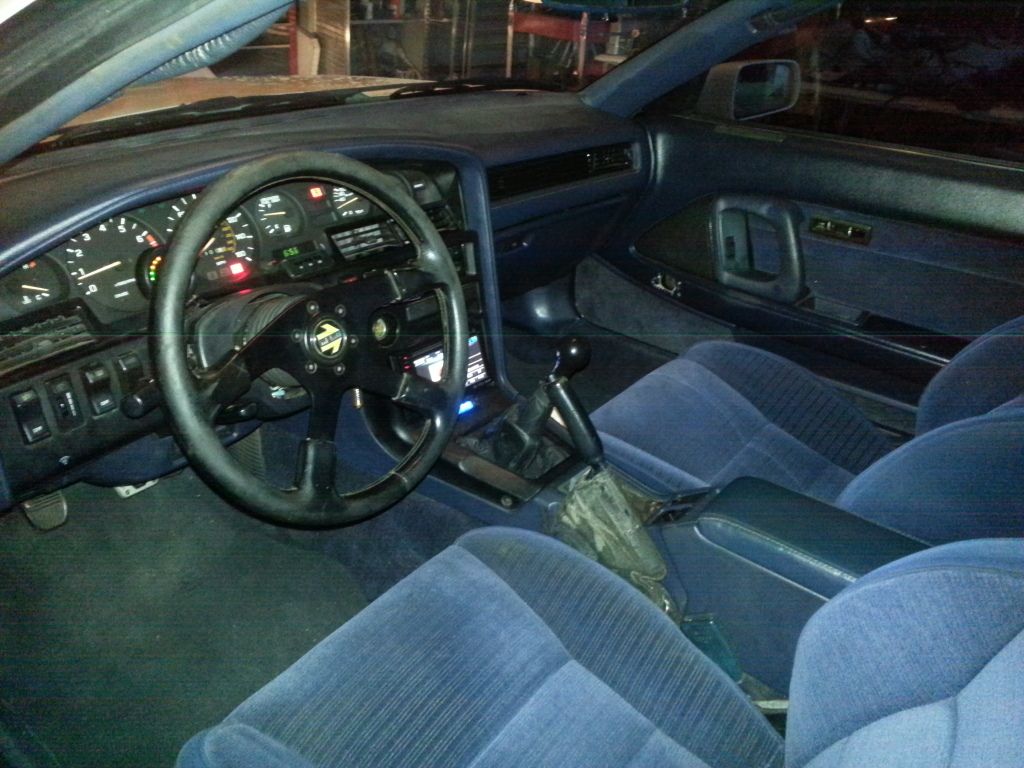

Well update as of lately I picked a really clean dash! Here are some before and after pics!!
Im getting pretty happy with the interior. I feel like all I need now is both door panels, ebrake boot, both a pillar plastics, have the turbo a wheel recovered, and an ash tray for the interior to be spot on. Im pretty excited thus far ! :)

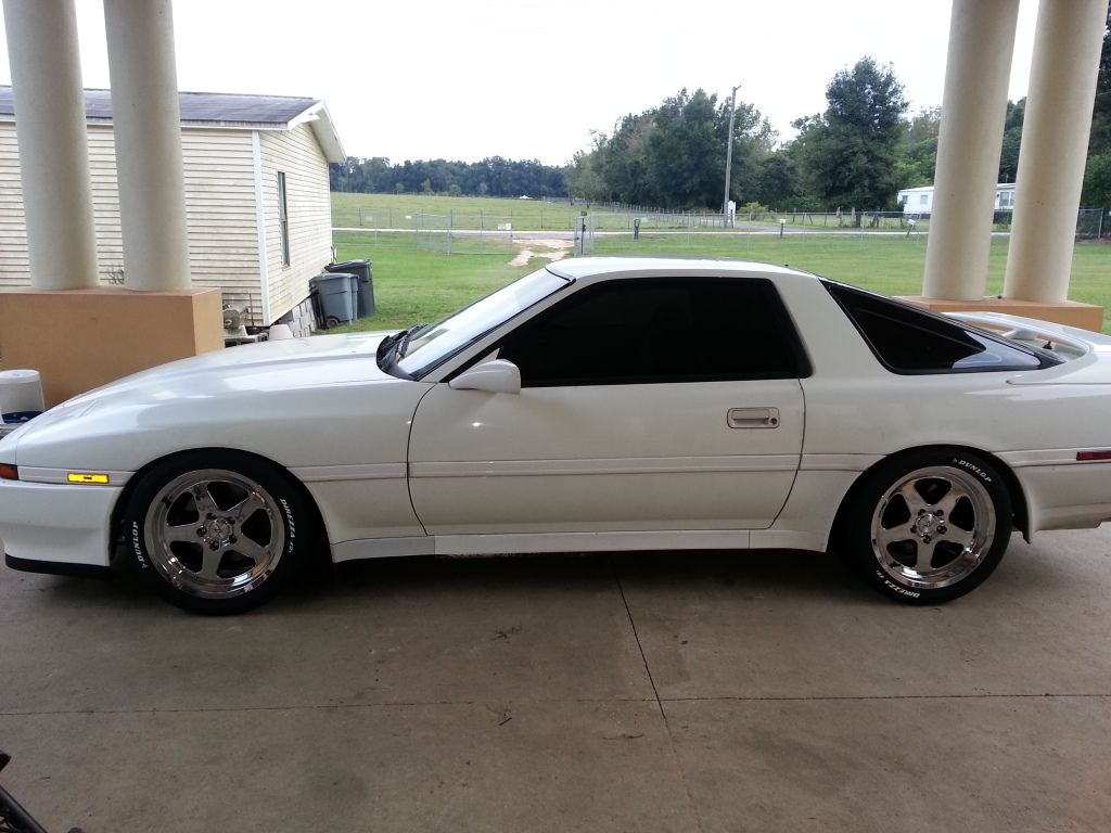

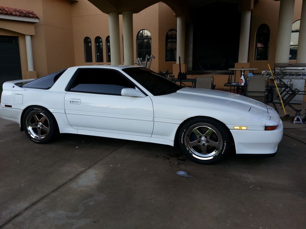

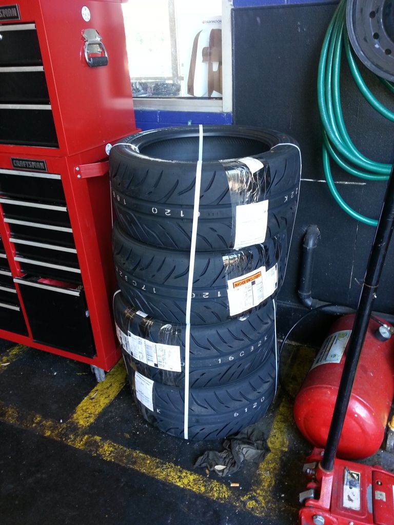

DeMoN2318;2027463 said:
What tires are those?
Dunlop Direzza Z2 Star Specs
Bogwon;2027470 said:
Nice project and welcome back sir!
Thank You!

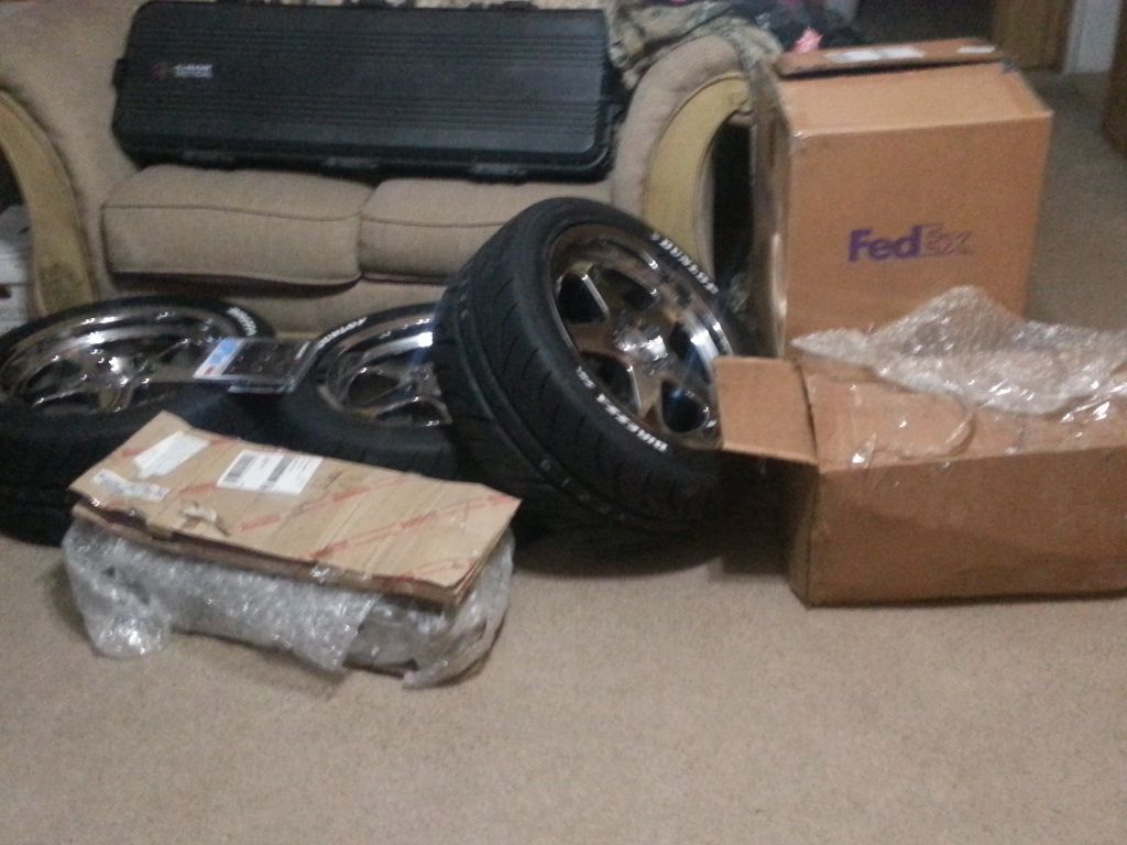

slowma70;2027481 said:
looks real nice.. Wanna share some wheel specs..?
Thank You
Wheels are Saleen SC Reps 17x9 +22 with 1/4" spacer all the way around :)
Tires are Dunlop Direzza Z2 star specs 255/40/17 All the way around
maxburn;2027482 said:
Tires look like direzza z2s
Yes!
DeMoN2318;2027502 said:
Yea I think you are right.
Cool looking tires! wish they offered wider sizes though
Lol although i dont buy tires for the look yes they look very aggressive
And its meant to be more of a autocross time attack tire so i think that is their reasoning on the smaller sizes. Although they get very wide in 18's!!!
