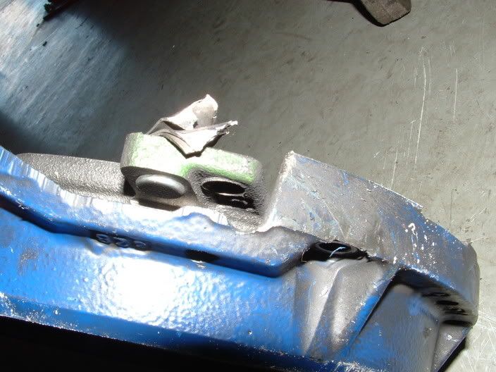

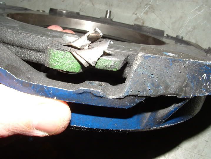

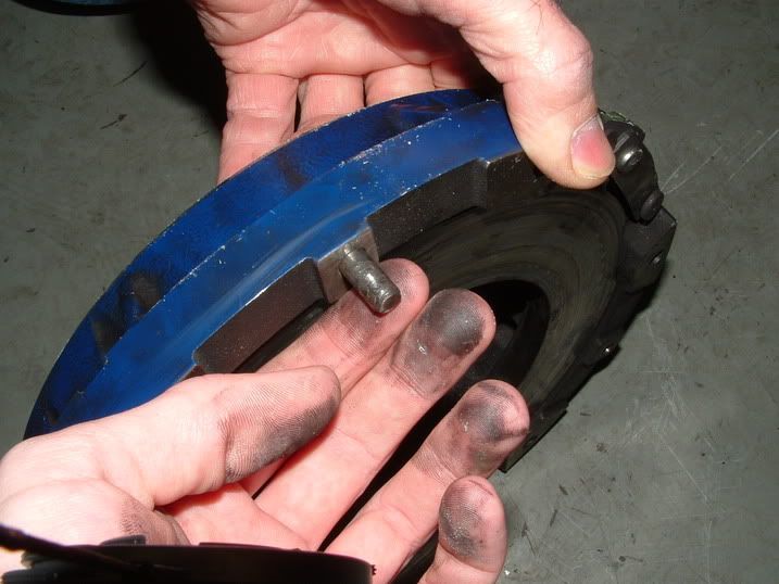

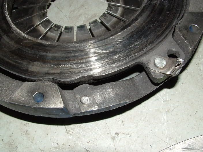

I bought one a while back, worked well, it would slip every once in a while if the turbo was still spooled after a shift. I hit a big pothole one day and it broke 3 days later. The guidepins on the diaphragm (pressure plate) broke, all of them. Then one of the metal straps broke and the diaphragm got off center and the car started shaking like hell.

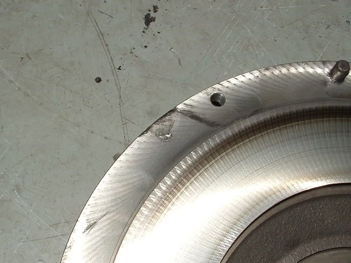

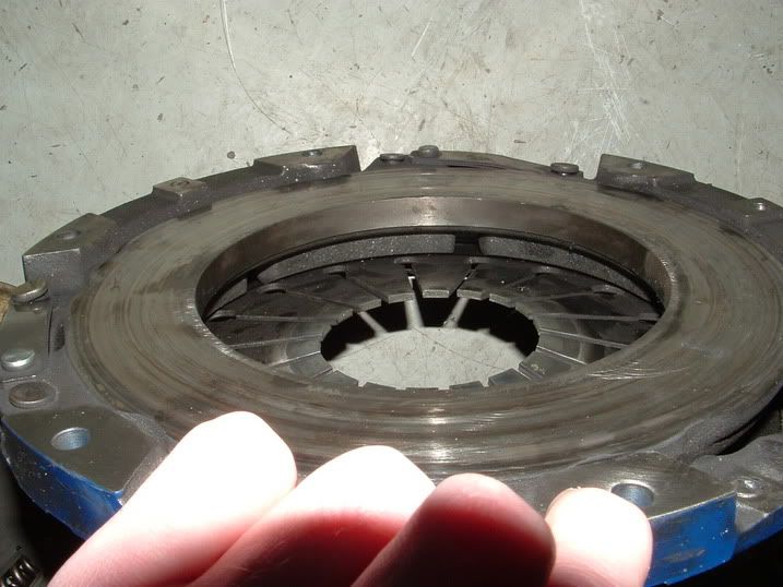

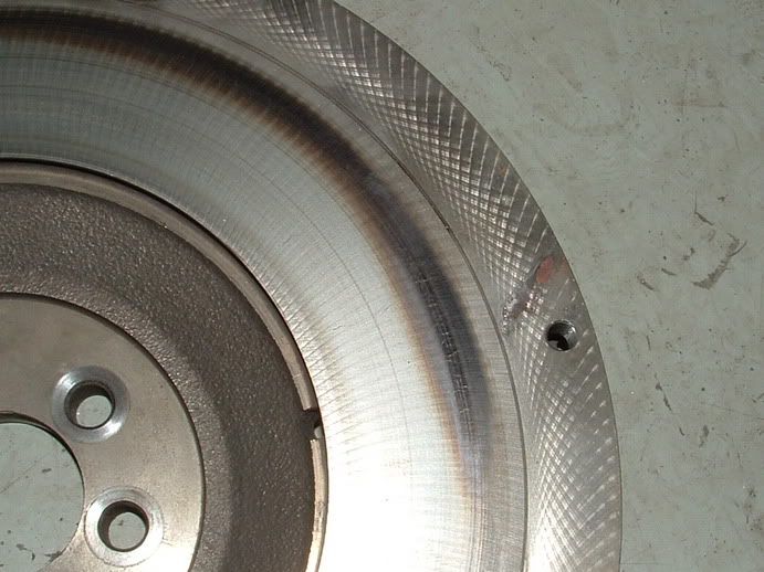

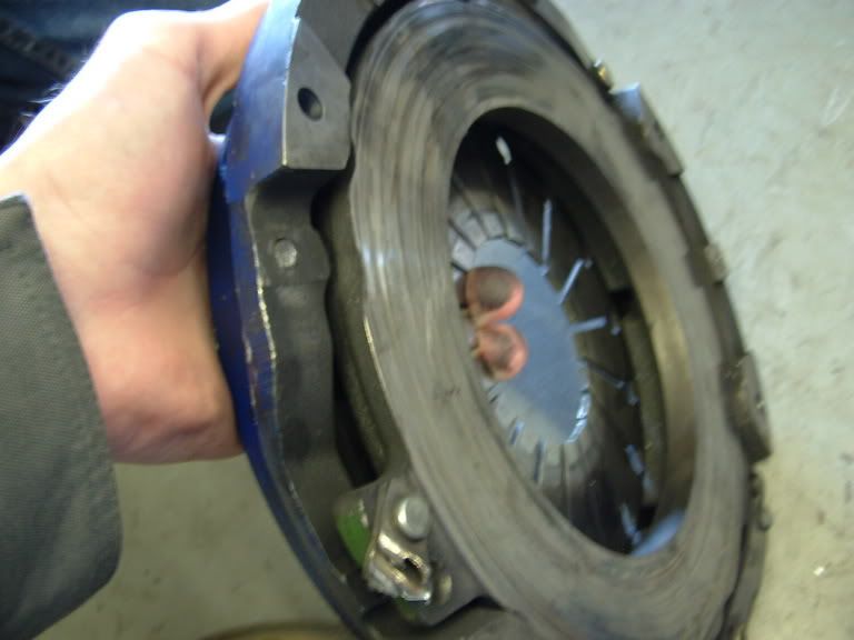

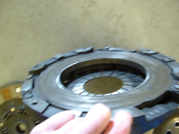

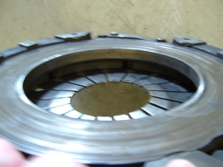

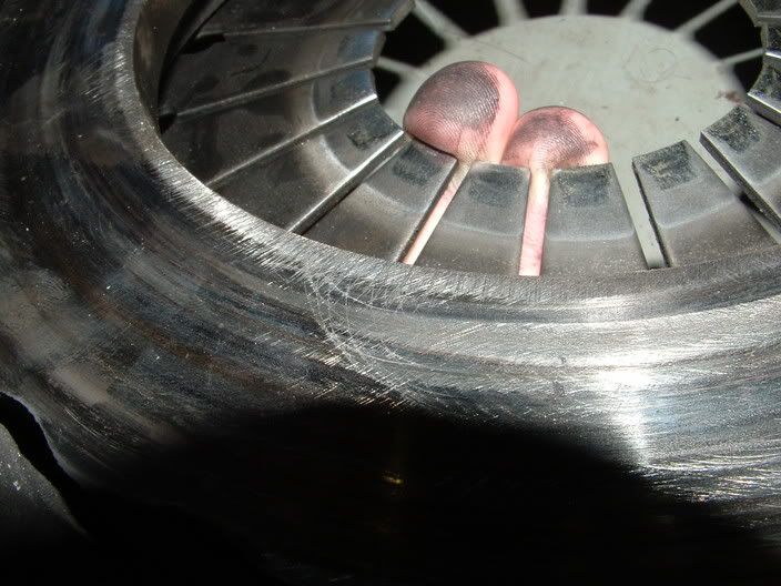

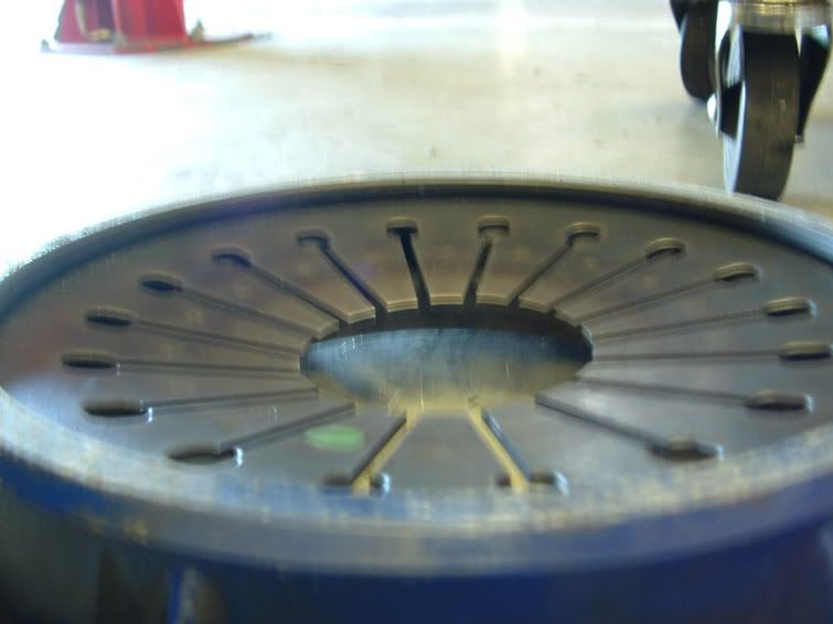

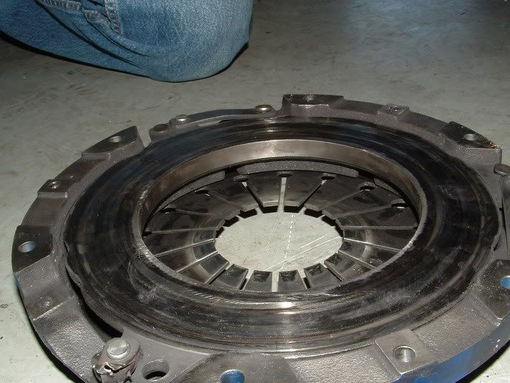

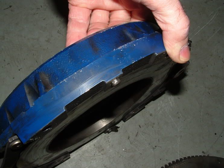

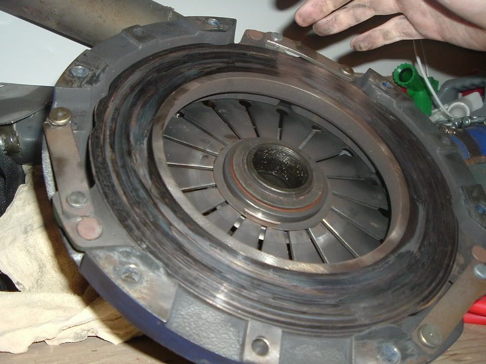

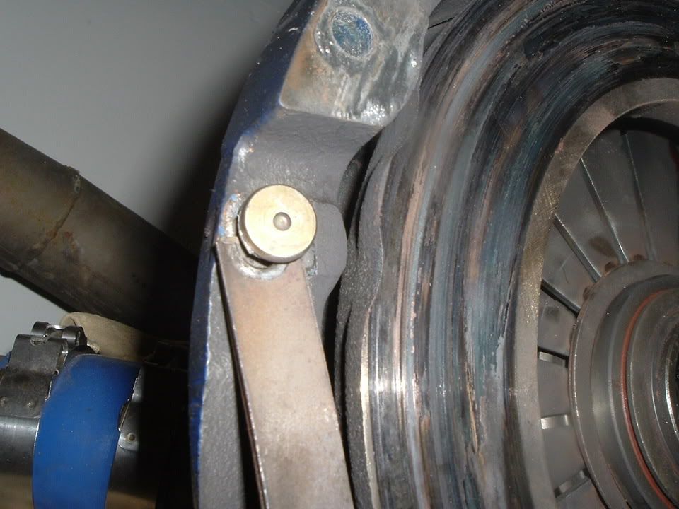

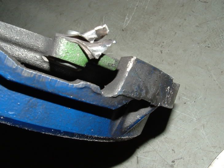

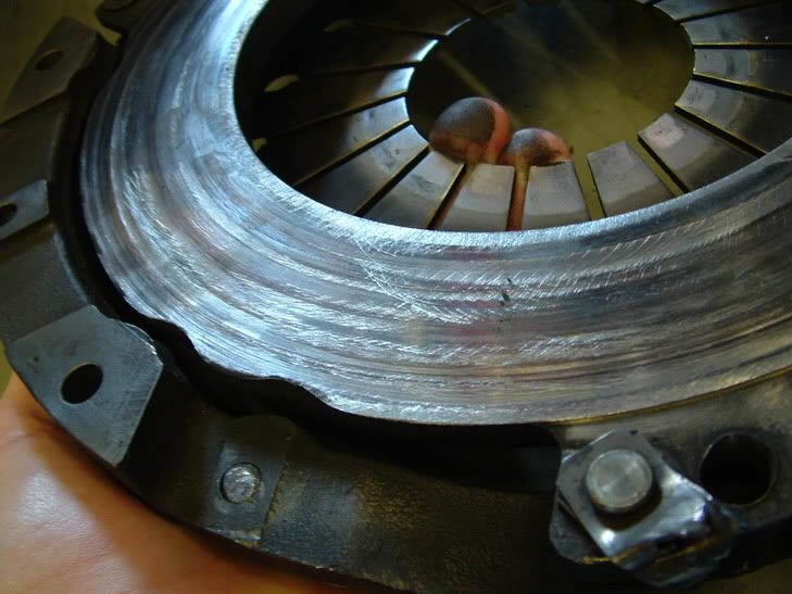

Here are my pictures.
And yes they put in a new oil seal for the trans input. But they reused a previously damaged pressure plate that they said they "checked out".:nono:
If you look closely, you can see tool marks from a hand tool that they used to resurface the pressure plate.
Clickable thumbnails
