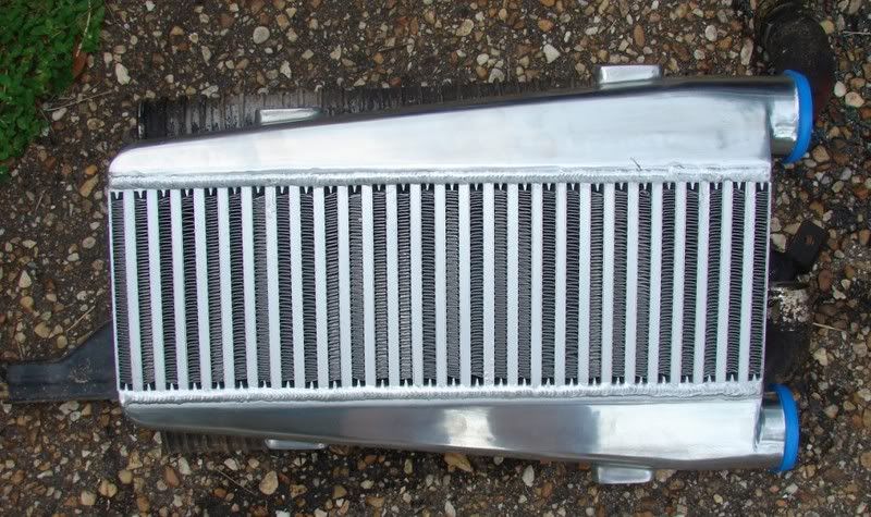

The larger Spearco I got from DM was not the biggest they have. He had one bigger, but said this one was more efficient. It is about the same size as a stock cooler, only thicker and much more efficient than stock. I did not have to relocate my oil cooler at all.
Here is is pictured on top of a stock cooler.

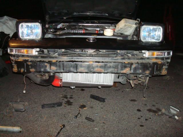

that's what i'm running If you have an 89+ there is a little bit of piping to do but nothing major, very good upgrade!
you can see the oil cooler in that pic
Behind the bumper
