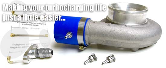

http://www.atpturbo.com/
Its right off the main page.

That hose fitting is interesting, but not my style. It looks like it would fail in a few years at best.
