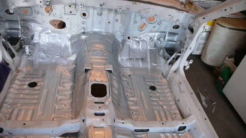

To fix squeaks and rattles, use adhesive foam tape (weatherstripping). If you are looking to soundproof the car (from outside noises) go for a good butyl sound deadening product (I used elemental designs edead - dynamat is overpriced and overrated)

It is 3 layers thick on the floor (it conforms extremely well)...Judging by the knock test, it is significantly better than the old sound deadening. As for when driving, the car is still disassembled, so no dice on that yet.

45 mils is the specified thickness. From what I've been told by people that have used similar products, there is a significant improvement in heat insulation as well.
