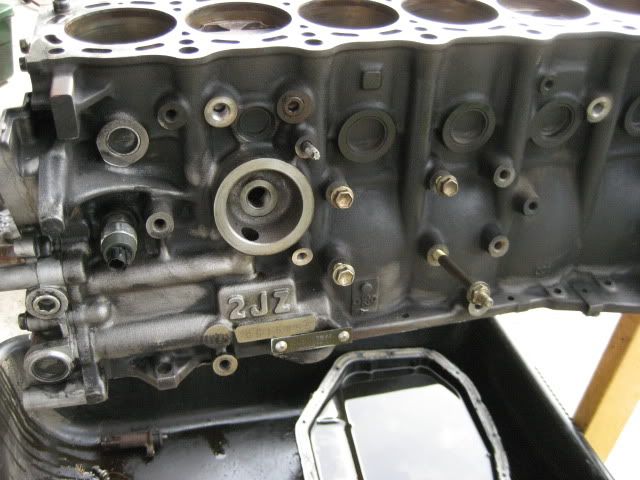

Someone help me identify this on a 97 GE Block
eyesoarer6
Oct 29, 2010
65
Westside
Is the bolt with the nipple below it that Im pointing to in the pic a coolant line or a oil line? Is it a feed or return? Im going to run stock twins and need to tap it in somewhere.

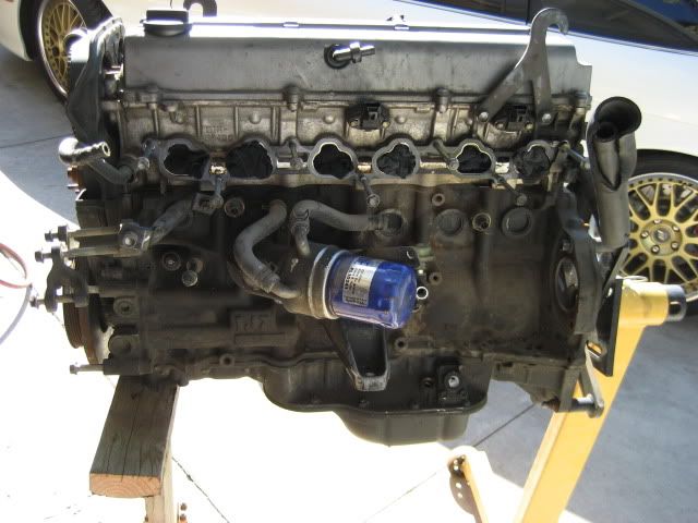

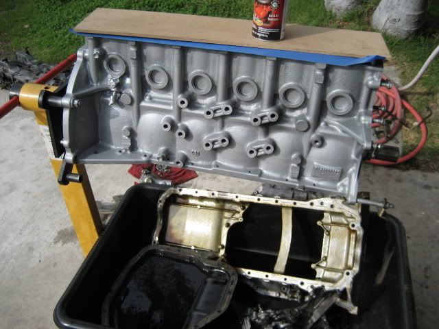

Yeah, Im going 1.5jz and the GE head was on there just to keep the cylinders from getting contaminated. Someone gimme ideas on running my oil lines, please. I also have a question about the oil filter housing on the 1J, one line is coming from the turbos and the other line was going into the GTEs block(pic below). Where can I run this to, where do I run it from? Looks to me that there coolant lines?

stick to the nonturbo parts with respect to the oil filter housing and run a sandwich plate for your oil feed and any oil sensors you want to run.

Yeah those are coolant lines through the oil housing. A ge block has them you just have to change a plug with the pipe. For oil I just tee off from the oil pressure sensor port with a -4an. The threads in the block are 1/8 bspt which is easy to adapt then run a line right around the front of the motor.

yes it is. On GE theres a plug in the block you can unscrew and put that return fitting in. I've done this many times. Are you saying your GE doesn't have that?

oh it looks like you have the newer type motor with the bigger threads in the oil sender. It's that one right in front of the oil filter with the one wire connector. They aren't 1/8 bspt like most toyota. I had one of these and iirc it was like 10x1.25. I was just saying go to hydro shop for getting lines and fitting stuff.
But yeah measure those threads. And it looks like in the pic the allen plug for the other oil cooler line is still in the block?
