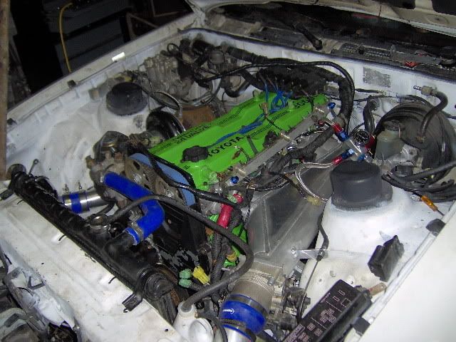

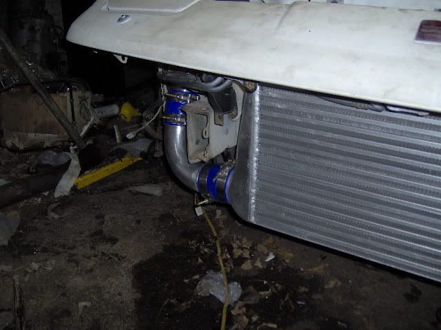

Some recent pics of my setup...
DavidBaustert
Nov 13, 2007
Dayton Ohio

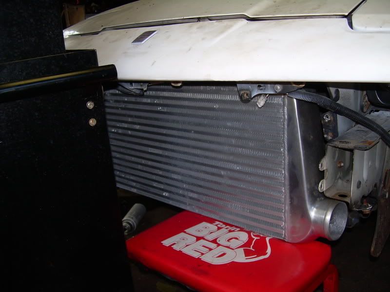

Thanks to Joel Stith for helping me with the charge piping and pulling the all nighters...
"Let me know whatcha think..." HAHAHA

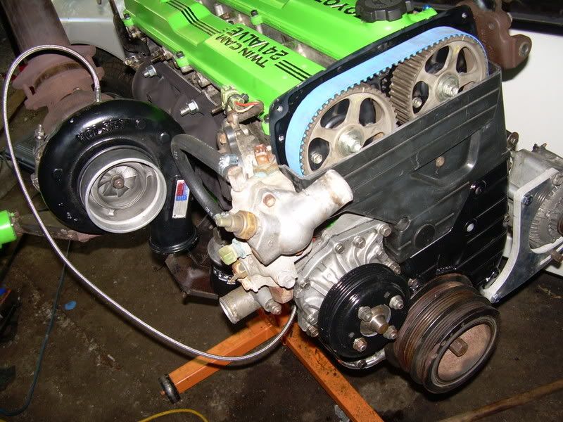

dan0311;1219099 said:

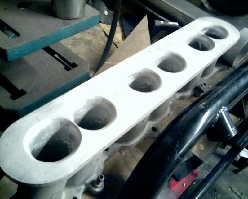

:aigo:where did you get that ffim?? i want one!!:aigo:

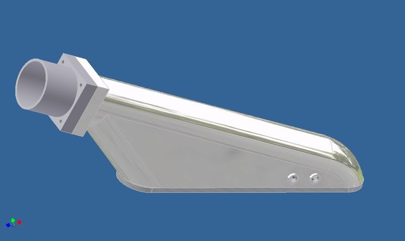

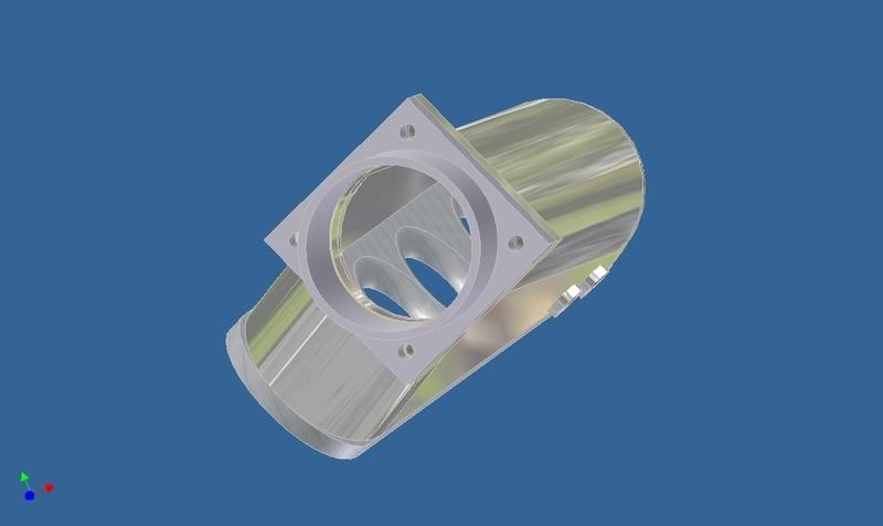

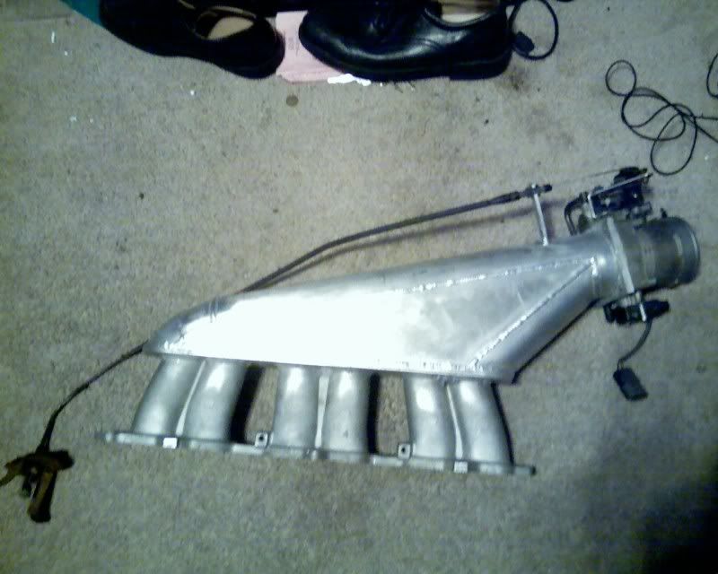

Made it... PM me if you want one...If I get 6-10 people seriously wanting some I'll make them cheap.
SupraDupra500;1219127 said:

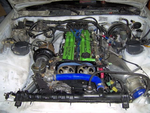

someone's using a holset turbo..... hehehe.. hx34 or hx40? and i assume you're using external waste gate?
WH1c...essentially the HX35 and no...internal. I bored the hole out to 32mm and machined down a big block exhaust valve for a flapper....cut the old one out and welded a washer onto the new one. Looks completely stock.

i meant the hx35.. i fat-fingered it.. haha.. that WH1C has a much bigger exhaust housing than the HX35 doesnt it? good idea on using the valve for a flapper.. i used an hx35 on my supra a few years back.. held 26psi nicely however without an external gate, that thing would not hold anything less than 26. it made TONS of power, no dyno but easily in the 450 rwhp range considering my clutch wouldnt hold rated at 510lb ft.. however the small exhaust housing caused egt's to climb too high and damaged my ring lands. ahh well.. very aggressive turbo. full boost came on violently.. hits very hard.. i liked it
also, can you send me a few more pics of your manifold? i'd like to see it in a little more detail. i'm currently working on my own, but yours looks great. and if it's a good price, i'll scrap my project and buy yours. also, what type of t-body?
PM me...what parts do you have done on yours?

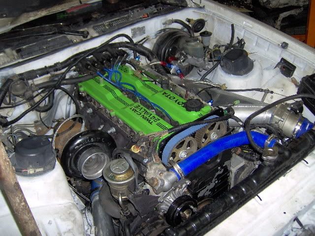

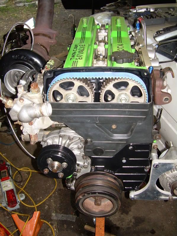

Still plan on PMing you.. ill probably do it tomorrow (sunday) when i can think more clearly.. kinda tired now.. heres some pics of my setup
and yea the ebay turbo i have on there was great.. and no the turbo was not on stock internals.. i rebuilt it myself. i can rebuild turbos very fast.. i rebuilt 2 ct26's one stock and one 60-1.. about 20 min to rebuild one.
keep in mind the setup i have in this pic is the old setup.. not very clean either.. had to finish it real quick because i had a bad wreck in my DD..

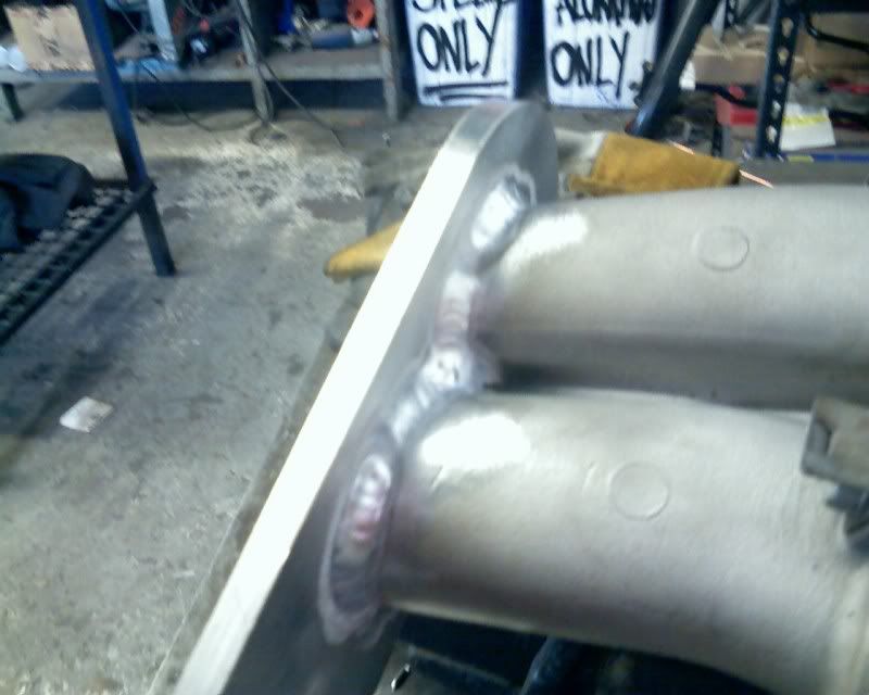

This pic is a test fit for the downpipe.. i hadn't ground the welds and wrapped it yet. 4" right off the back of the turbo!

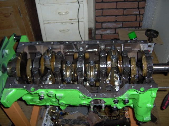

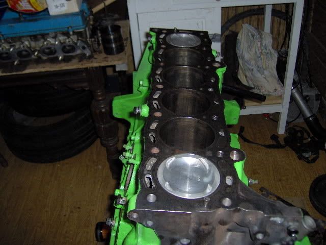

at least forged pistons.. stock rods can hold quite a bit of power.. depending on cost effectiveness i might go forged, but i might have the stockers x-rayed, shot peened, and cryo-treated. they should hold just about anything i throw at them then
