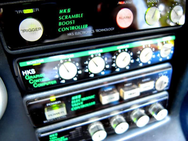

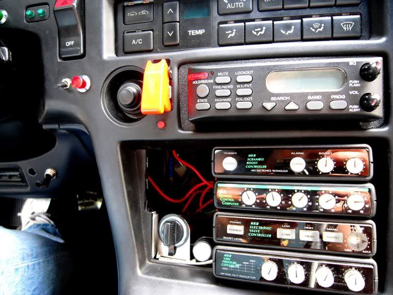

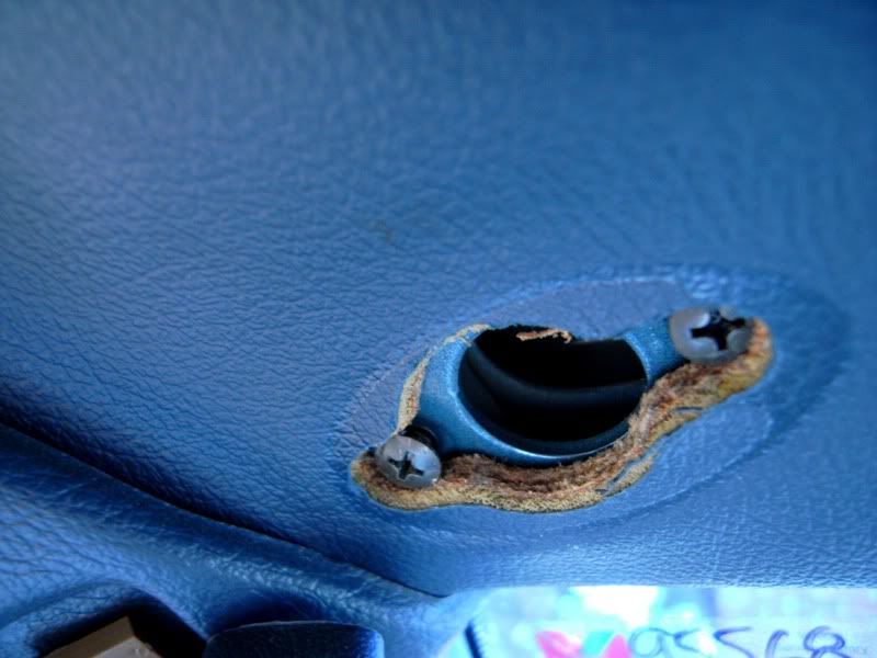

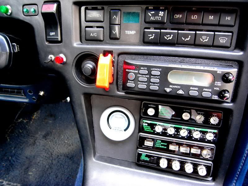

^^^ previously, the SBC's (Scramble Boost Controller) "REMOTE TRIGGER" (TRIG) button was just laying around "loosely" in the VOID next to my HKS "Tower of Power"...
...needed a proper home.

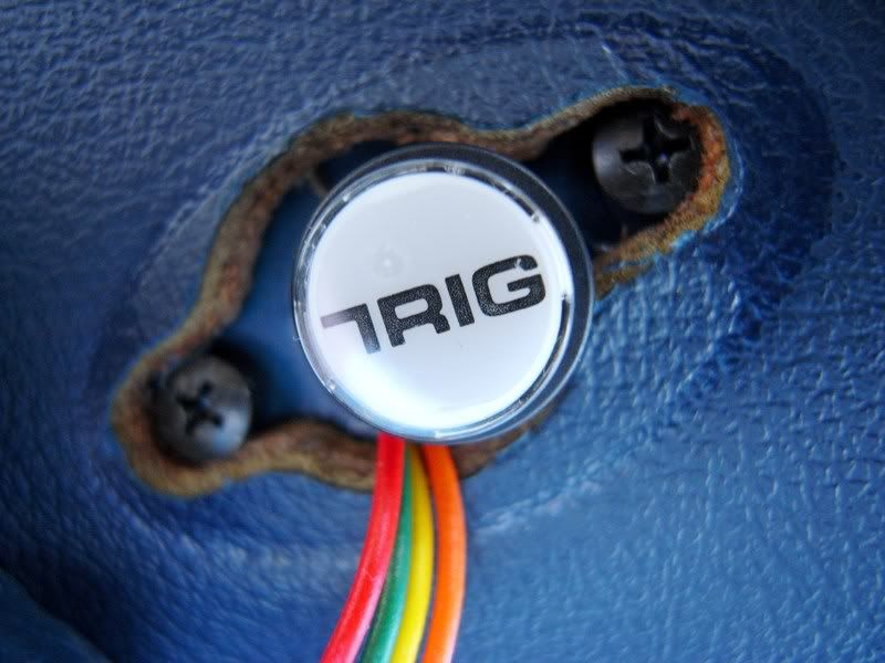

^^^ I selected a spot just above me in the driver side VISOR mount hole. My visor is removed, for clearance on the Valentine One and Panoramic mirror I use anyway...

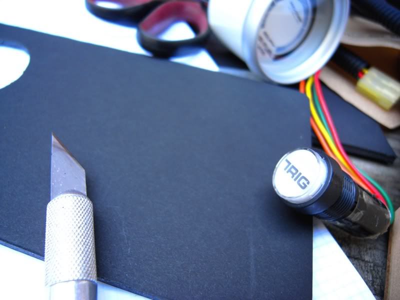

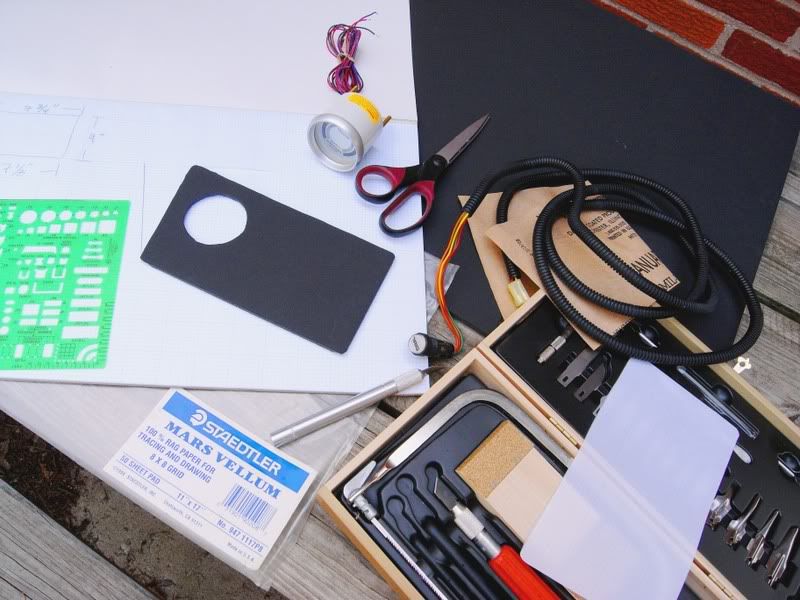

I also needed to improve on that "void"... so I chose to "template" a "temporary" fix and prepare it out of 3/16" art foamboard.

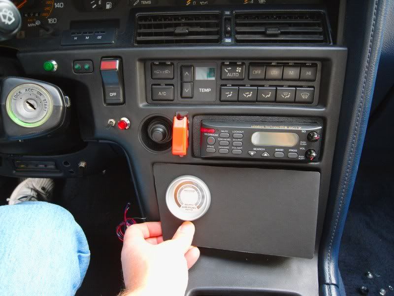

^^^ I know, the AutoMeter gage (narrowband...:nono: ) is JUST a temporary mount to put SOMETHING in there for now... I had it laying around.

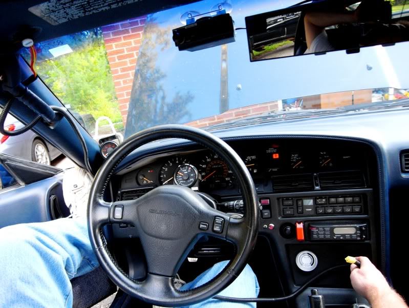

^^^ I make some trial "fits"...
...and perform a CRISPSCIENTIFIC ANALYSIS of whether or not the remote trigger has adequate lead-length for mounting in this location...:icon_surp
YES!!!
(...hmmmmmmmm... that mounting plastic stock looks EERILY similar to the interior trim of a burgundy supra...)

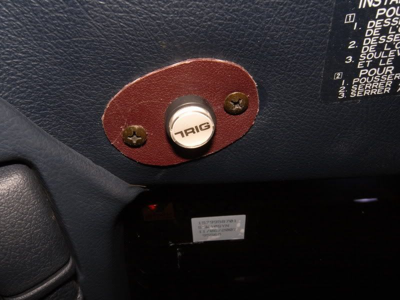

Did some cutting and test fitting...

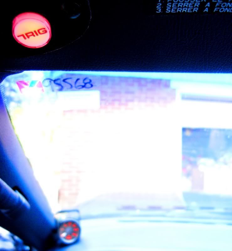

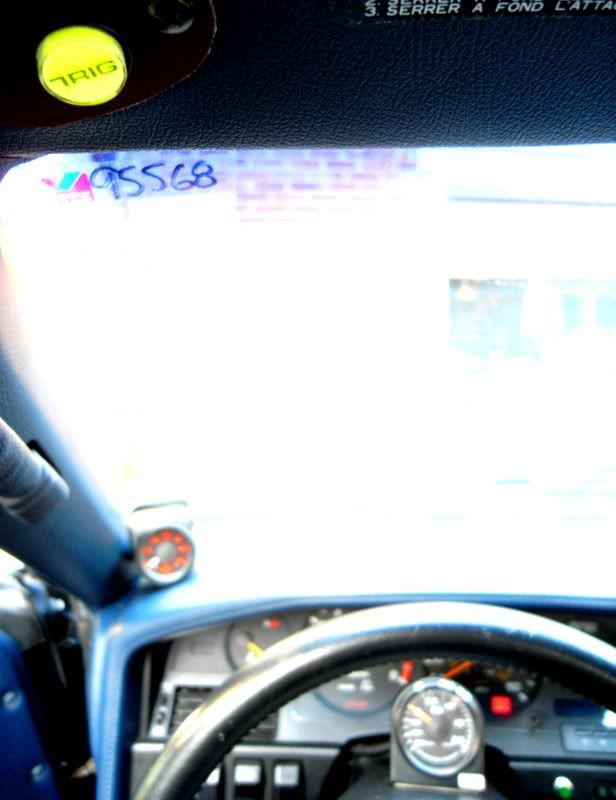

^^^ VIOLA!!! Easily "TAPPED" with your left hand without looking or making a large motion (from "hand-on-wheel) position... or even from the armrest... very "natural"...

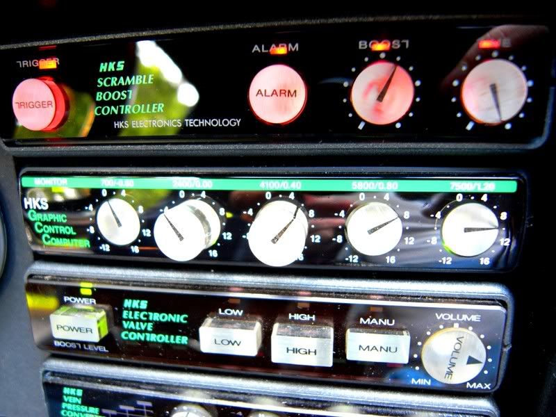

^^^ The REMOTE button "mimics" the function on the SBC unit, which is GREEN lighting as "default"...
...but upon pressing the TRIGGER (TRIG) button, converts to RED and an AUDIBLE RAPID "SOFT-BEEP" ALARM alerts for a "preset duration" (controlled by timer) to another "preset % OVERBOOST" that overrides the HKS EVC (Electronic Valve Controller) and manipulates the boost to an ELEVATED THRESHOLD until the alarm expires! NEETO! (In a "BATMOBILE/KNIGHT-RIDER/MILLENIUM FALCON" sort or way...:biglaugh: )
...the "TRIG" button also illuminates in unison.
