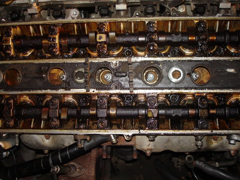

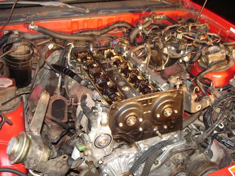

ok so i just finish the jdm motor install and drove it for two days with no problems and then what do you know blown HG. so im replacing the HG with a metal one. i havn't pick out a head gasket yet so if you guys have any imput on it let me know. i know im going to head studs and every thing else.
this is what i have done so far...

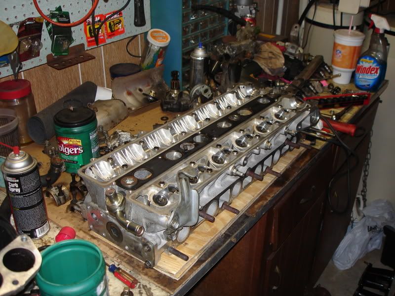

head ready to part with its sole mate.
kinda trashy...

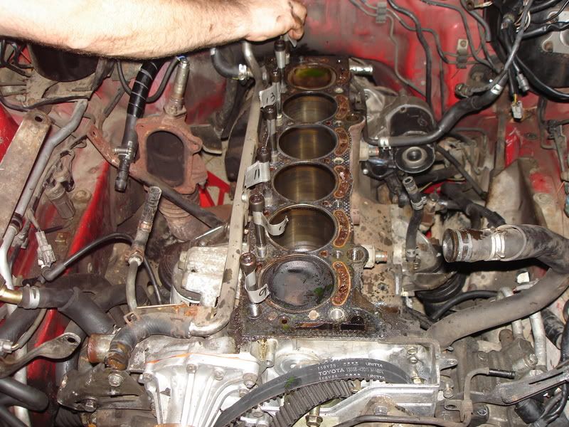

the block.
5 cyl power!!!
thats it for now..

I hope you know that in order to properly do a MHG and get it to seal correctly you MUST have the head lapped and I highly reccomend having the block decked and lapped to at least a 25RA finish. As for a MHG, Cometic all the way. They are not too expensive and are the most forgiving as to how they seal.

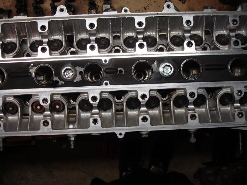

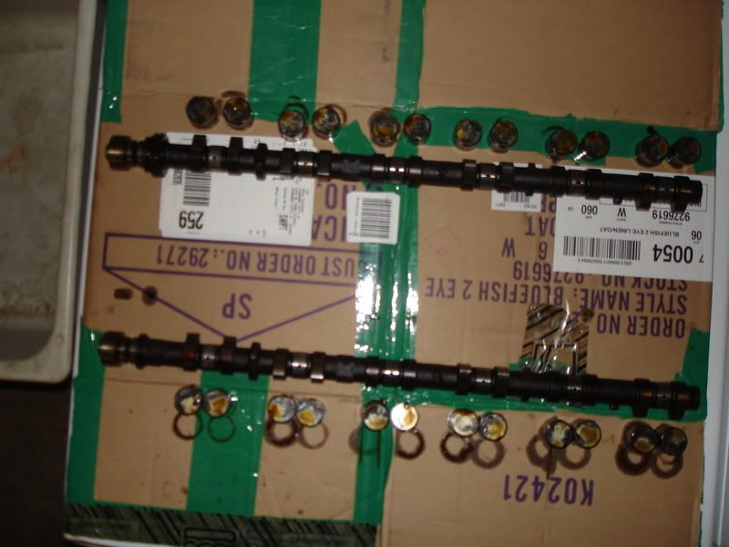

update.
head will be ready for the machine shop tommorrow. =)

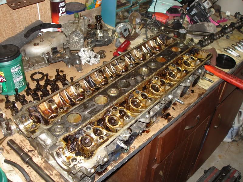

im kinda glad this HG blew, now i can get rid of all the sludge in my motor :icon_conf
anywho...pics.
the head....
being organized...

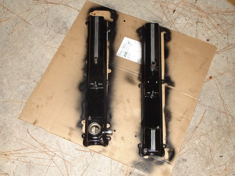

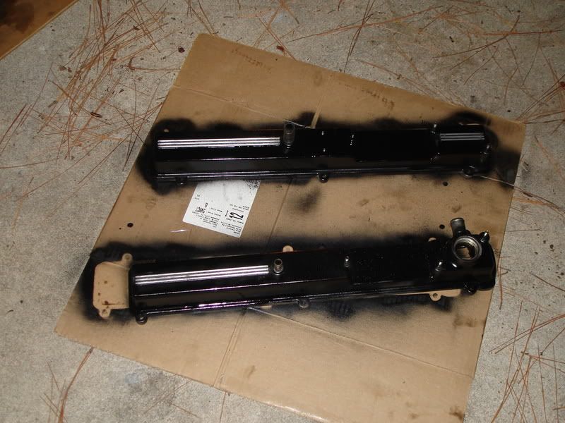

anywho thought i would paint up the valve covers nice and pretty..=)
its looks like trash but the paint is dry just gotta blow it off.
and again..

lack of oil changes
the motor it a JDM motor and who ever was driving it didn't seem to take care of it. so thats another reason you should stay away from JDM motors...

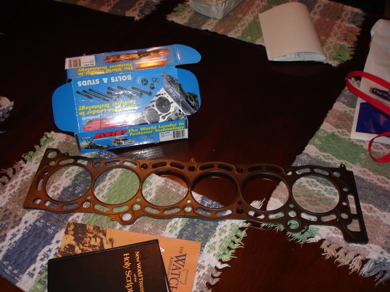

head back from shop and lookin good =)
price list.
head: cleaned and deck .020" - $35
titan 1.4mm gasket- 120
arp's-120
gasket set -150
+1 for HPF, they got it here fast!!
not so nasty anymore.
build for boost!!
