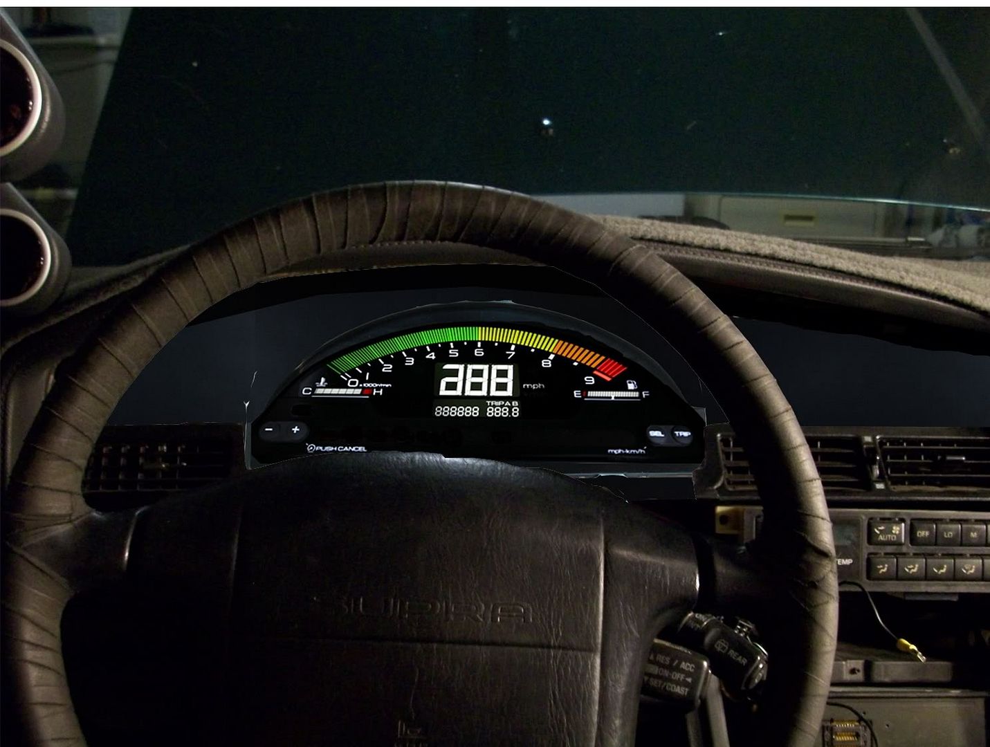

Quick update! Got both clusters and did my first mockup... looks like it will fit perfect dimension wise and I think it fits very well design wise. I'm glad I decided this route!

Just a rough cut for now... I got plenty o room to move it to the right...I'm going to put it in the dash to get.the final location then probably wind up making a fiberglass enclosure then carbon fiber to make it all pretty in front...

its not the outer part I'm so worried about. I had to cut the supra cluster to almost nothing.. I got nothing to support it or mount it to in the back. ill have to do some fg work or possibly some vacuum molding. then I got some cf I'm gonna cut with a waterjet for the face. some quick pics. wheel all the way up...
wheel down.
some more...
