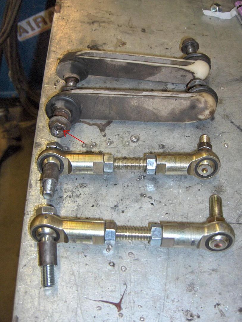

anybody have any trouble installing the rear sway bars? I am having trouble getting one of the bolts on, on the bracket. This is the rear passenger side. I cant get a socket of open end wrench on it because of where the bolt is located. the only way that i see i can do it, is by dropping the gas tank. anybody have any tips on doing this? Any ran into the same problem?

I am also having some problems with the endlinks, when u try to loosen the nut on the endlinks, the whole endlink turns along with the nut. Usually there should be like a spot to put a wrench on so it shouldnt turn. I am thinking about using vise grips to grap it in the center, but it will damage the boots on the endlinks. do u have any tips on getting the nut on the endlinks.

On the end links its actually and allen head screw you put the wrench on and then you hold the it from turning using an allen key its probably covered in road grime so you cant see it. Heres a pic
