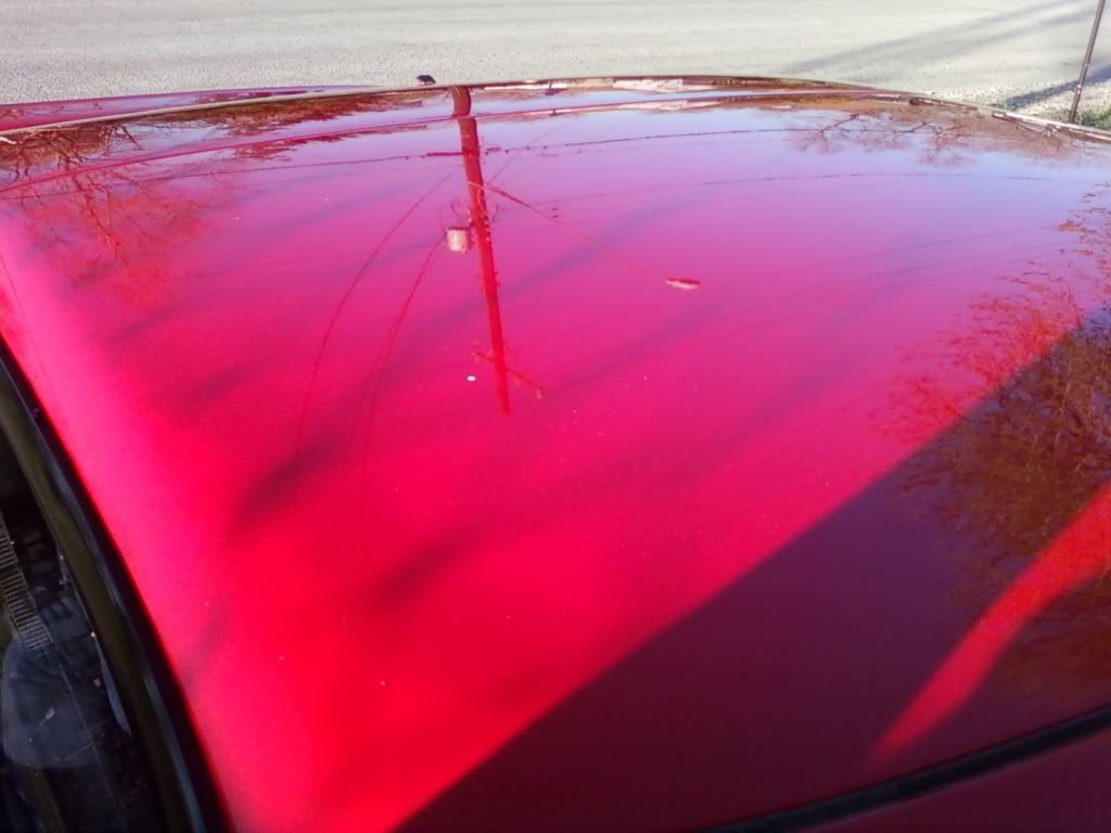

OK here's the story I pick this car up for $800 Not running. Found out that it had a BHG of course. Planed on fixing it and selling it to turn a profit, but I ended up liking it too much to let go. So I will be selling my 1JZ and slowly building this one up. The interior is in great condition. body is in good condition Paint on top looks a little faded but should be nothing a good buff can't bring back, And a little dint on the left of the drivers side tail light Other than that it's straight. I scored some great looking saw blades from JDMMA70.

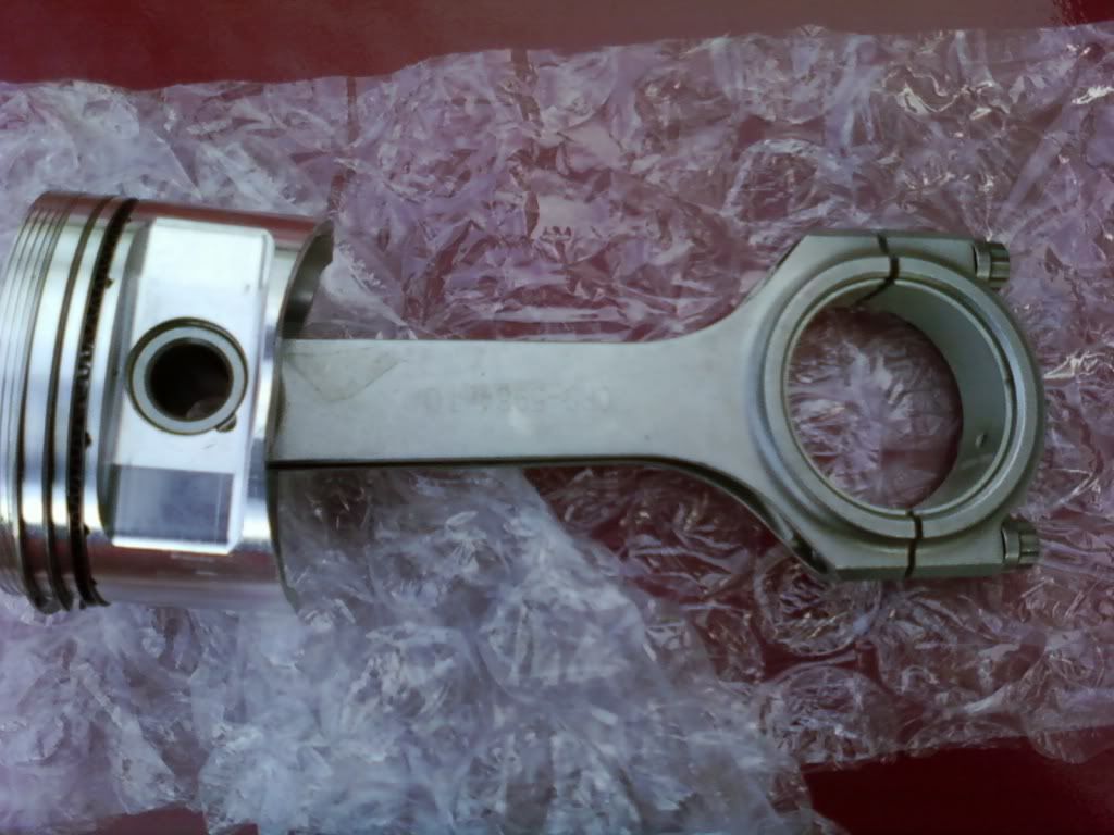

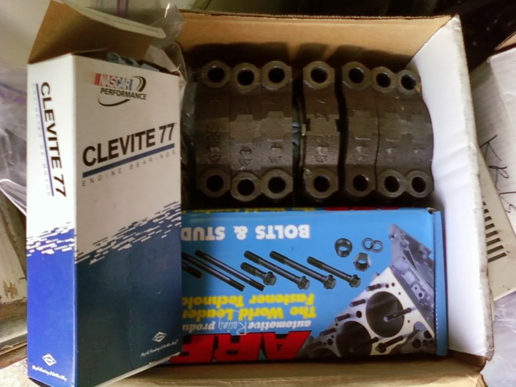

I want to keep it looking stock. The engine will have Je pistons, eagle rods, Gates water pump, timing belt, Clevite, and arp all the way around. I will be sending it to the machine shop for them to assemble and also have them do my head work(port and polish). I hope to have it all together with in a month. I will add mods later that will be the slow part of my build. And now for the pics

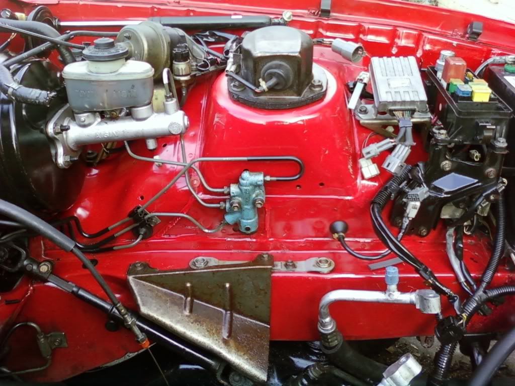

Some work I did today.

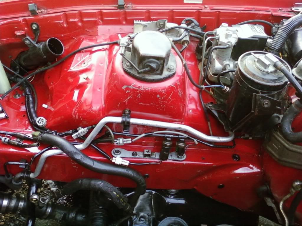

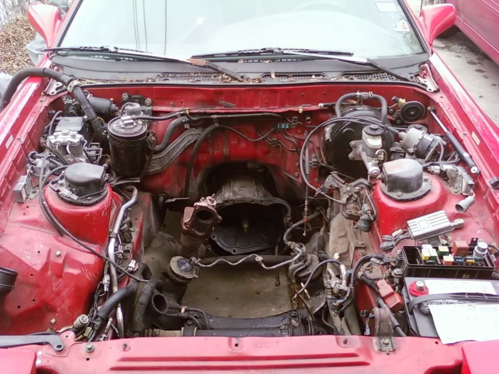

Before shot
Cleaned up the old engine bay. I plan on painting and wet sanding the scratches to make it look a little nicer

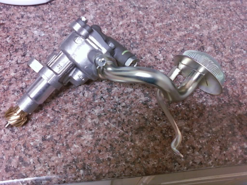

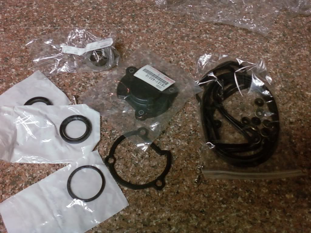

And the goodies going into that engine bay

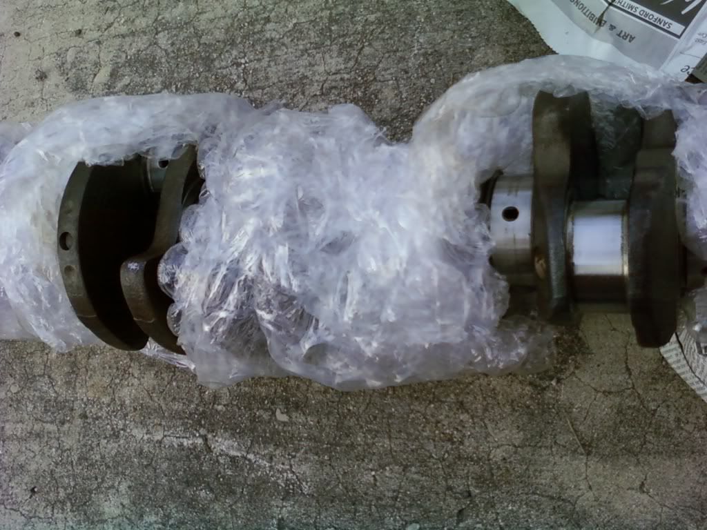

JDMMA70;1492790 said:
the crankshaft was machined? you assembling the motor yourself?
Yes and no. I'm gonna take it to a machine shop here. I don't trust myself. So I'll have them put it together and also port and polish, resurface and pressure test my head.

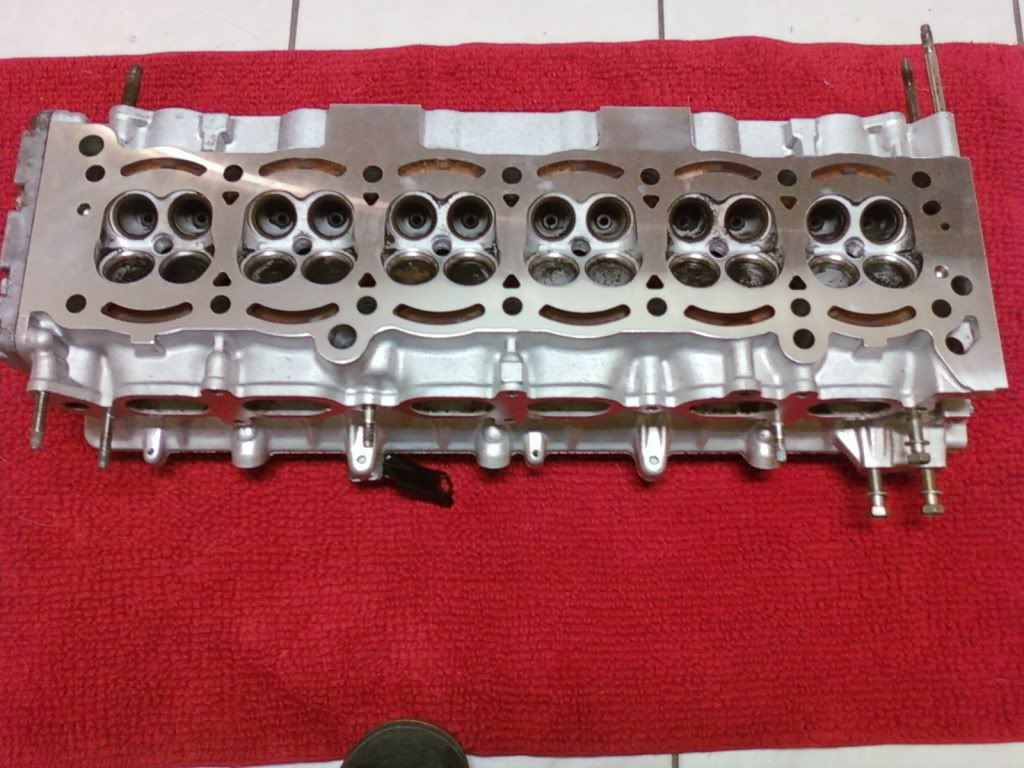

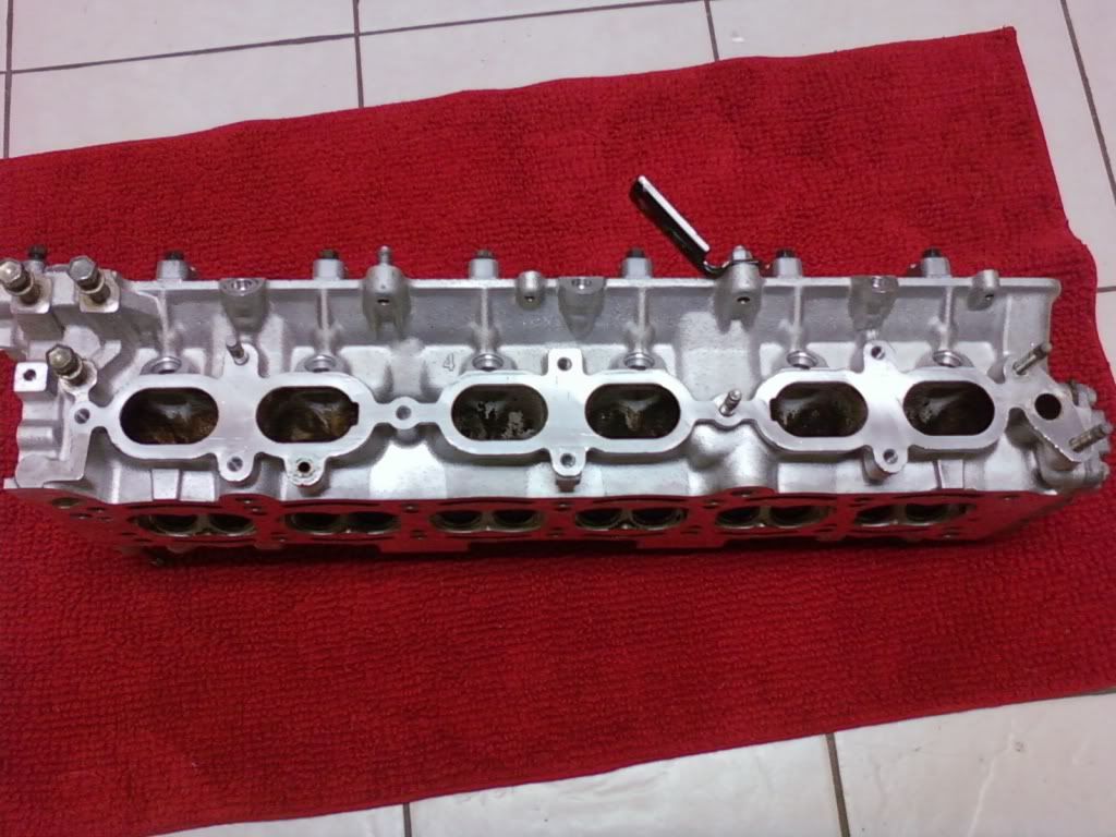

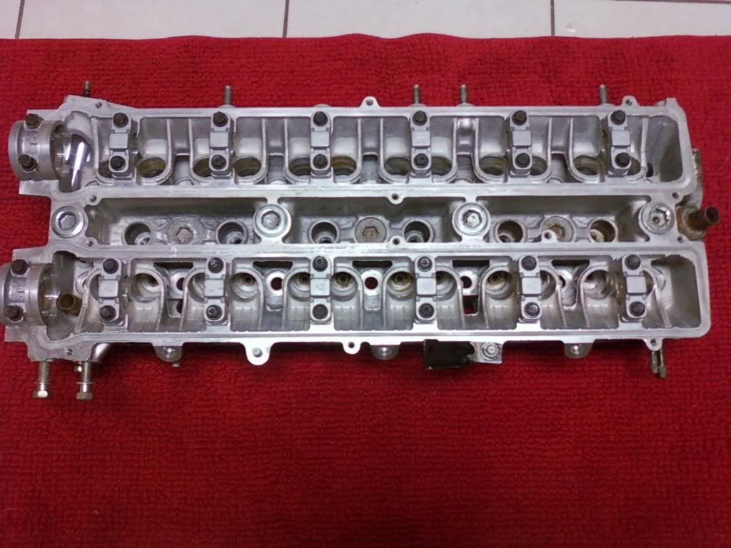

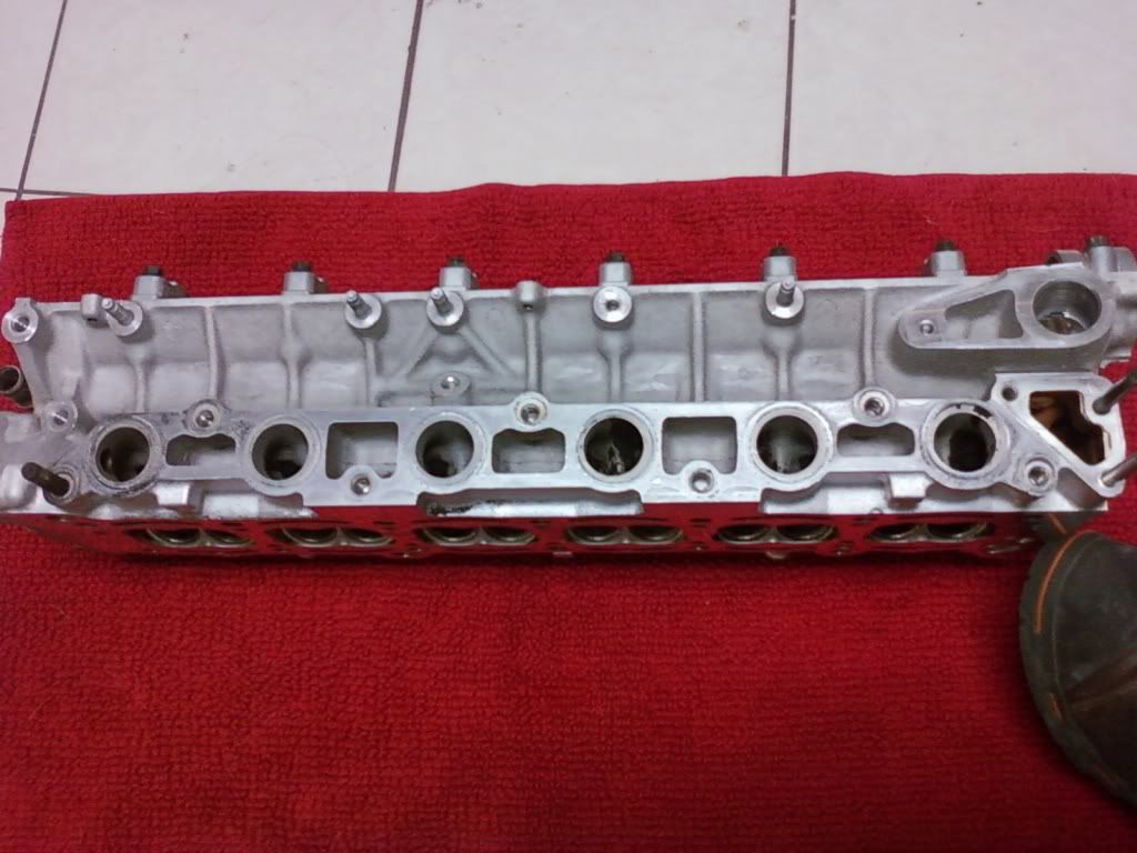

Status update: Block still at the shop getting put together. Took my head to the shop, they said it was a P.O.S. I went to the junk yard and saw a n/a with what looked like a nice shinny head. So I pulled it, all the gaskets around it looked new. I guess it was a failed head gasket job. Bought it for $70, I took it home and striped it down .Took it to the shop first thing they asked is were "were did you get it from" Told them the junk yard. He was really surprised . They pressure tested it and shaved it flat. It was barely warped. I'm waiting on My gasket set and oil pump. Things are coming together, just not as fast as I would like. Want to get this thing done by TX2K10.

fonz87
89 Turbo!!!!
Nov 17, 2007
642
Streamwood, IL

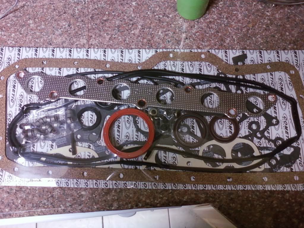

are those ebay gaskets set ? just wondering, i m thinking about buy it for motor but not planning on using the HG and the oil pan.
S.A. supra
Feb 15, 2009
2,405
Buda, Texas
Yeah It doesn't come with a hg Gonna go with a hks stopper. Not planning on using the oil pan gasket. Plan on using some sealant for the oil pan forgot what my buddy uses but it works real good almost too good if you plan on ever taking the oil pan off. I did get it off of ebay, for like $130. I plan on putting it together with in the month I'll let you know how it goes. I'll be the guinea pig.

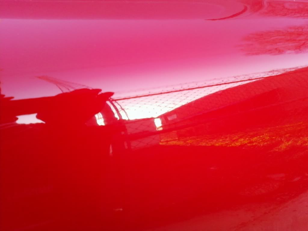

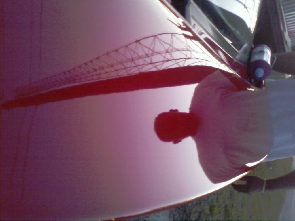

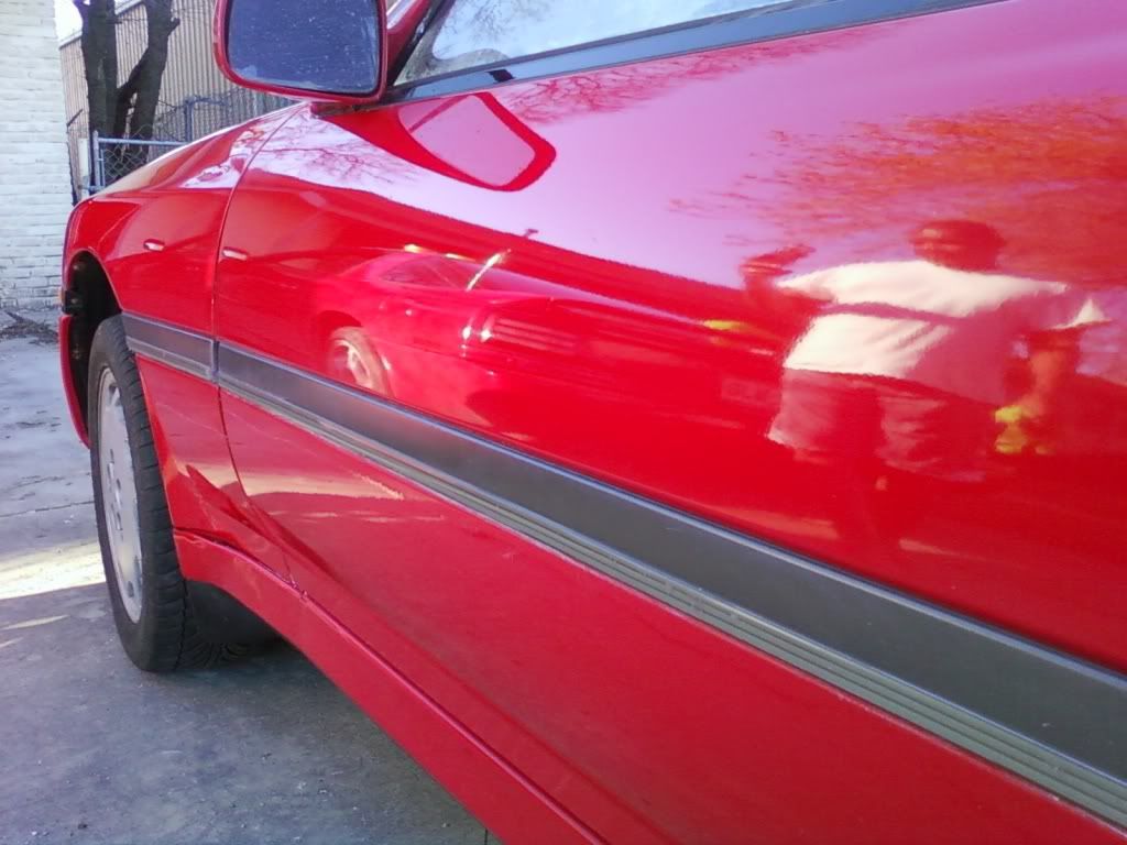

Well since I haven't gottin my block back yet, My bro in law and I started on her apperance.
[/COLOR]Before pic of pass door.
After pic
Other pics, we didn't get pics of it when we finished because it got dark. So no pics of It waxed. But it looks pretty damn good. I'm happy.

I agree, use a good bead of silicone on the oil pan. Even the gasket set that Saftey Gaskets and DriftMotion sells comes with a oil pan gasket. I use a bead of silicone on every gasket except on the exhaust manifold.
